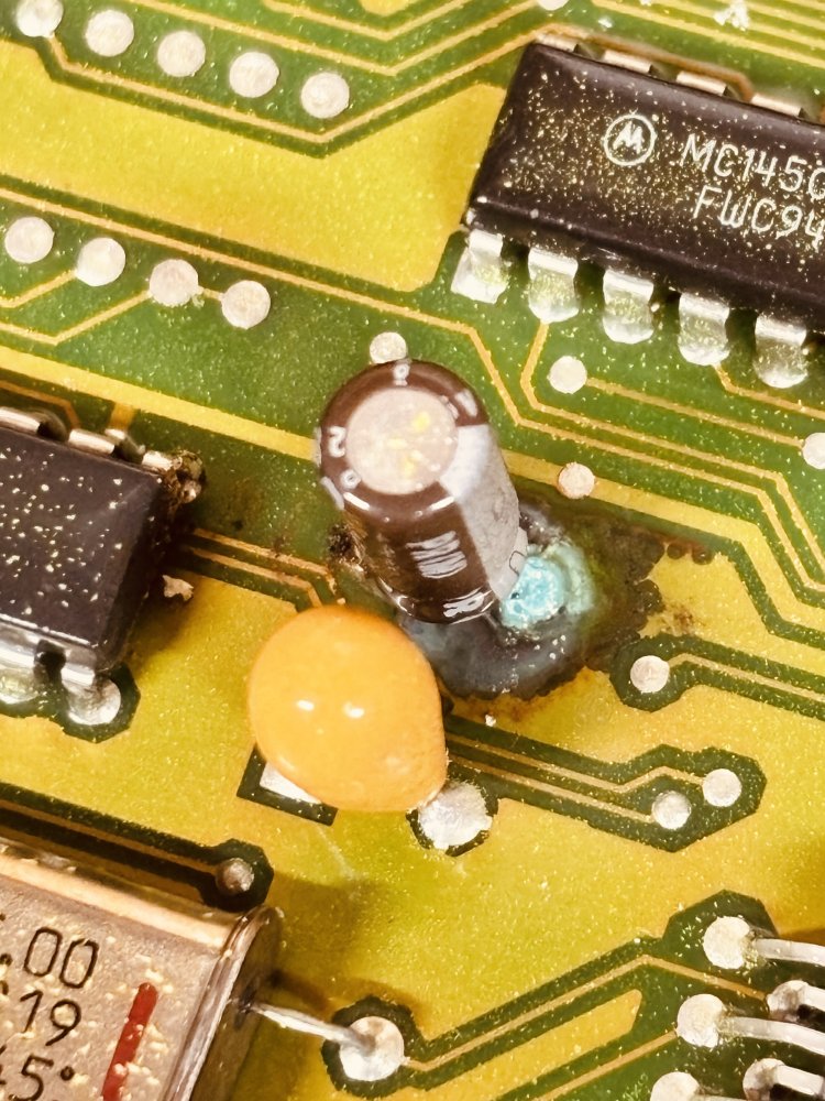

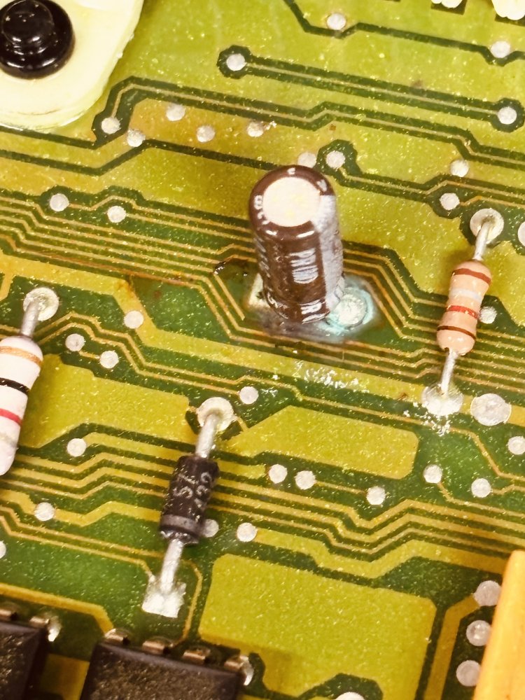

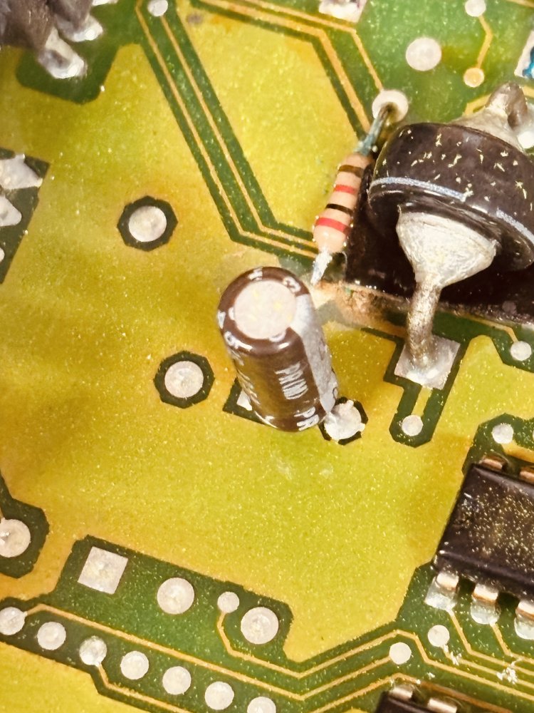

Time to replace those capacitors. Either theybare bad or the solder joints are loose and corroded.
That's definitely a leak. The electrolyte has eaten into the board. It should still be salvageable.
I will give it a shot. I think I can source them locally but I am not confident in my ability to change them out.
Watch some youtube videos. Capacitors are among the easiest things to replace because they only have 2 pins. Make sure you orient the replacements correctly. It makes it much easier to clip the pins on the old capacitor. Then you can remove one leg at a time. A second set of hands can also be helpful. Have them pull the part while you heat from the other side. If you made it this far, you can handle some soldering. Just make sure you use electrical solder not plumbing.
Worst case scenario, replacements are available. Rockauto has a selection of Cardone parts for about $130+Core.
Thanks for the advice! Will see how it goes next week when I can get the new ones.
Write down or image the capacitor values, note their polarity, and then "deconstruct" the caps to leave the longest remaining pin legs.
Clip hemostats on a pin leg at a time, and turn the Printed Circuit Board upside down. From the top, heat the solder to its melt point with an iron; applying a little flux will help.
As soon as the pin leg drops out, lightly tap the PCB on your work surface. The hemos will pull the pin out, and the tap will usually clear the PCB pass-thru of solder. If not, reheat the pass-thru with fresh stranded copper wire on it and the wire will draw the melted solder out.
The trick is to heat the PCB quickly to the solder melt point, and no more. Not being quick and you'll burn the PCB.
Make sure that your new caps are the same value, and make sure that the polarity matches the originals.
It might seem like rocket surgery, but it's not hard at all.

UPDATE! It worked!! Picked up 3 caps from a local store and had a friend help replace them, and now the truck starts up right away! I needed a win on this one. Thanks to everyone for the help. I don't understand how this was the problem, but I am not complaining.
Happy for your success. The explanation isn't simple. Just believe in the magic of electricity.
