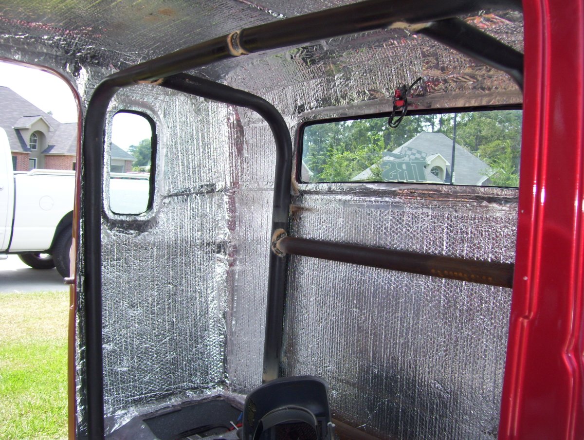

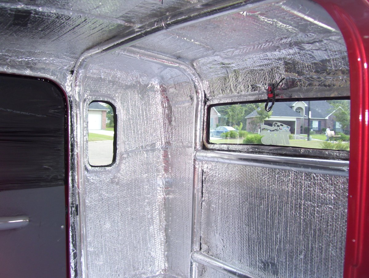

Note to me: add 2" thick soundproofing through-out cab before installing inner walls.....check

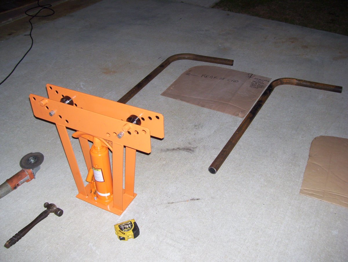

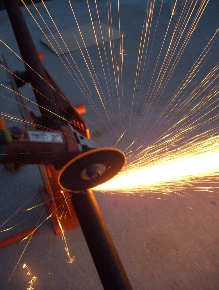

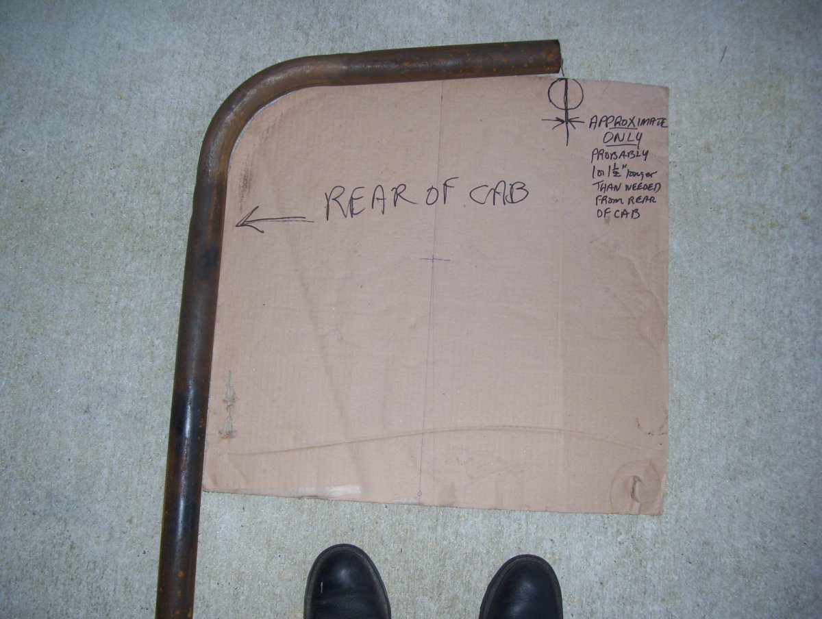

Doing some bends for the back of cab to fit on each side of rear window (red-neck bender needs to be mounted on a work bench now that I know it'll bend .200" wall pipe:

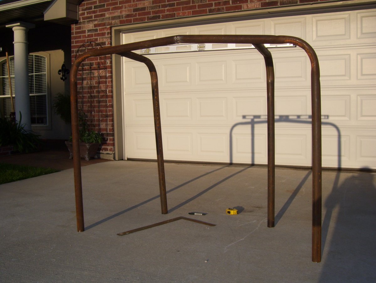

Now to lift the roll cage until it touched the insulation and clamp it into place while i weld the frame braces in place. The rear cross-bar should fit right under the rear window.....
Tacked a few pieces together to see if I'm headed in the right direction.
