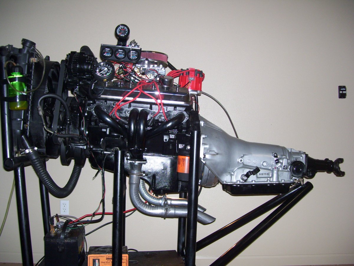

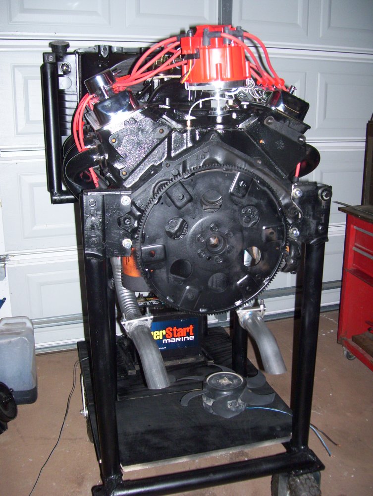

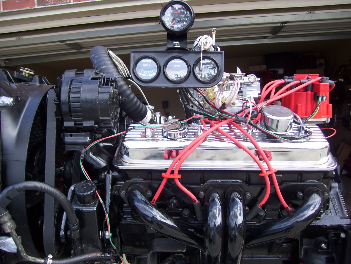

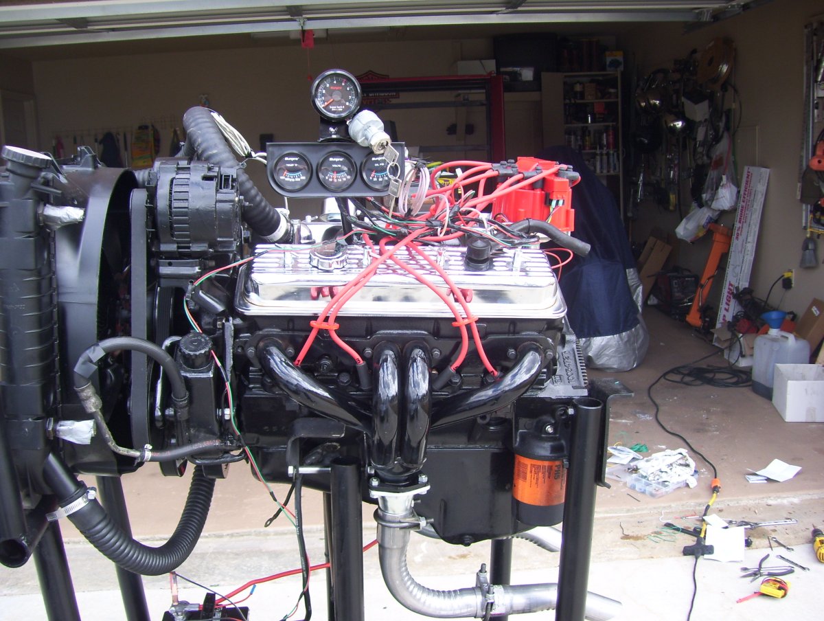

More engine pic's.......I just finished bolting the sbc engine to Redneck dyno :icon_rofl:
Gotta mount guages on test stand, add carb to intake, rad hoses, accessories......

I'm gonna try cranking the spare engine this week-end and run it a few times to check for leaks, etc. If alls O.K., I'll bolt on the auto-xmsn & leak-test it.

Update----the 350 cranked up & runs great......click on the video below......

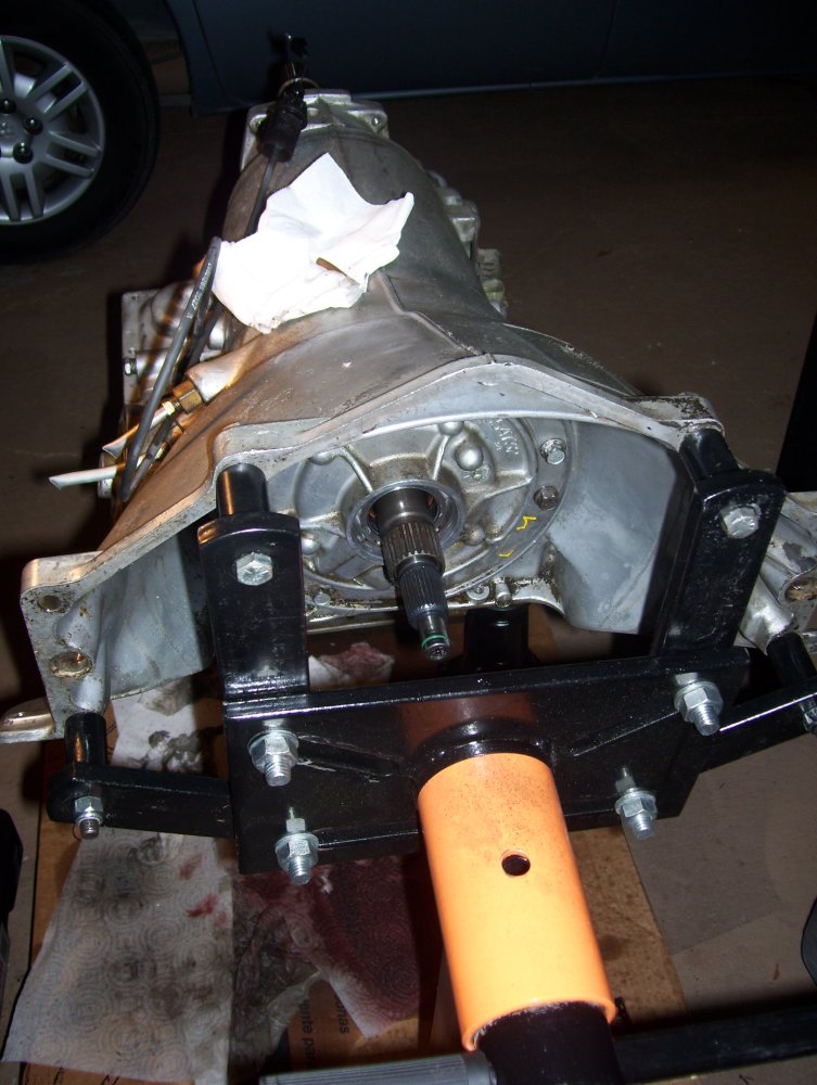

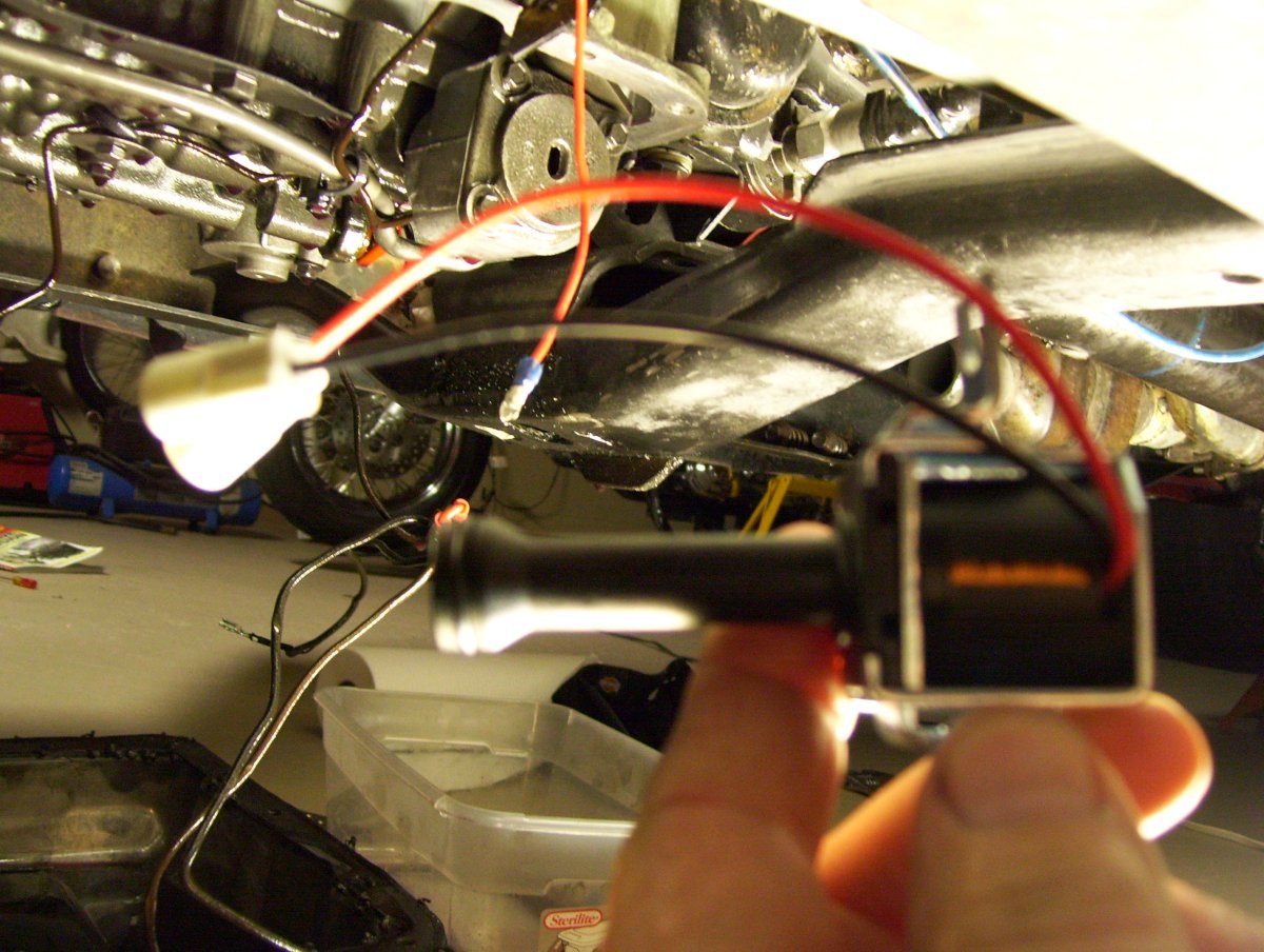

Found the xmsn--cleaning the inside & hot-wiring the lock-out torque converter so it will engage in "over-drive" & will dis-engage when in passing gear:

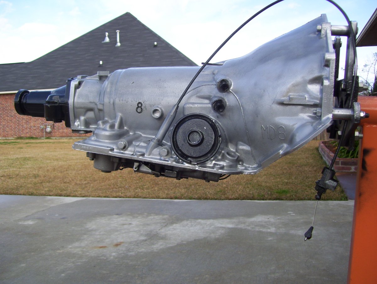

Cleaned the case up:

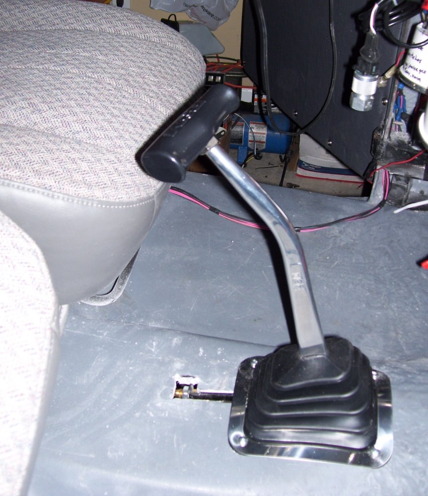

EDIT: Forgot to throw in a pic of shifter:

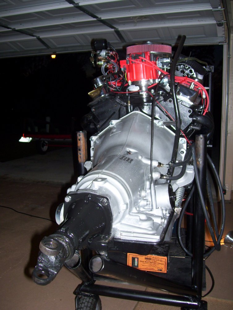

Finally got 700R4 bolted on & taken for a 30 minute "spin around the block".
Temp. ran at a constant 185 degrees while taking xmsn thru the gears to work all the air out of the guts.
Connected high pressure rubber hoses from the xmsn to the Ranger radiator & cooled everything with stock belt-driven fan.
Gonna remove belt-fan & install electric fan from bone yard once everythings bolted into Ranger Chassis.
