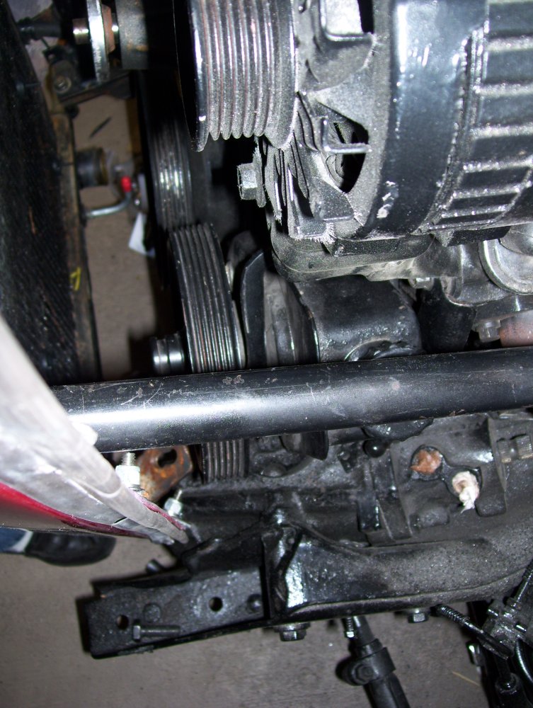

thanks men.......I goofed around with the modified alternator bracket today to get back into the groove.....LOL.....I got the bracket shimmed & the belt lined up ......see what I mean (VA drugs).......the pulleys all in line for the new alternator belt....
Everything looked good from underneath.....it's easier to get to the engine/bracket/bolts on a '36 from underneath......problem ws...I had the alt. bracket on up-side down
O.K......I' wait til everybody gets thru laffing.............
That's enough!!!!!!
I finally got everything pointed in the right direction an hour&59 min. later....

The eigt...eif...eight...8th time is a snap on the alt. belt.....did I mention that the '36 grill is tapered 24" narrowereerrr than the '89 grill????
So when I moved the body back an 1&1/4" to get the tires centered in the wheel wells......it left no adjustment in the alternator (fix one thang....re-fit to...2... other thangs!)......
sooooooo....I pulled the assy out/undid/modofied/redid it so the slack can be taken out of the alternator belt......

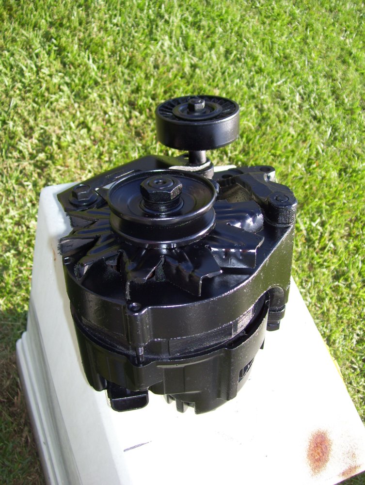

Let's see what pic loads first....hmmm....I gotta round off those fan blades (they were an inch too long/had to snip em in place....talk about a noise when the 2.9 first fired up b4 I noticed the problem!!!!!!!!!!!!!!!!!!))
Jest enough room for the alt..........

Hi tech/cut/drilled/flipped/idler-added alternator assembly thang......

The paint oughta be dry by now ...... let me go sl-i-i-i-i-de it into place.......
