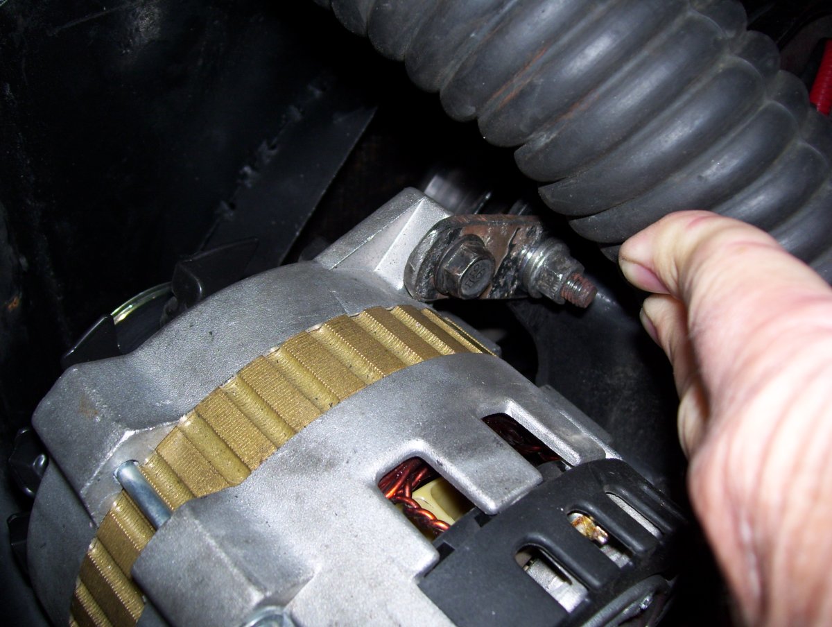

I finally managed to get something done....it was about a 30 minute project:
Take the tension off the drive belt.....
Remove the alternator wiring harness.......
Remove 3 bolts including a rear alternator brace....
Pull out the "old" alternator.....
Drop in the new 160 amp alternator. & bolt it in place...
Re-install the drive belt....
Re-connect the wiring harness....
Fire the truck up....
Turn on the A/C....the headlights....the radiator cooling fans....the 12 volt air pump....raise & lower the windows a few times also....
The volt-gauge didn't even twitch! (normally it would drop to about 12.5 volts)
Nowwwwwww....I'll have a hot battery all the time (no more headlight flaring or s-l-o-w electric windows)

I drove the Ranger last night.....
Lights........heater.......cooling fans in traffic....the new alternator is doing great.....
You know how the engine rpm drops a little when the A/C is turned on....WELL...when my cooling fans came on--the 130 amp alternator would cause the rpm to drop a little because it must have been maxxed out for a few seconds.
I was even able to idle down the engine with the new alternator and it still puts out 14 Volts !!!!!
I drove the Ranger about an hour again today......to my oldest daughter's house to check on her in the next town.
the 160 is working gooooooooooooooood!!!
