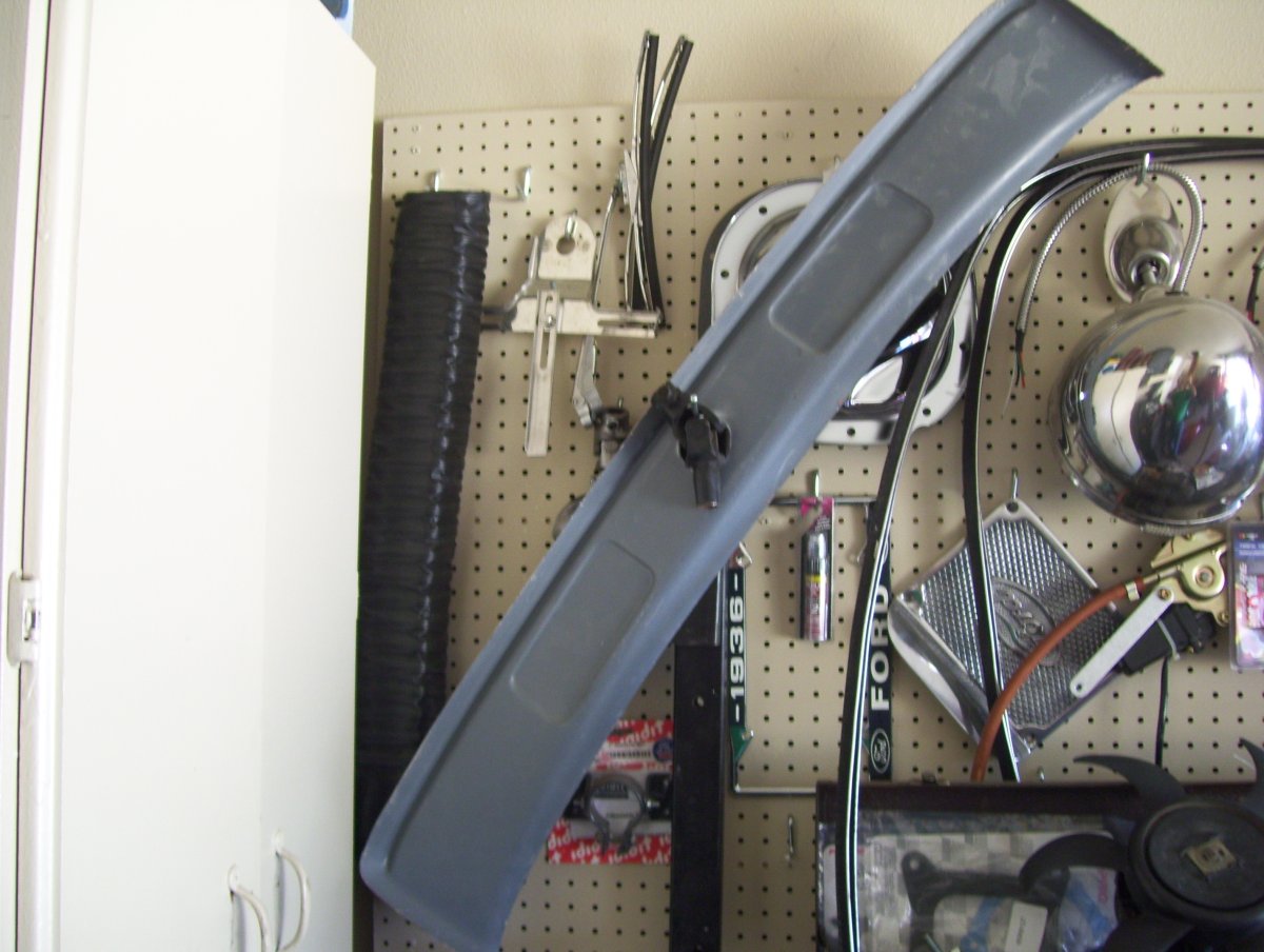

I HAVE been whittling on the fiberglass backing for the headliner some more...when I got ready to install the upper windshield molding--I didn't have enough rivet-nuts to complete the task and had to order more R-nuts....
Here's a pic of the overhead molding patiently waiting for 6 years to get installed....
