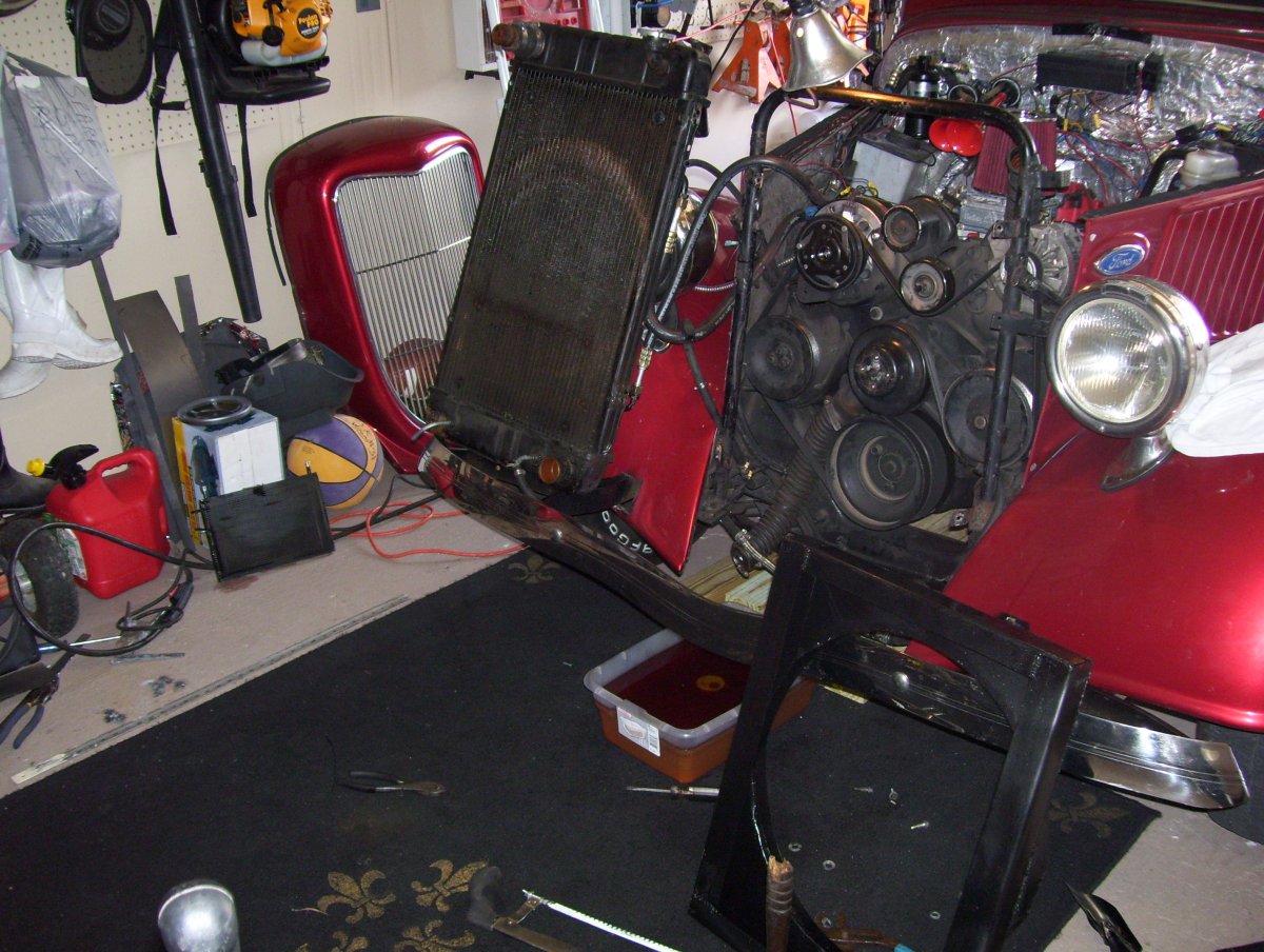

PiCs....................raised the hood(s).........30 seconds
removed the G-G-G-G-Grill........10 minutes
removed the A/C condenser & radiator & trans-cooler............20 minutes

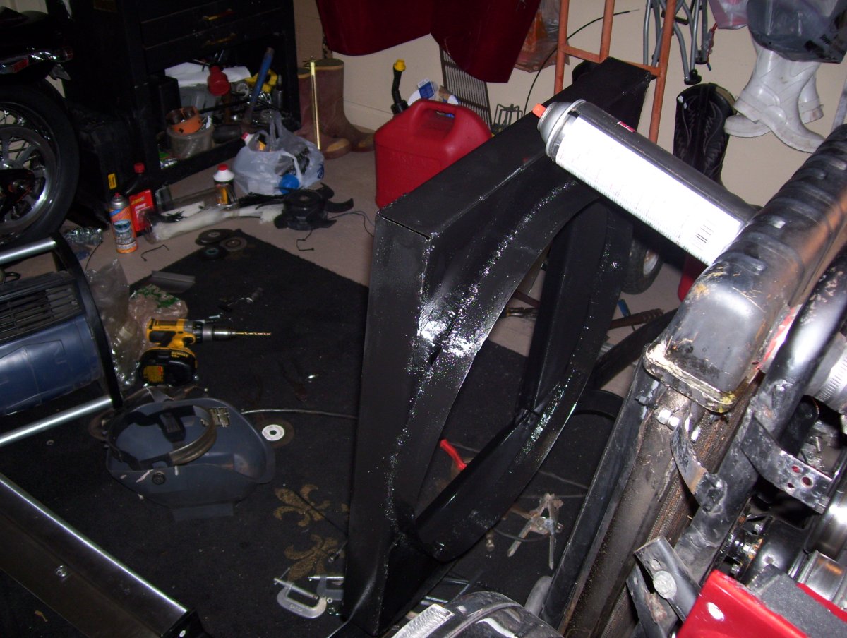

Friday.....went to the pik a part & found a fine elctric dual fan set=up with shroud for the radiator.....
forgt to measure the lenth (don't need no stinking "g" in that word) of the radiator!!!!!!!!
the dual set-upis the EXACT width I needed......
but it's 7" toooooooooo longgggggggggggg....
gotta go exchange it Monday....
RATTTTTTTTTTTTTTTTTTTTTTTTTTTTS
I was gonna hve it back together this weekend....
I'm so upset.....I think I'll have a sammich & a med..................
:icon_bounceblue:
i think i'll go take a pic of the fine dual fan set-up b4 i return it though....

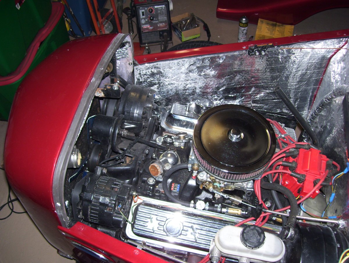

took the Ranger for a 120 mile spin to check out the radiator repair/eeeelectric fan install......
it ran cool as could be.....the 180* temp switch from Jegs worked just right--Fan On at 180* at traffic lights--Fan Off at 170* between lights :yahoo:
the only drip came from the old lower radiator hose where it connects to the radiator...I picked up a new hose on the way home :yahoo:
EDIT: Man.......that engine bay is quiet without that mechanical fan roaring....I can hear the carb pulling air thru that dual-inlet air cleaner and the exhaust popping at idle.....the electric fan only comes on at long traffic lights in 85* temp!!!!
