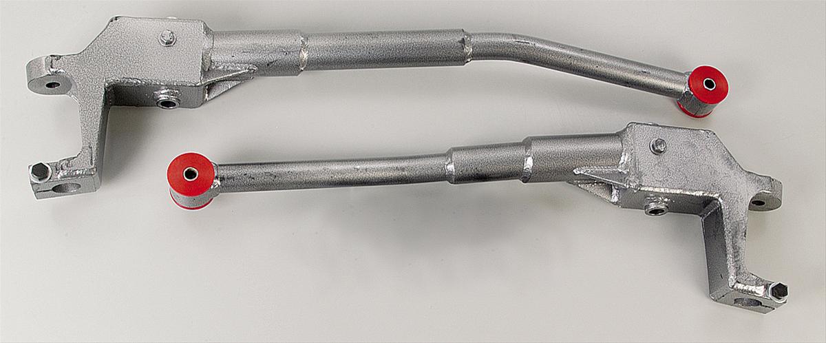

I had to get a pic off the internet......

Allright....I managed to take everything outta the boxes just to see how purdy it all looked.....
O.K. They're in the truck...just like you axed for...any comments???? (waaaaahahahhahahahahaaaa)
