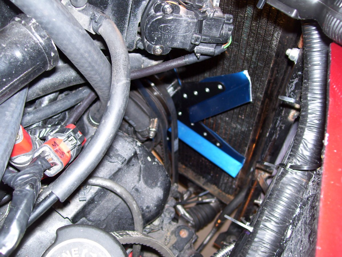

her's some pics...notice how I modified the length of each radiator bracket to get the radiator the right distance from the fan/drilled new holes in the radiator side-braces for up&down adjustment...
the other 2 brackets were also modified as necessary to get the radiator square & spaced correctly......

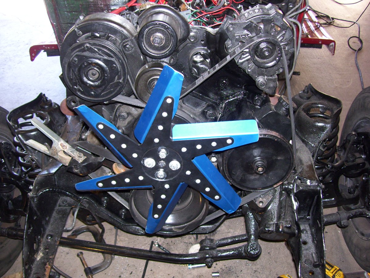

pic of the fan with 3/4" clearance from radiator....I also shortened the fan blade to clear the main radiator support....

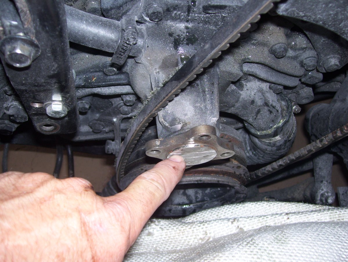

Note: I also had to do away with the fan clutch & use a direct drive adapter to connect fan to water pump to help with clearance problems (one day I may install hi-flow electric fan aquired from bone-yard)
