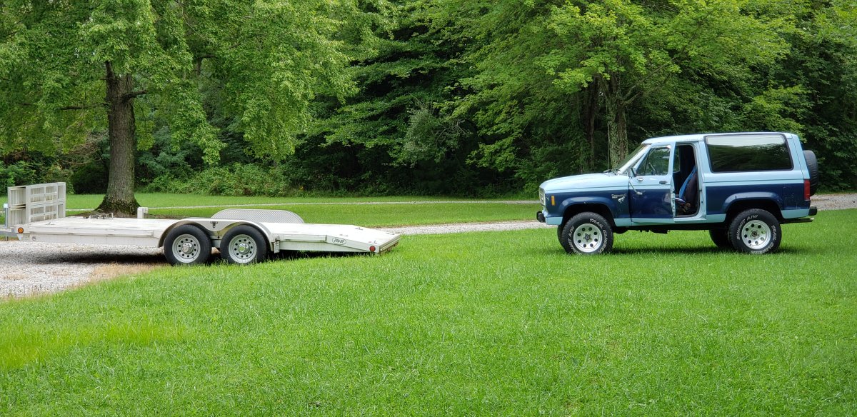

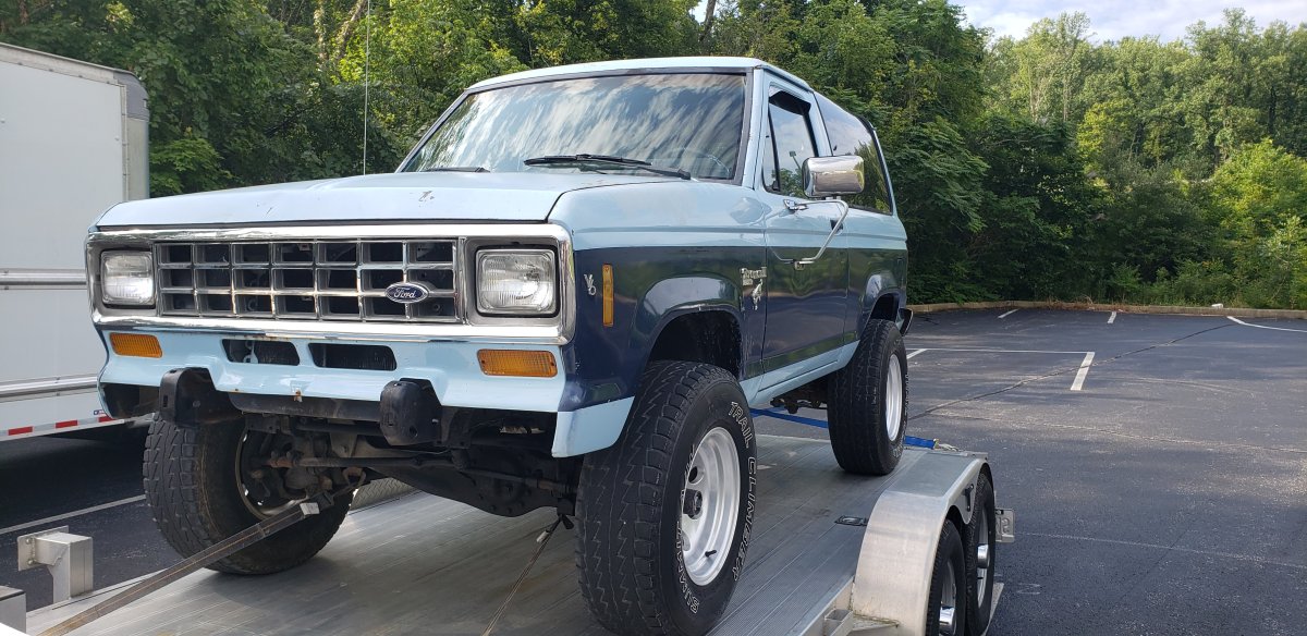

I would like to insert some foreshadowing and point out in this pic the Bronco had popped out of gear and unloaded itself while my back was turned. Had no parking brake at the time and I didn't double check the trans after hauling it 400 miles home before popping the straps loose. Learning experience without paying the price... I'll take it. This is an example of crap that happens when working on this but one of the few that didn't $$$. As of this post we are getting along better.
Anyway. This is my incredibly blue 1986 BII still rocking the 2.9 and a swapped in FM145 (I didn't know that until I got there). Obviously this is how I got it. I've always loved/driven Rangers so BII's have always been cool in my book but this blue bastard called to me. This was August 18th 2020 before the price hike so I got it at a fair deal. $500 less would've been a bit more to my liking but, like I said, it spoke to me. I probably should've realized at the time it was cursing at me. I still love it. It's got duals on it with some sorta of glasspacks so, yep, its loud and slow. I think it had ~135K on it at this point. I supposed it could be 235K but I think it runs too good. It's the quiest 2.9 I've had so far (4).

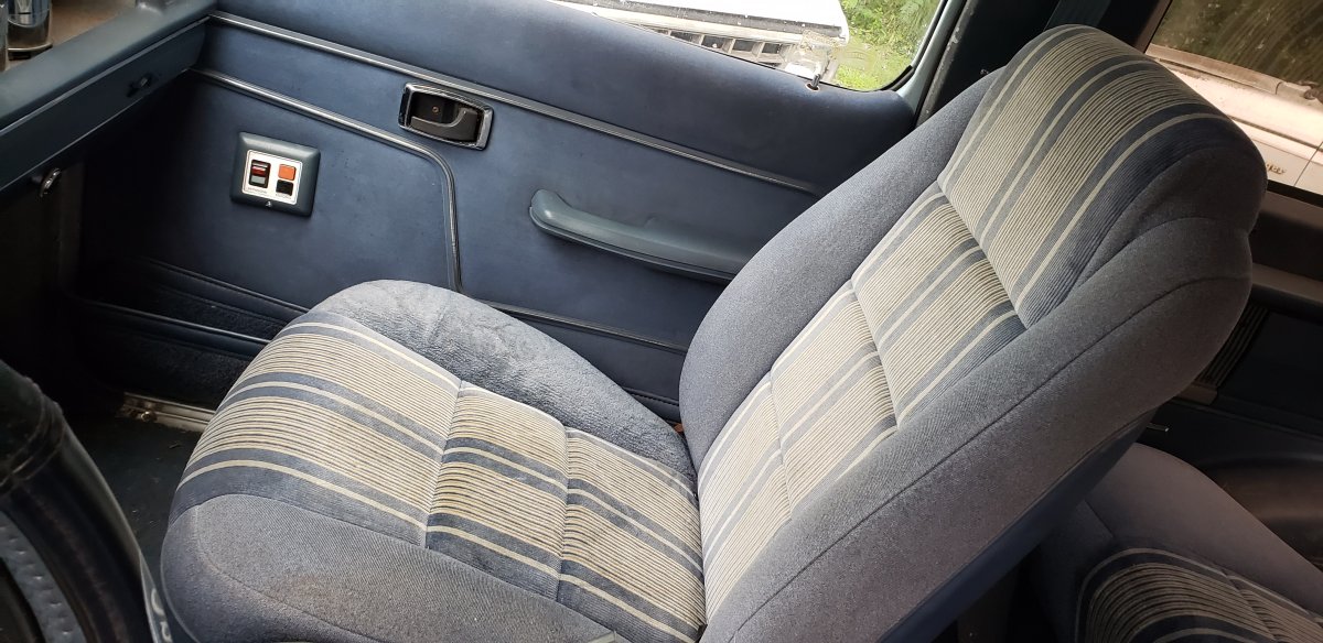

The first thing I did was replaced all the gas struts for the rear hatch and glass. As far as what I got when I got it home, it really wasn't bad. The interior was 4/10. Driver's seat is shredded, headliner is sagging, door panels are warped a little and the plastics are faded/scratched in the back. All stuff that can be fixed. It ran good, shifted fine, and stopped. Pretty much everything works except the a/c. low washer fluid sensor and front speakers. Oh and someone removed the power door lock actuators from the front doors. Not sure why... The body is pretty solid, some rust staining on the bottom door seams and surface rust. [to be fair I found the rust later]. Overall the thing was 97% complete.

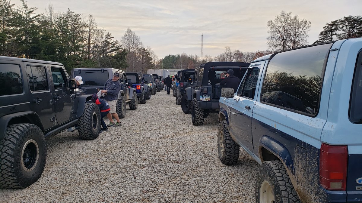

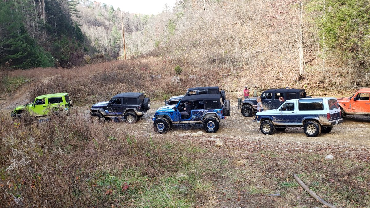

To totally blow the timeline (not sure that matters either way) this past weekend I took the Bronco down to Hollerwood in Slade, KY for the Ohio River Four Wheeler's Meet and Greet ride. It's still on 31's but now has the Duff stage II 3" lift on it. It did very well. Limiting factor being tire size. I got tugged out twice. Once I was trying to climb a rock ledge and just couldn't get the rear to come up. We were on a time limit so we give it a gentle tug and I was up. Second I high-centered in a rut; also didn't take much to get me moving. I was surprised on many occasions when we'd turn, start climbing a hill and the bronco just went up it. Lots of fun was had. The only casualty was the passenger side Bronco II badge broke and part fell off when I was power washing it.
Cool pics. Even mixed in with the newer, higher-dollar rigs, that B2 is a class act. Nice one!

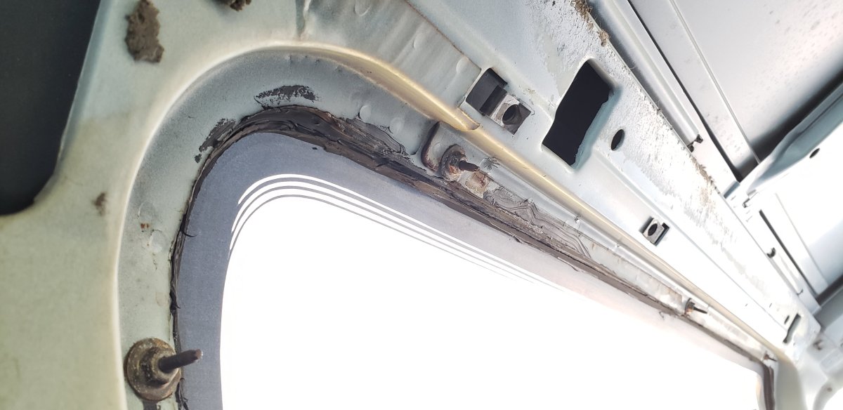

The very first and most painful problem I encountered was... It leaks. The entire rear cargo area was wet along with both front floor pans. The P/O must've stored this thing in the garage or something. If it leaked this bad every time it rains there would be no truck left. So I ended up pulling the rear windows (thanks to guidance here at the RS), cleaning the old gunk off, repainting all mating surfaces since I scratched the hell out of them and having the rear windows re-installed. Could have sworn I had pics of the area after it was cleaned and painted but I can't find them. Oh well.
At the same time I had the windshield and both door windows replaced. WOW what a difference clear glass makes! I ended up replacing the door seals as well. It's mostly dry now. I think the cowl drains are plugged so I still need to look into that. I try to keep it out of the rain when it's just sitting here. I wasn't sure what sealed the rear hatch where it bolts down. I ended up cutting some rubber pads and using seam sealer to stop that from leaking. I thought I was being super slick with it but I somehow got the alignment off (we checked it so many times) so now the hatch is hard to open and get latched. Crap, now its almost glued in place. At least I have the rear glass that opens so I just don't open the hatch unless I'm taking dogs with me.

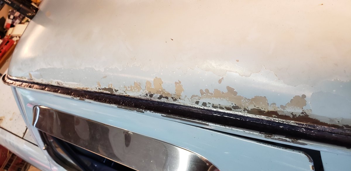

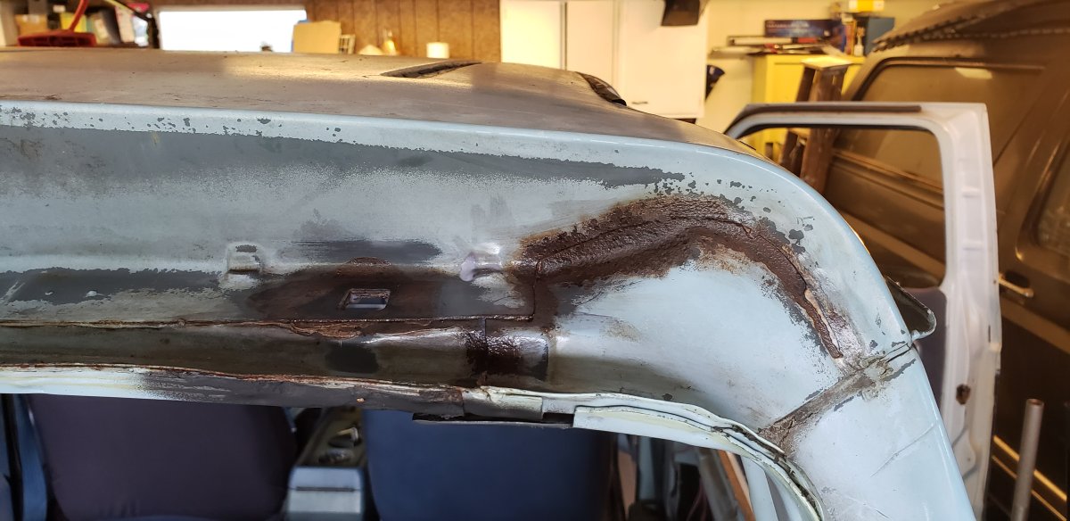

Now I have found the rust I mentioned before. The front pans really need to be stripped, sanded and treated. There is also a nice rust hole in the rear support but not much I can do about it. I let that area dry for a couple months and then sprayed as much rust inhibitor as I could in the area.

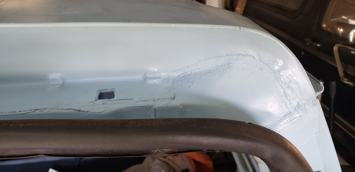

There was some surface rust on the roof so I painted that when I had everything out.
Chasing the leak I figured out most the seam sealer on the truck was in horrible shape with some regular caulk in there too. Scraped it all out and used EXTEND in most of the drip rails and rear cargo area. So far the areas I have painted after using the product is showing rust through so I'm definitely going back to POR15. The drip rails all got seam sealer re-installed.
I splurged and bought paint matching spray paint. I just couldn't stand the thought of the the jam area of the rear hatch (and drip rails) being a different color. Was spendy but I'd do it again. This is the area that the rust ended up showing through. So I will end up doing it again but using POR15. The rest of the bottle of EXTEND went in the trash. But you can see I cleaned, treated, re-sealed and painted the jam area on the back hatch. I threw a new seal on there at the time as well.

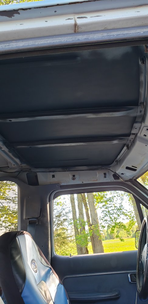

I will say this whole process took me forever. I am slow and I avoid stuff I don't like doing. Like sanding and tedious painting of things. Since I had to disassemble most of the rear interior to get the windows out I decided to take out the headliner and redo it as well. That's another post.
