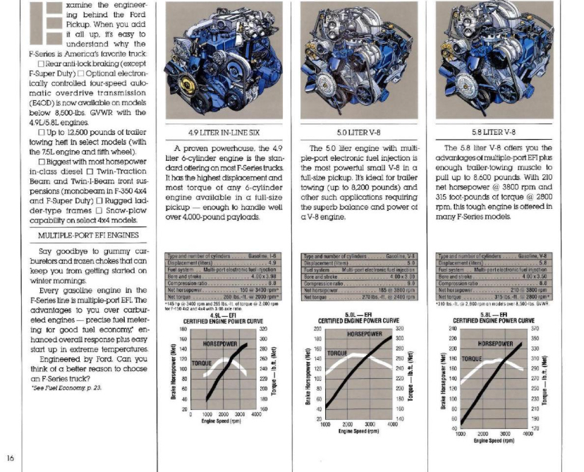

Ford even put out graphs to let us know the 300 is a slug…
I love how the graph is physically smaller. LOL.

It also shows that the 302 makes more torque below 1250 RPM than the 300 at peak… and the 351 makes more at 1000 RPM.

I think you looked at that wrong....
The 302 is making like 230ish at 1500rpm...the 300 peaks at 260
Regardless....all i know is the 300's ive owned seem to pull harder then the 302's.
Could be gearing, engine condition, i dont know. But like i said i didnt start this thread to argue.
Ill pick a 300 over a 302 (in a truck) everytime

you are welcome to drive them all instead of comparing dynographs.
