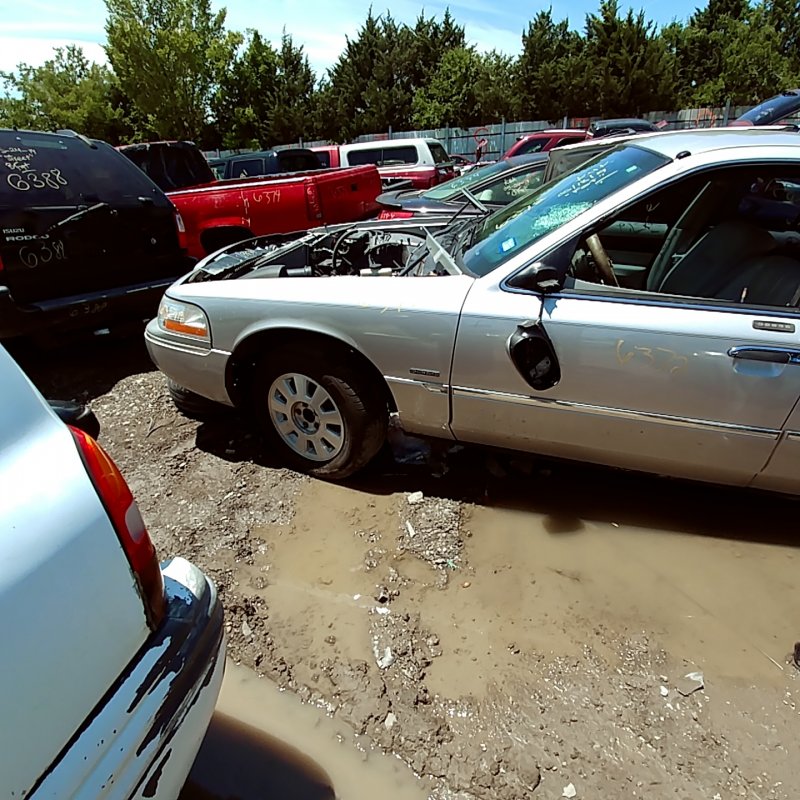

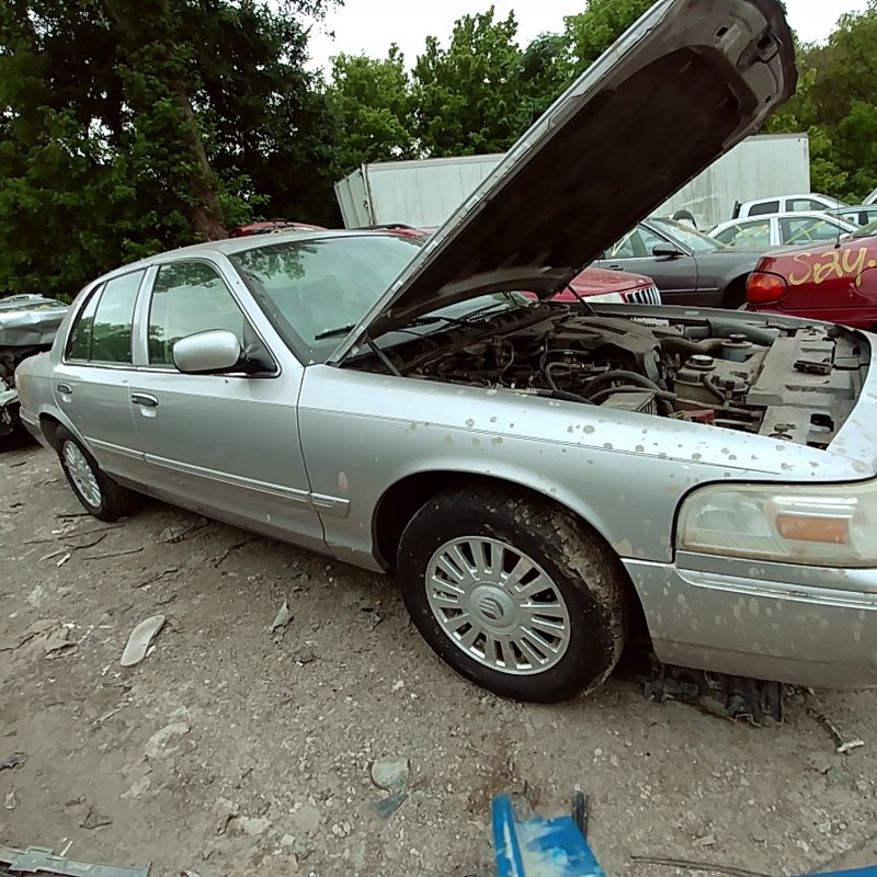

Junk Yard Hunt For 16's or 15's

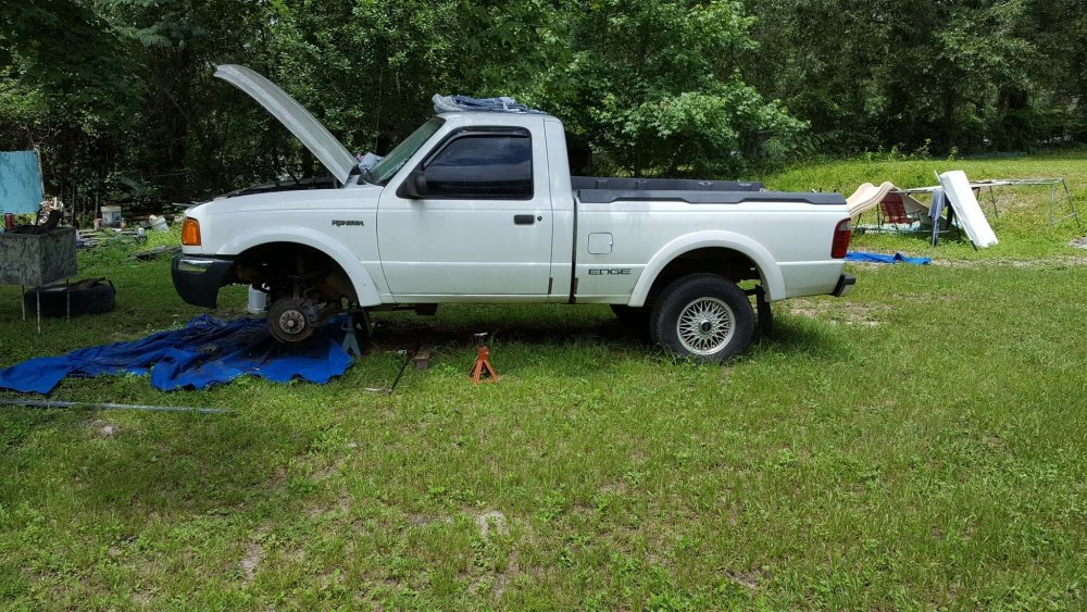

Definitely don't want studs breaking in motion especially. However, I broke 2 while removing passenger wheel, luckily opposite ones. So I did not want to take a test drive in this situation.
I will pick up longer steel studs from AZ tomorrow and give this better time than I had today.

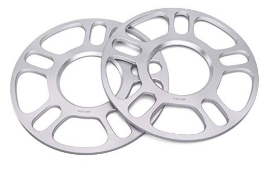

For quick testing 1" spacers could not sit flush to hub, not without these 5mm spacer rings. The rings are hub centered. Question are these spacer rings known to be safe?
if the big spacers don't fit flush on the hubs they are probably hitting the "brake register",,, that's the small raised portion the rotor rides on. a beveled edge on the inner side of the spacers will cure that issue.
personally my opinion is against stacking spacers, it's your truck & your decision.
with ALL spacers, especially the thin cheap ones, place them against the mounting surface of the wheel and check for proper contact.
there are situations where the mounting area on the wheel does not align with the spacers.
the wheels in the pic above appears the have a thin mounting ring outside of the lug holes. any spacer, rotor, drum will have to completely cover that ring.

Only the small spacers appear to have the correct bevel edge, the big ones are hitting that break register edge.
I don't want to stack them, am skipping the big ones, this way I will keep my spacers situation to a minimum. The thin ones sit flush and they tested ok. The truck handled normally, with non of the earlier symptoms, and they helped with rubbing quite a bit.

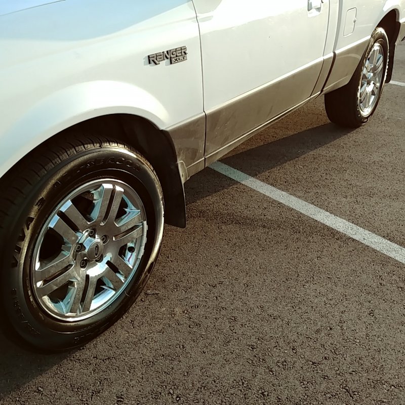

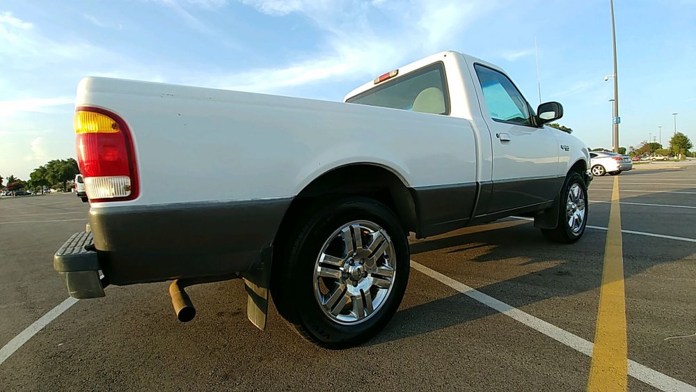

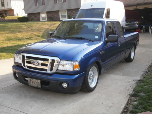

I cleaned up the chromes and painted the shoes with Cover All (have heard impressive things about this product. I am very curious to see how long the shine lasts.)
Even though my first preference was aluminums I have decided to grow into the chrome wheels look. Might as well seeing the 18" Wheels have had the effect of lifting the truck a few more inches and my biggest value score is that the tires are new.
29221
29222
nice. what size spacers did you go with?
Thanx! Right now I'm settled with just the 5mm ring spacers. At lock there's a slight rub I can live with for now. Later I plan to get 1.5" spacers for the fronts. Those will completely eliminate rubbing the suspension system and remove the need for the 5mm rings.
