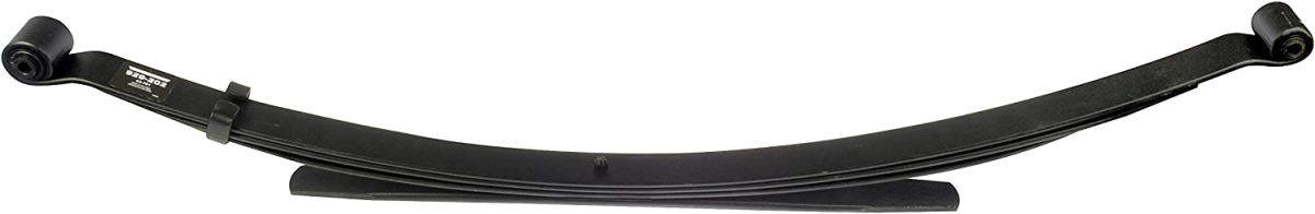

When truck is unloaded the main leaves shouldn't touch the bottom "overload" leaf. And in all cases the "overload" leaf should be straight . As in the picture below - main leaves are curved, the "overload" is flat.
"Overload" leaf on my daughter's B4000 curves opposite to main leaves as it was severely overloaded at some point in its life. (it had rough life as farm truck before she got it).
my leaf springs have a curve like drawn in this picture, although i exaggerated that curve in the drawing. i guess i should pick leaf springs that dont look like mine, :p

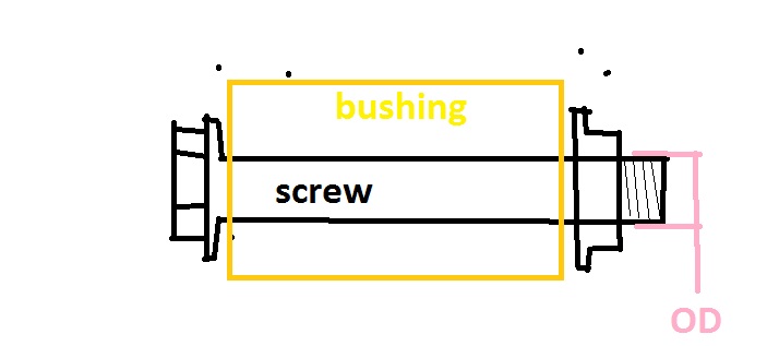

kinda confused and i cannot find a straight answer online.
I have a 2000 ranger and I am looking to replace the leaf springs. i will also need to replace the bushings. one bushing sets has an ID of 5/8, the other bushing set has an ID of 9/16. how do i know which my ranger uses?
Also I found a doner set of leafsprings from a 1994. it looks like a 3rd gen body style ranger but a lot of what I am reading is saying that the cut off date from matching leaf springs is 1997
4th post on this link
makes it seem like i will have to buy an specific bushing kit and supply my own seperate bolt?

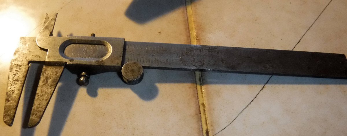

you need to measure the bolt or whatever it goes to
You can find one of these in a pawn shop for a couple of bucks or get the digital readout for about 20
Josh B. any chance you could verify that this is the measurement theyre talking about?
I don't see any way to follow their story Buck
The photo I see on your page here the bolt measures one/quarter inch, when I look at it on mine it measures one and one quarter inch.
