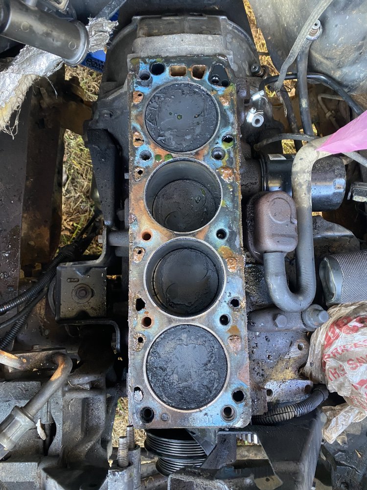

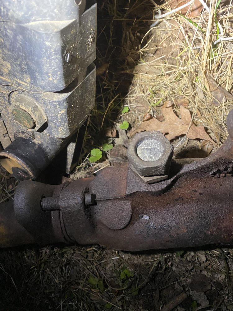

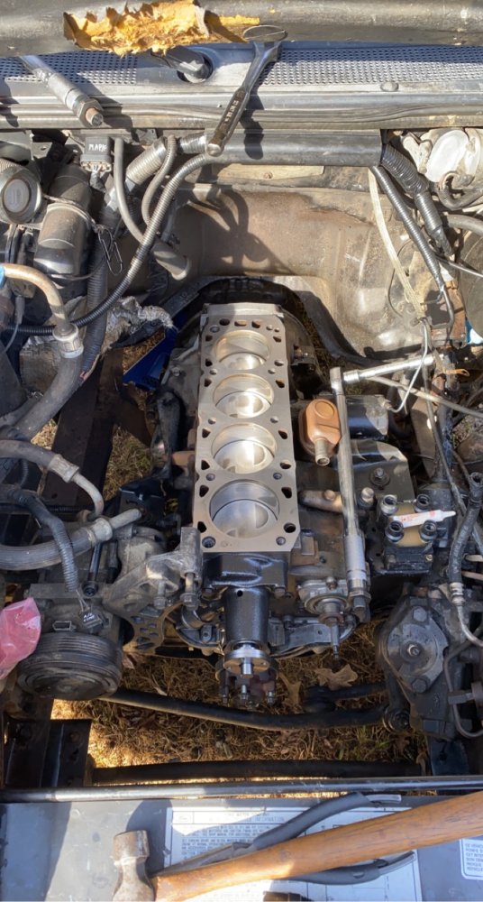

When attempting to start, everything sounded like it was moving as it should. Started by testing spark and fuel pressure, all good. Half-heartedly tested a boatload of sensors (that I've replaced 80% of) with my multimeter to no end. Had been having some symptoms that I associated with a partial head gasket leak (misfires under heavy load mostly) so decided to do a compression test and got 0psi in cylinders 1 and 4, ≈35psi in cylinders 2 and 3. This told me I had bad rings, bad head gasket/cracked head (highly unlikely), or something wrong with timing (the belt/tensioners are parts I already have on hand if that tells you about my confidence in the OEM ones from '89). Pulled the valve cover off to find a very small puddle of coolant on the exhaust side between cylinders 3 and 4:
This gave me no specific idea of what the problem might be besides bad.

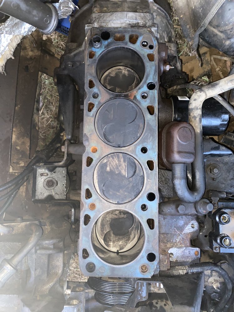

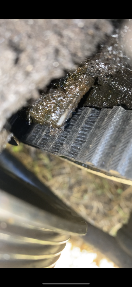

Started taking the head off to find that the timing belt had ripped about 5 teeth out and had very little tension.
This allowed the crank to spin freely even with belt still installed. Timing belt gave me the solution to my no-start problem, however, decided that I ought to pull the head anyways since I had suspicions of a bad head or head gasket and wanted to ensure pistons hadn't made contact with anything they shouldn't.

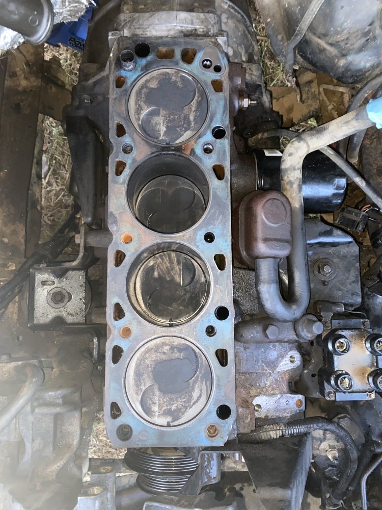

In my very limited knowledge the pistons look fine (although caked with carbon from the silly little EGR on these motors, long gone).
I have done a little bit of cleaning so far but know that I have lot more to go. The first photo of the deck is prior to cleaning and I THINK gasket still on.

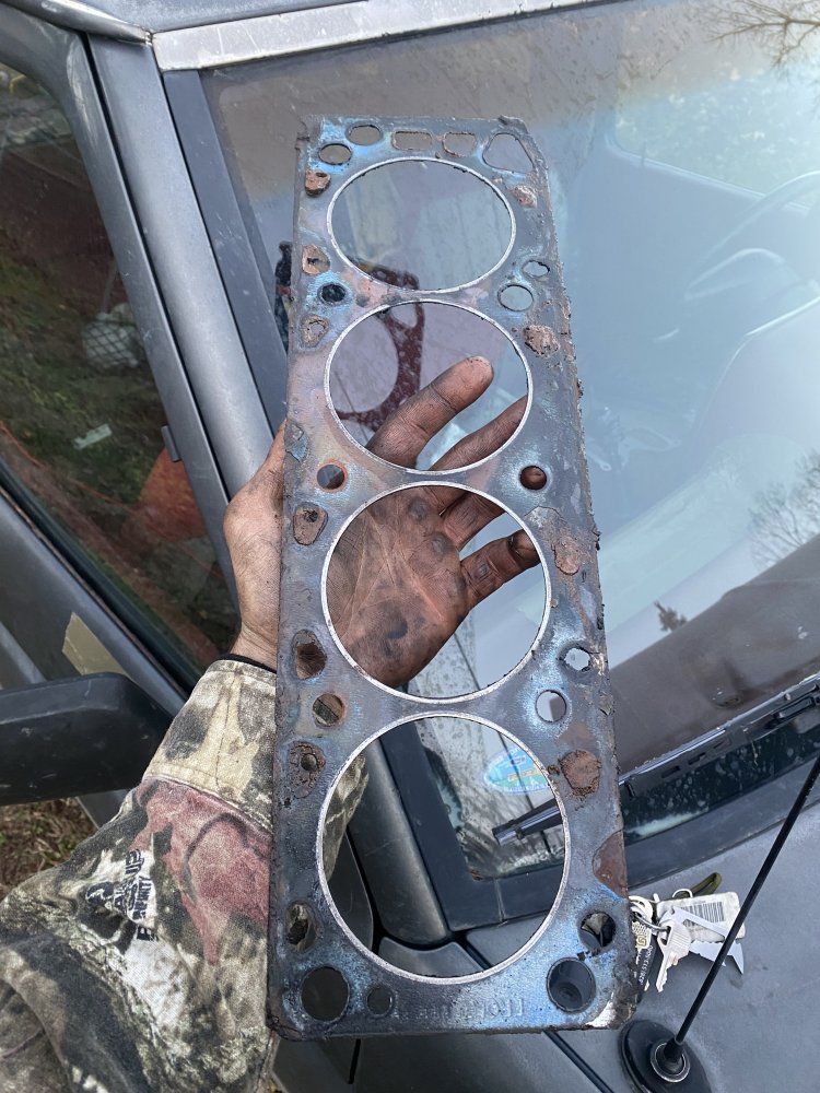

The head gasket looks decent to me, though it's clear that the area that holds coolant has a fair bit of rust in there because the openings to allow coolant to flow had oxidized metal in them. Also thinking maybe someone put some radiator stop leak in here? Have heard that can cause issues with coolant flow.

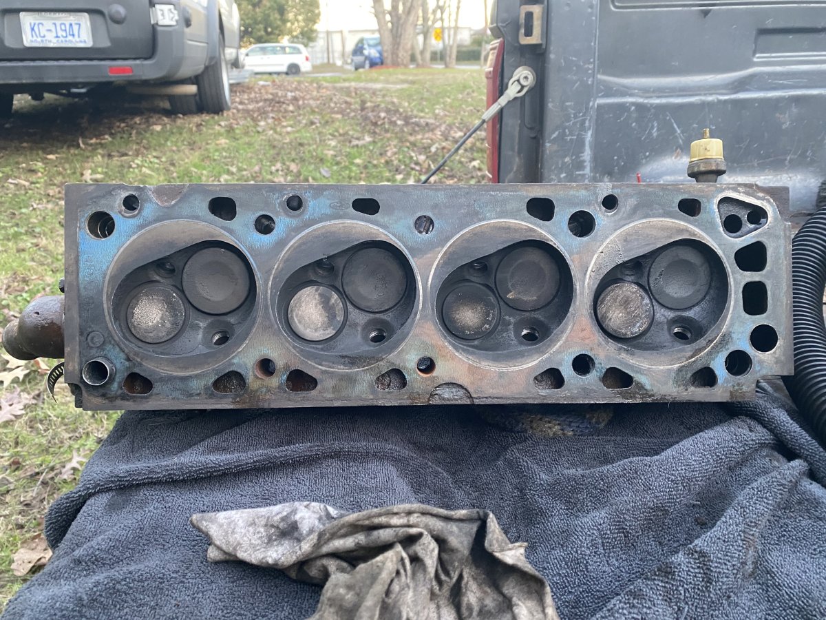

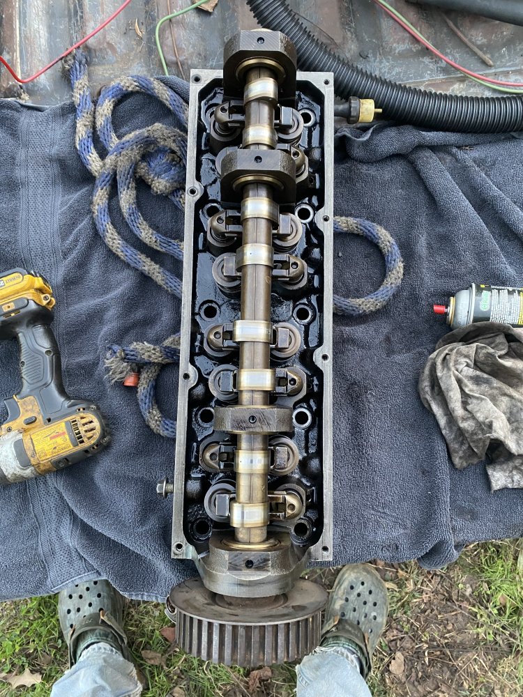

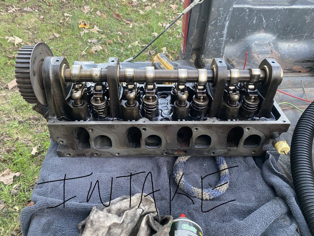

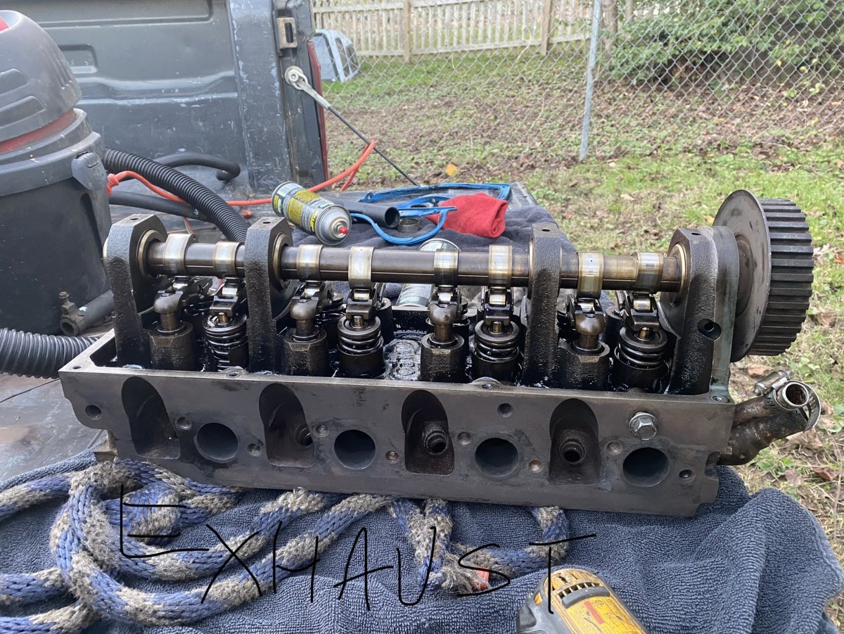

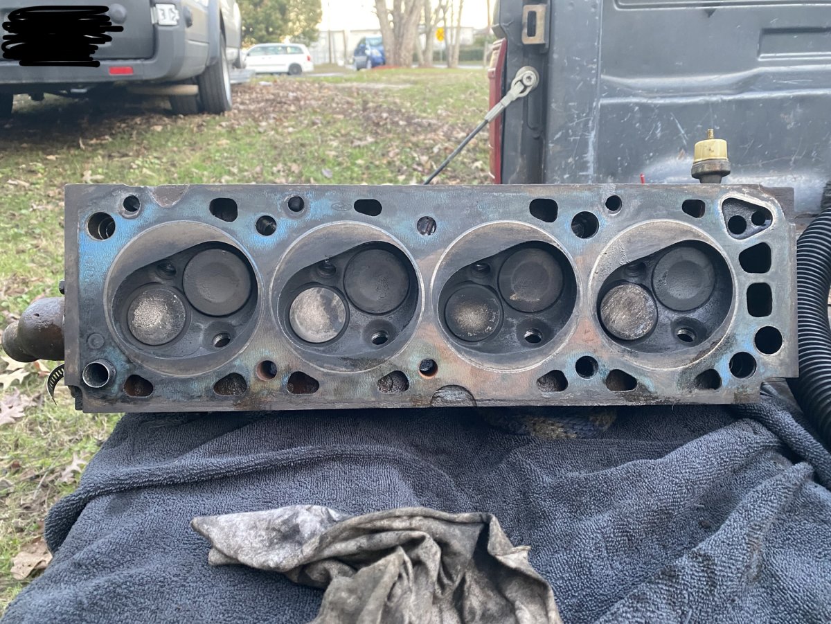

As far as the head is concerned I am going to have to remove all valves and such and have it deck mating surface flattened, valve seats restored, and intake ports matched (based purely off of the amount of carbon in those valve seats, no way those are sealing properly). Here are photos of the head after initial cleaning just for due diligence:

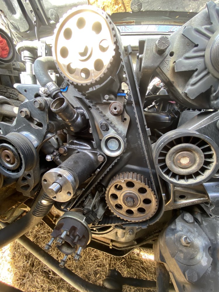

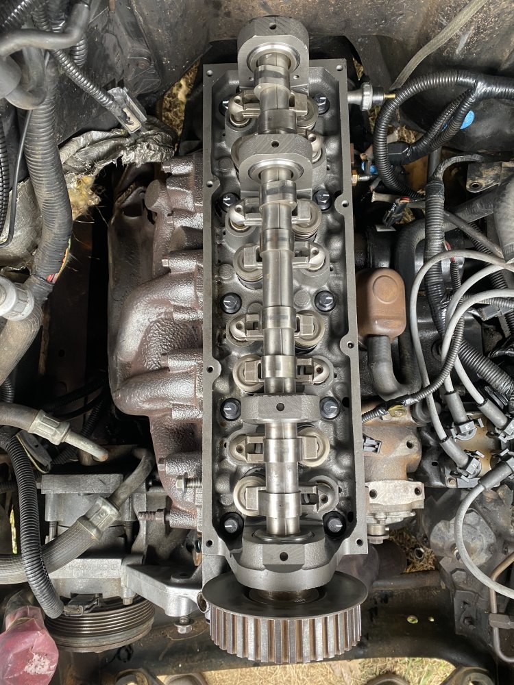

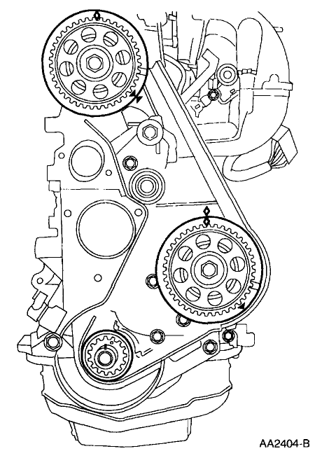

Since everything seems to be mechanically intact my intention is to make sure the rings are good (don't know how to test that, am working out of town for a few days though so have some time to research) and if so re-assemble the cleaned up head and put everything back together with new gaskets. The one thing there that I have no idea how to do is be 110% sure as I'm installing the new timing belt that my crank and cam are both at TDC. I have not been able to find any sort of mark on crank pulley, though cam sprocket is clearly marked. Regardless of whether the gears have marks or not, what do I even line those up with?

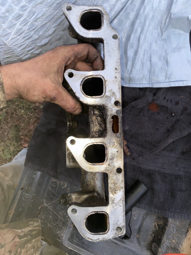

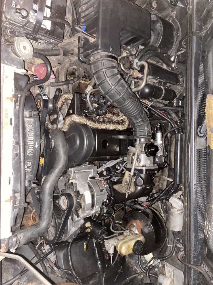

The channels in the front and rear passenger bolt holes were destroyed, but decided that they were unnecessary after ensuring that no coolant or oil used them as a passage, they're purely for aligning block-gasket-head as far as my driveway experimentation told me. Replaced all gaskets with new ones as well as wrapping any wire or hose near heat sources with exhaust wrap. Removed the EGR tube (finally) and sealed the bung using RTV and a quarter.

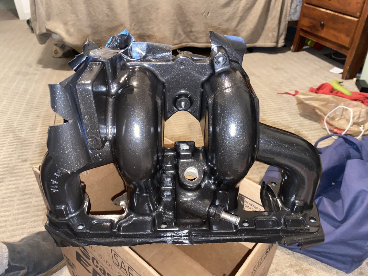

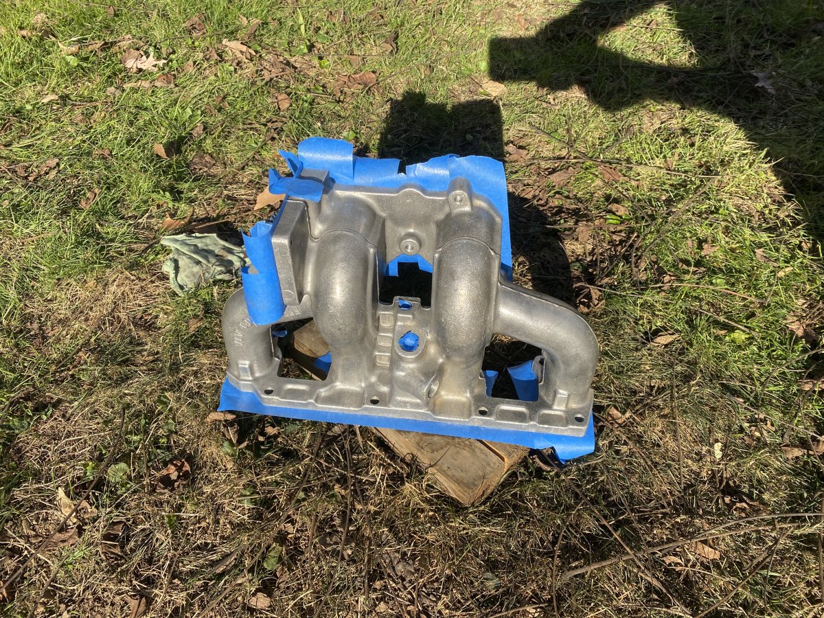

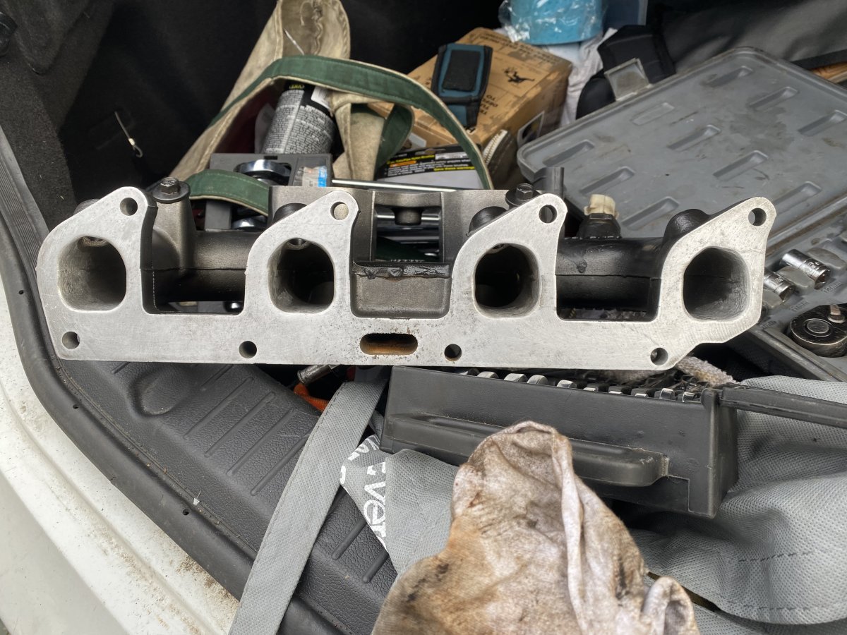

Ran an old EGR vac line through the wiring harness (as well as inserting other tubes into harness just to give engine bay a cleaner look) to give ECU the idea that it's stuck closed rather than nonexistent, we'll see if that has any effect, previously I just had it all unplugged and capped. Cleaned, port matched, and painted all intake parts (not TB, honestly was just too lazy to take it apart to the extent that it'd be paintable).
After this; primed oil pump, immediately installed timing components (that spring is STRONG), and put on valve cover
time for start-up! At start-up I put some ZDDP additive into the oil and instead of coolant had the radiator filled with a coolant system cleaner (brand is escaping me), followed the instructions for this cleaner (in N smoothly rev from 1500 to 3000 and let it back down, repeatedly...) for their recommended time of 20min, then went on a 50mi drive, never allowing RPM above 3000. Parked and immediately began draining oil while allowing engine to cool. Once engine had reached a temp where I could press palm against it no problem, filled it with oil/fresh filter and performed a cooling system flush, refilling with proper 50/50 mix. Since start-up I have driven ≈550mi, the longest trip in that time being about an hour.
Differences I have noticed: The fuel economy is slightly worse (≈30mi/tank) though the vehicle's ability to maintain ANY speed in the "correct" gear has been greatly increased. This holds true on a hill unless below 2000RPM, and accelerating up a hill is a bitch n a half. It now idles significantly more smoothly, although I am still noticing a random misfire that I have not had the time to hunt down. The torque band seems to have shifted from ≈1500-2500 to ≈2000-3000, an (as far as I know) unplanned but expectable outcome of matching, kinda annoying when accelerating but the truck was crazy slow to begin with so really have no right to complain. When under load the motor sounds as if it is having a much less difficult time pushing the vehicle, though this could be because the massive exhaust leak I created is not allowing backpressure to happen (that's more of a question than educated guess) or the leak is masking any odd noises that may have appeared. Overall, should have just found an older VW TDI motor and thrown it in there so I can actually break 85mph, but the truck runs significantly better and I would hop in it and drive anywhere if needed (only if needed cause it'd start burning my wallet instead of gas at some point). Thank y'all for all your help, hopefully this will help someone else out there, time to measure for some f250 struts/leaf shackle flip!

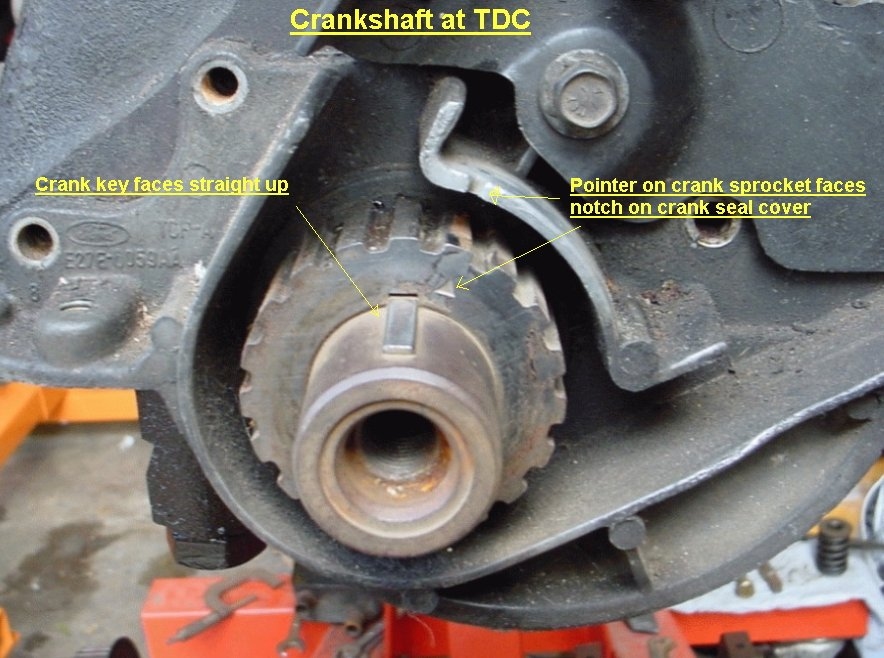

Looks like it is on the end of the pulley. Just a little dot

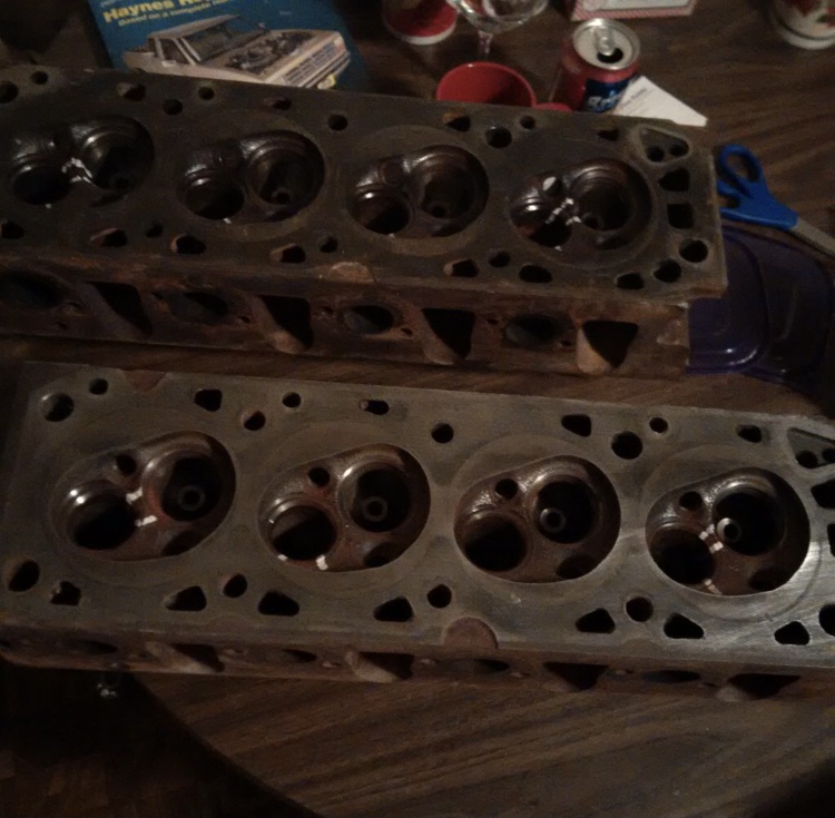

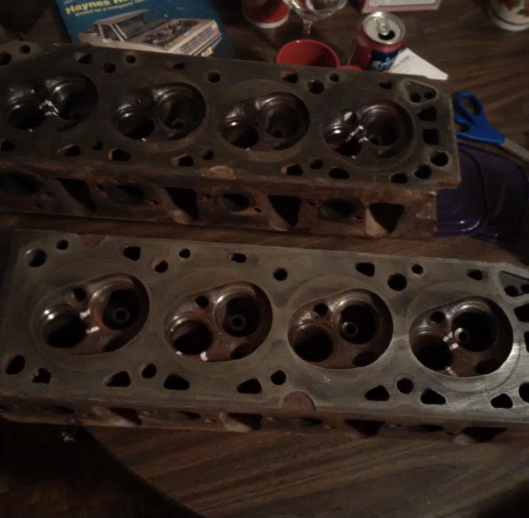

Have that head magnafluxed for cracks, the 2.3 dual-plug head is horrible about cracking from thermal cycling, If it is and you get a junkyard head it might be the same way (personal experience) I ended up getting a remanufactured head from autozone, dont recall the price, its been 4 or 5 years and im sure its more $ now. If you can see in this picture, all the white marks on the valve seats are cracks. My issue started with a blown head gasket between cyls 3&4. A 2.3 doesnt run well as a 2 cyl.
Holy cow both of those had a bunch of cracks... definitely gonna get mine looked at after seeing that but probably more for curiosity's sake. Seems like a better use of my time to buy a head like you recommended after ensuring the bottom end is okay. Getting up a hill that way is no fun at all

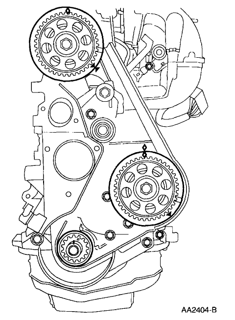

The pics looks like a small bot on the edge of the pulley facing the radiator. Like a punch mark
Yeah, that plus this:
Jumped timing belt. How do set crank and cam back to TDC independently?
Don't worry about the aux shaft (the middle big one) on a '89 since it just turns the oil pump..., the mark on the cam pulley has a corresponding mark on the plastic inner timing cover conveniently right under the silly rubber dust plug on the outer timing cover...
Don't forget to put thread sealant on the cam bolt no matter what you do, that can be a huge oil leak...
Look at all the cylinder bores while you have it apart like that, any vertical lines in the bore that can catch your fingernail mean the rings/pistons are questionable...
Looks like I'll need to take that front pulley for belt attaching A/C off, potentially why I was missing the mark on there. Preciate ya!

Ahaaa I was wondering what that dust cover was for! Assuming that thread sealant is the same as thread locker maybe just a hi-temp version?
