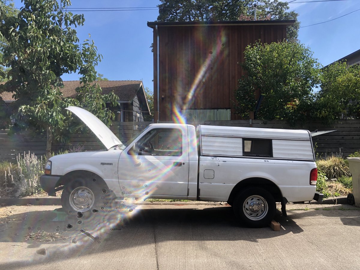

Here's a picture of the truck as I bought it and with the free topper I scored on facebook marketplace. Dented and dirty but no rust. Today the ranger got a new radiator and oil pressure switch as well as some hoses and an oil change. When I bought the truck the oil pressure gauge was not reading any pressure which I new wasn't right since the truck was humming along just fine and the guy had been driving it that was for a while (braver man than me). So I took a wild guess that the switch was bad, which turned out to be correct. Super easy to swap it out, and now I have a functional gauge that reads normal.
Coolant didn't look too bad, oil was black as all get out and there was some cheapo filter on there. So I'll change it again soon.

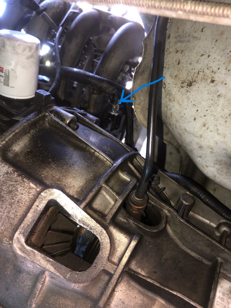

and if anyone needs to know where the oil pressure switch is located on a 2.5 lima motor the blue arrow is pointing to it. Was able to access it pretty easily with the truck up on ramps (tires were chocked and parking brake was on) with just a 3/8 ratchet and a spark plug socket. Took maybe 5 minutes.
