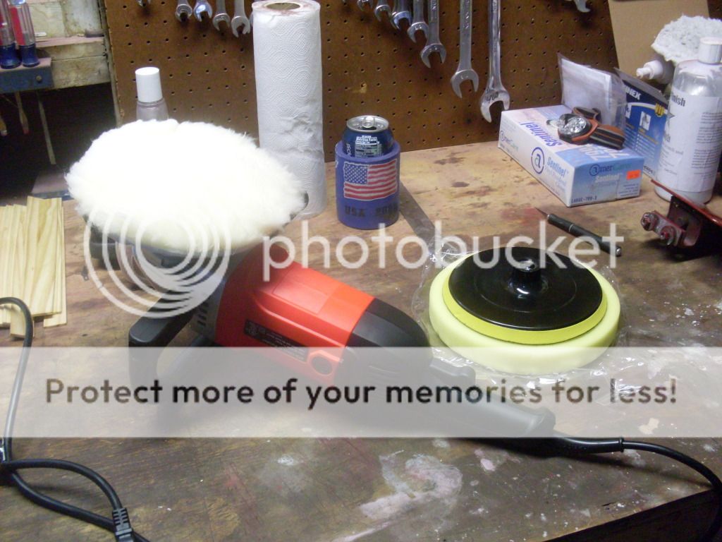

Got the buffing thing all figured out today! PetesPonies offered some really good advice that I basically did word for word and it turned out really nice. First thing was to drop the orbital buffer then drop some cash on a nice rotary buffer/polisher by ATD. It's got great reviews and is very comparable to professional buffers but at a lower price ($80). I also ordered a yellow foam pad for it ($15) and some SureFinish compound from Autobodystore.com ($37).

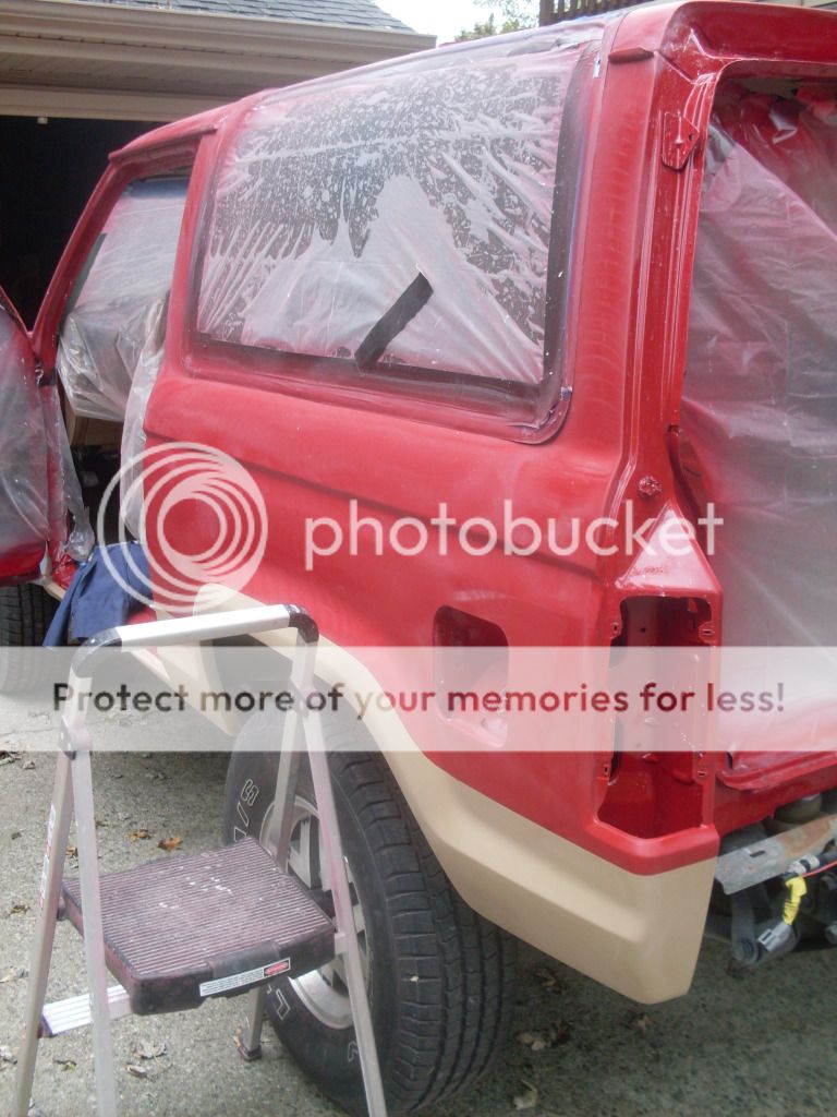

This was the temporary shop today. The garage was too dark to see all the sanding scratches that needed to get buffed out so I pulled everything out into the daylight. You can see all the body panels lined up in the garage ready for their turn on the bench.
First step was a wool pad at the lowest setting (1000rpm) with firm pressure (being careful not to burn the clear coat off the edges):

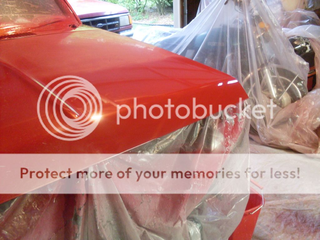

After that I followed up with more compound and the yellow foam pad with firm pressure (always at 1000rpm). Then some water on the pad and very light pressure. Here's all finished:

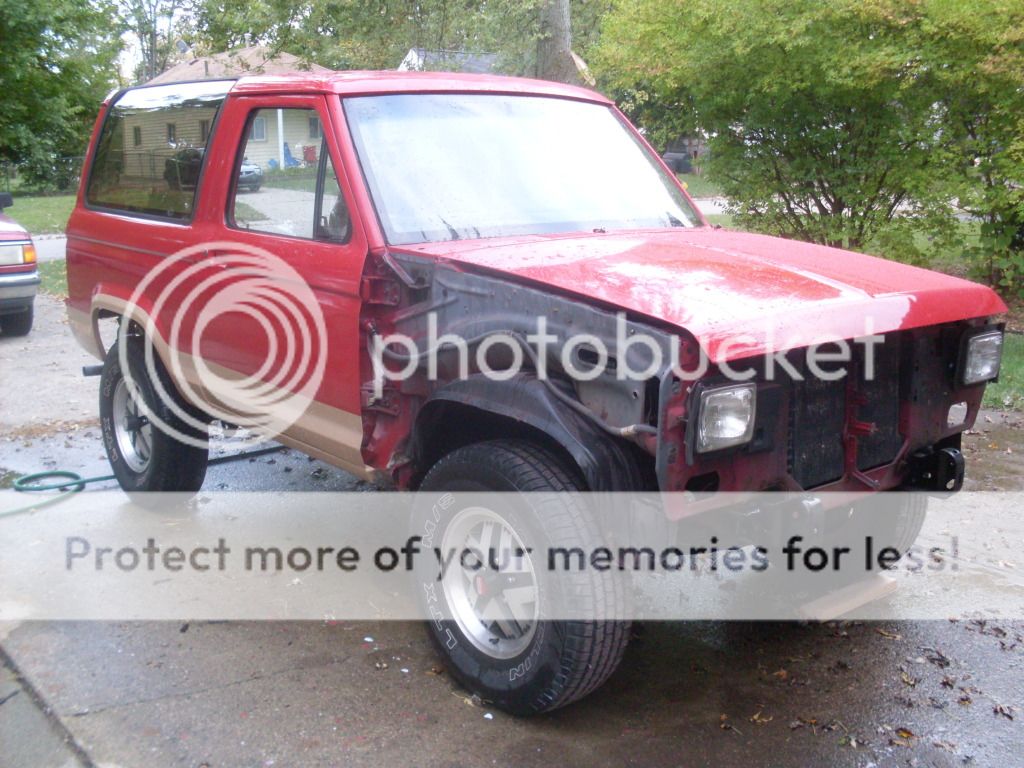

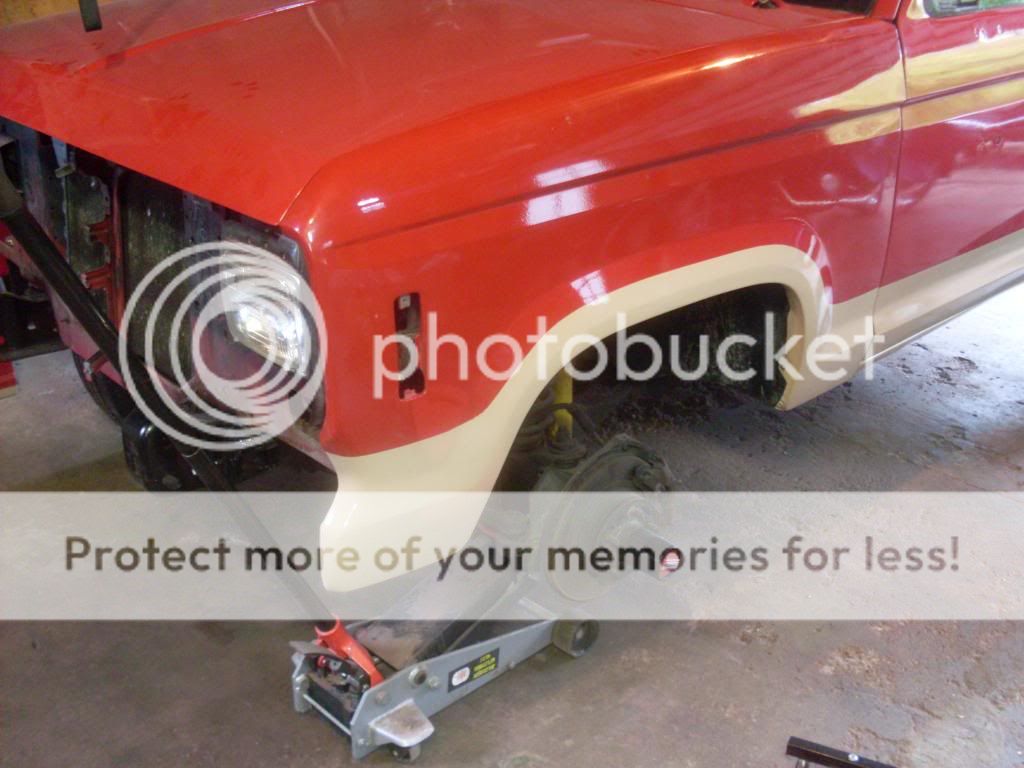

The fenders are on. Have to say I was a little disappointed with the repro fenders. The fit just isn't at the same level as stock and I had to grind down the flanges in the side openings so the marker lights would fit as well as a few other places. I'd recommend dry fitting them before painting, it just would have made it a whole lot easier to grind/bang the panels into shape. Aside from that it just took quite a while adjusting everything to get the fit as close as possible without the door hitting.

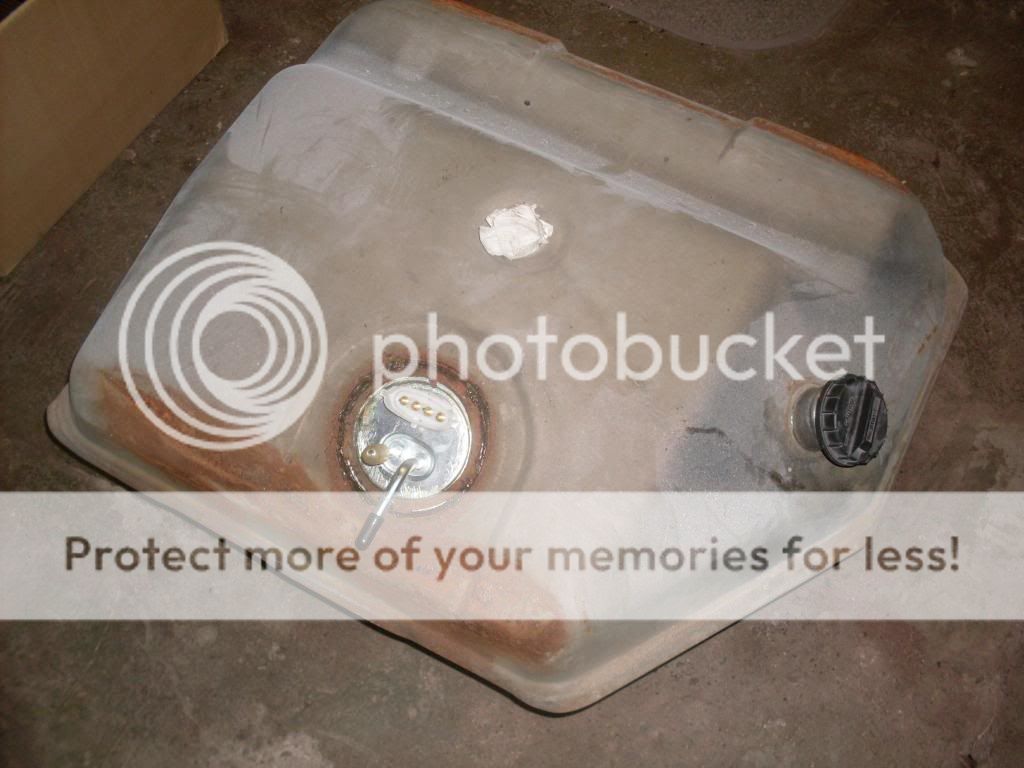

Dropped the fuel tank to install a new sending unit. A lot easier than I would have expected but still a pain getting all the hoses and wires hooked back up.

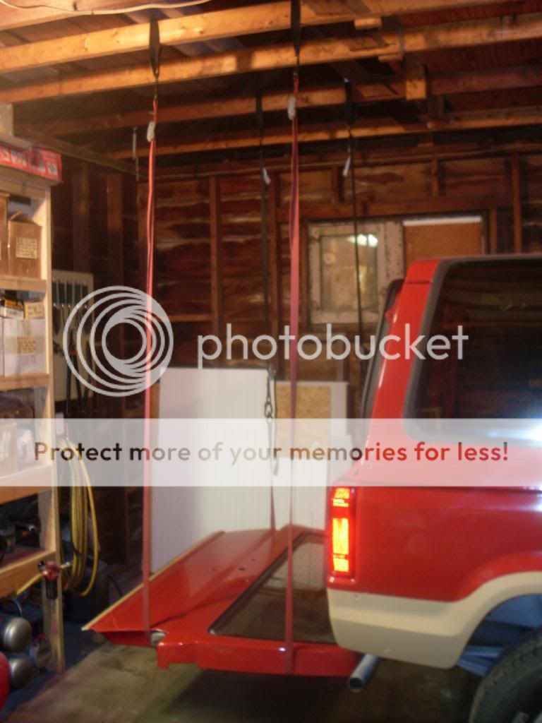

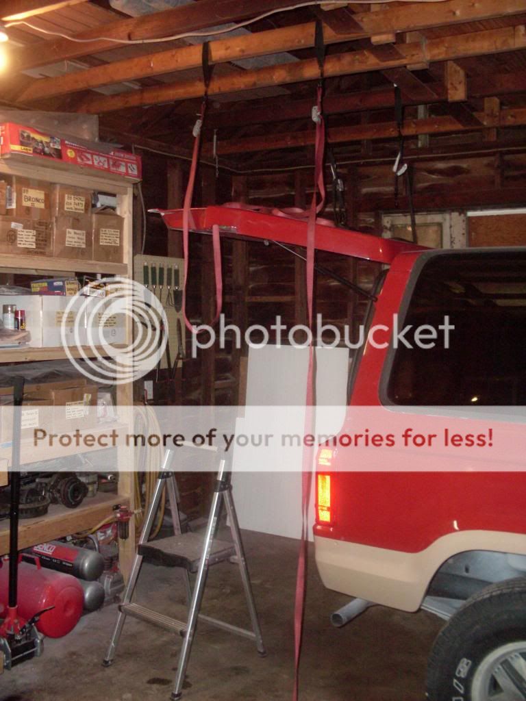

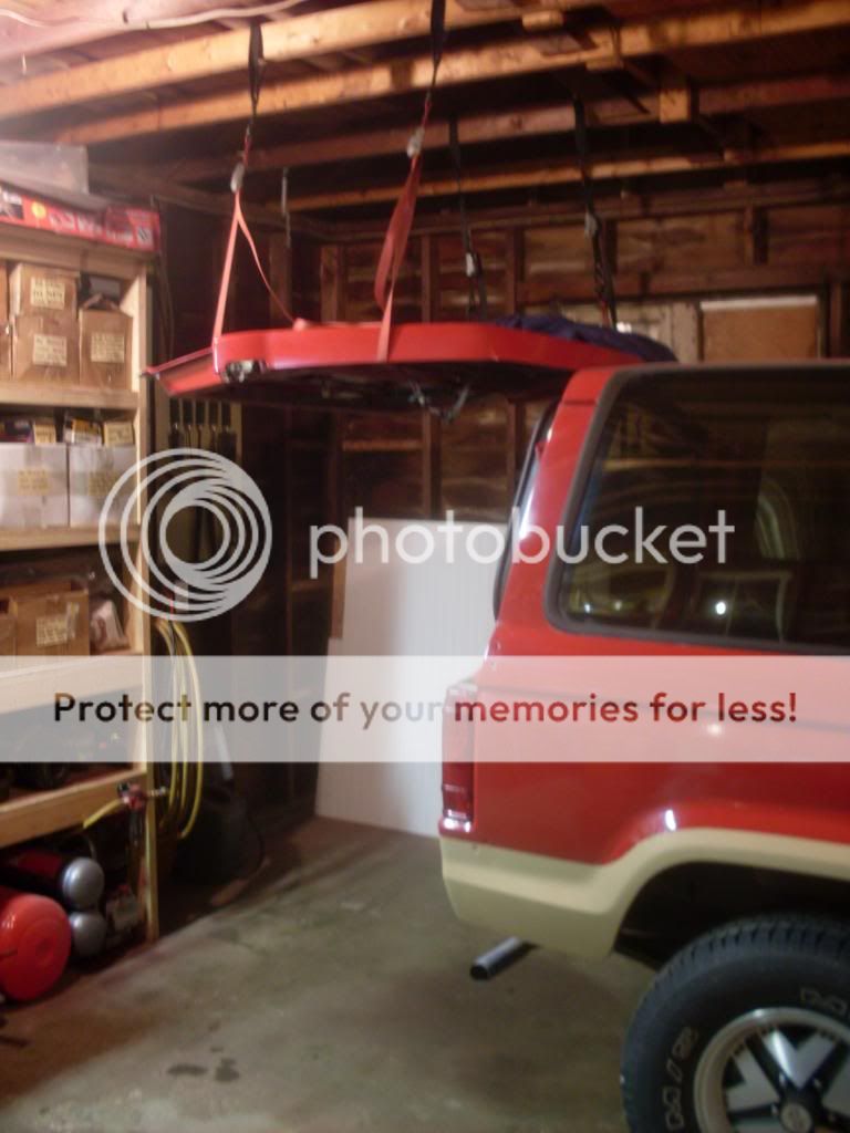

Here are some pictures of the liftgate going back on. I used this same set-up to take the liftgate off and also when my truck box needs to come off, really makes easy work of it. Once the liftgate was mounted it took about an hour to get the alignment right.

Looks great!! As far as the front fenders . . well welcome to the world of repro parts. It is standard fare . . you have to message them to make them fit correctly. It's why sometimes the repro parts just aren't worth it. But yours look good now.
