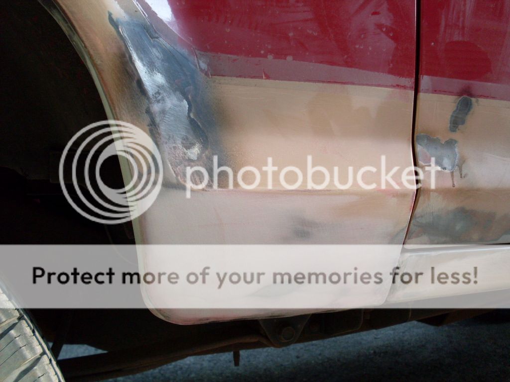

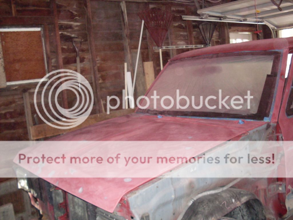

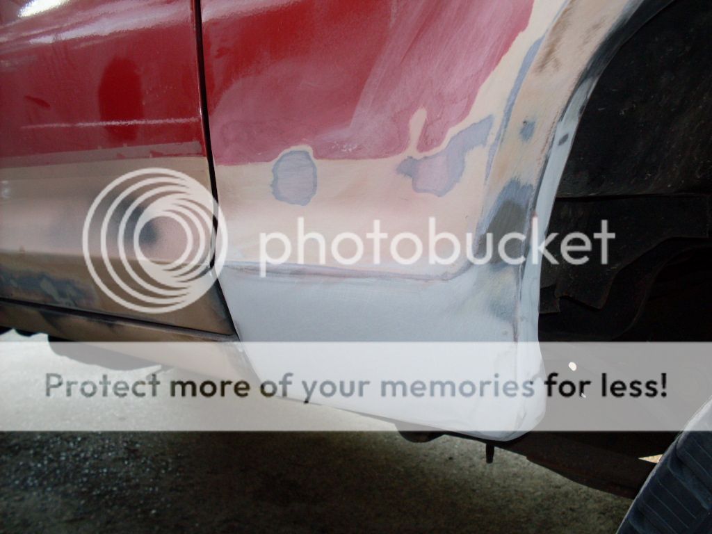

Here's the driver side.
Sanded down with 150 and 220 on the DA and feathering into the old paint:
Josh's Bronco II Body Restoration Thread

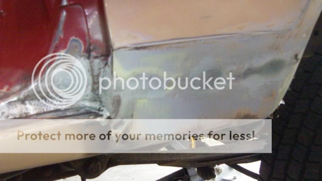

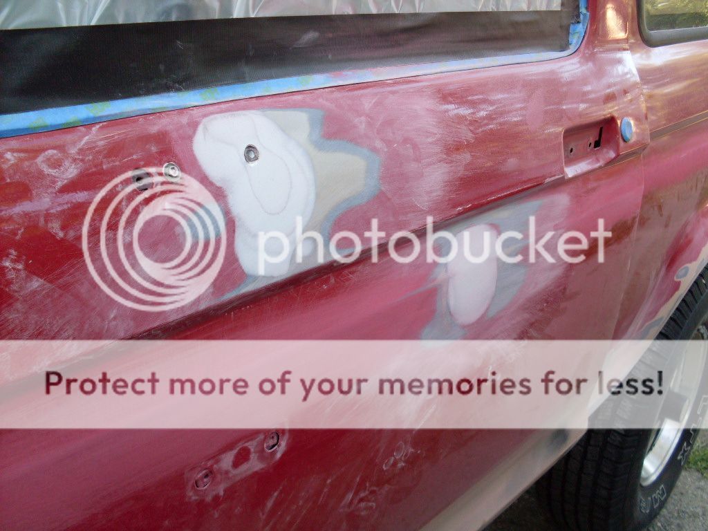

duraglass:
Sanded down:

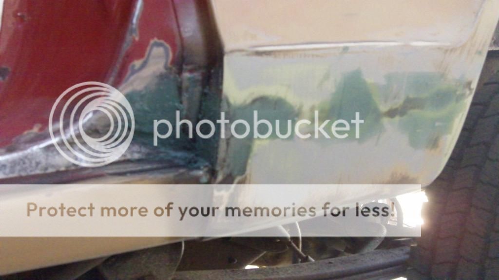

First coat of regular filler:

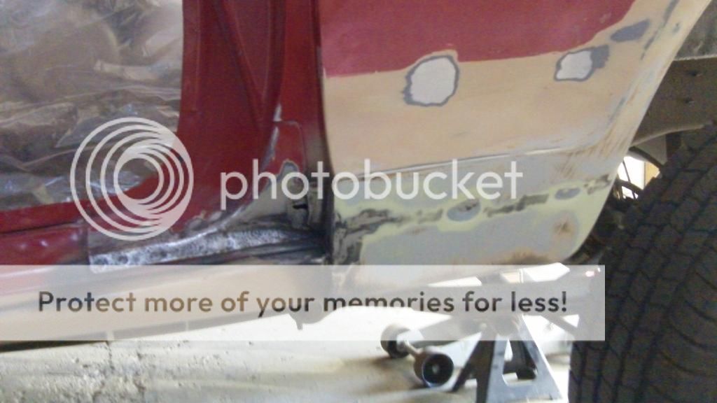

Some other areas.

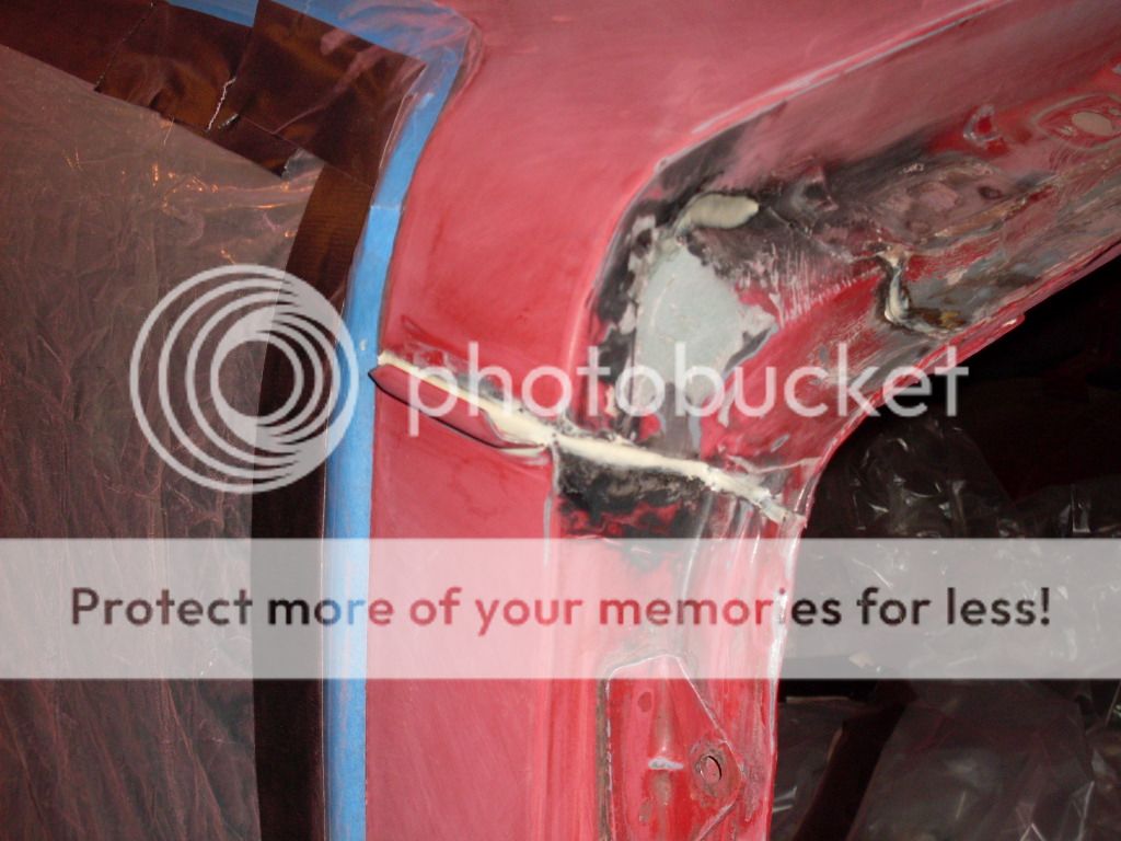

Lifgate opening bottom driver corner: There was a 1/4" dia. hole here that got tapped in with a hammer, sanded with a rough grit for bonding, duraglassed, and 1 layer of filler on both sides. I need to sand it yet but I'm not too worried about making this one pretty since it'll be hidden under the hatch anyway.

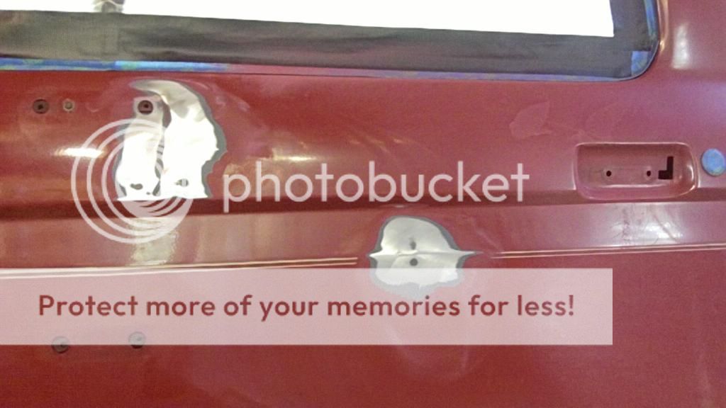

There was some mirror damage to the driver door that was tapped out by the PO but never finished. I left the centers unsanded for this picture to show where the low spots were.

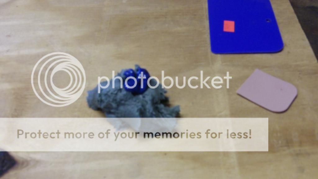

Feathered the old paint out, roughed up the bare metal, and covered with filler about 1/16" deep.
Just for the record this is waaay too much hardener. It was my first run with filler and it hardened before I could even get from the workbench to the truck!
You only need to estimate, but there should be about 2% hardener.

Over the past week I finished the filler. Here's the passenger side that got the fiberglass:

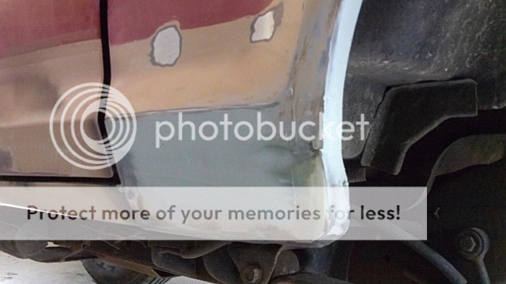

Driver side:

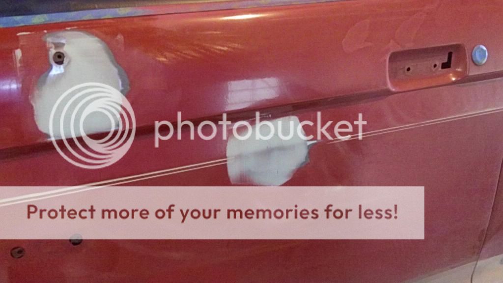

Driver door dents repaired (from mirror ding):

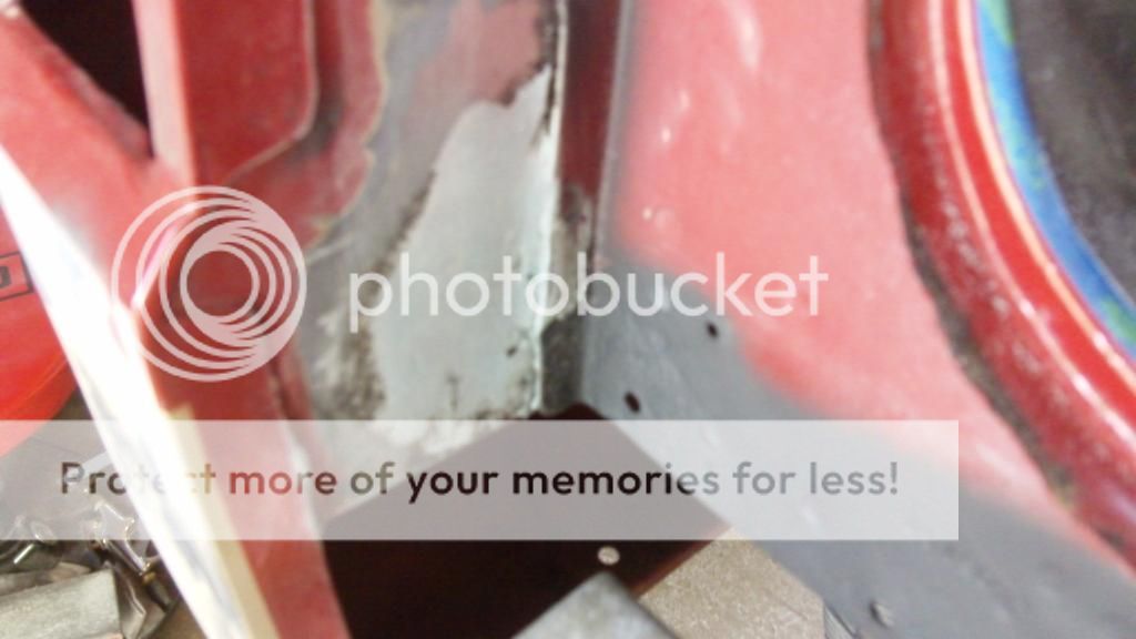

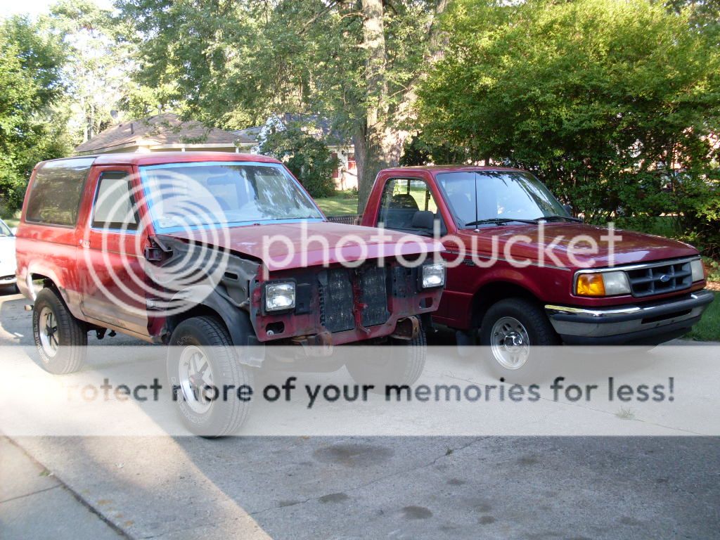

Here's sort-of an overall of where the Bronco's at right now. Hoping I'll be ready to paint in a couple weeks...

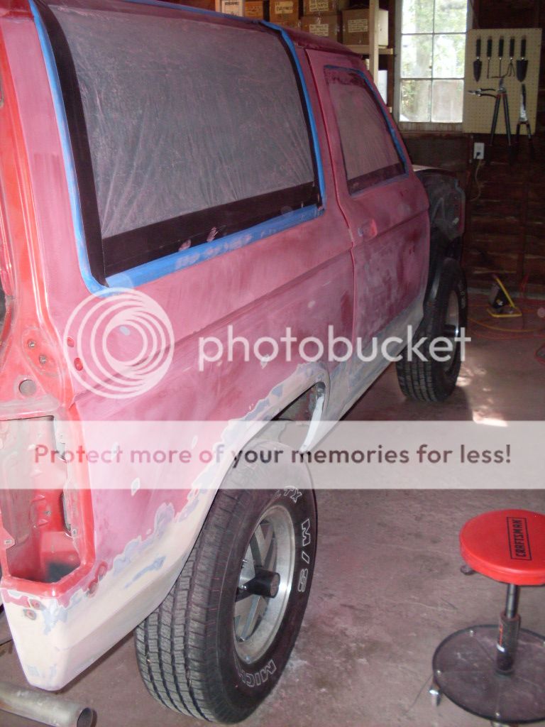

Progress update:
About 80% of the Bronco has been sanded over the past couple weeks up to 220 grit. Then I'll primer the bare metal/filler and start the sanding process all over again with 220, 320 and finish up with 400-wet before painting. I can't believe how much time sanding eats up! So I'll be getting into painting soon, kind of uncharted territory for me, so if any of you more experienced folks want to offer some advice I'm all ears.
Yep I'm still kickin. The wife's car broke and I had to spend nights after work for almost a week to get it back on the road but it's all good now and I've been back at the Bronco. All sanded and new sealant on all the panel joints.

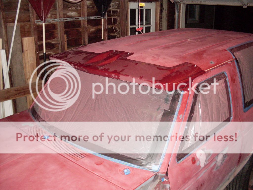

Had the neighbor stop by and along with my wife we all three dry fit the lund visor (saves me trying to line it up later and scratching my new paint).

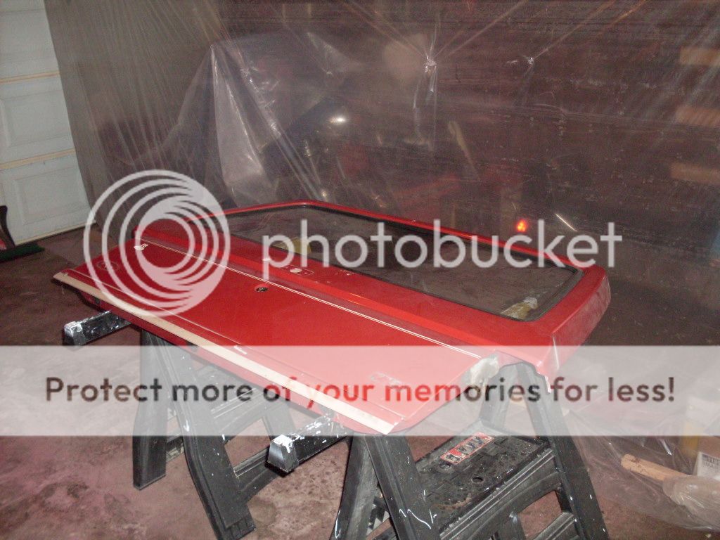

My new paint sprayer (Sharpe Finex 3000) should be here Thursday so I can start painting. All the paint materials have been bought. First thing will be to prime the bare metal/filler that's been exposed way too long already. In the meantime I need to start preping all the parts that'll be painted off the truck: fenders, visor, front panel, fuel door. My goal's to get the lifgate preped this weekend.
So yeah I'm still kickin. What's that saying, slow and steady wins the race? My biggest fear is the weather will change before I can finish painting and I'll have to wait till spring.:eek:
