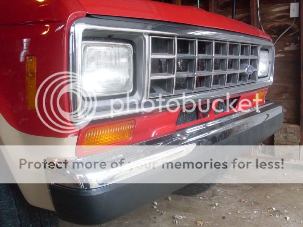

Was able to get the front all back together with the new bumper. Aint it shiny?

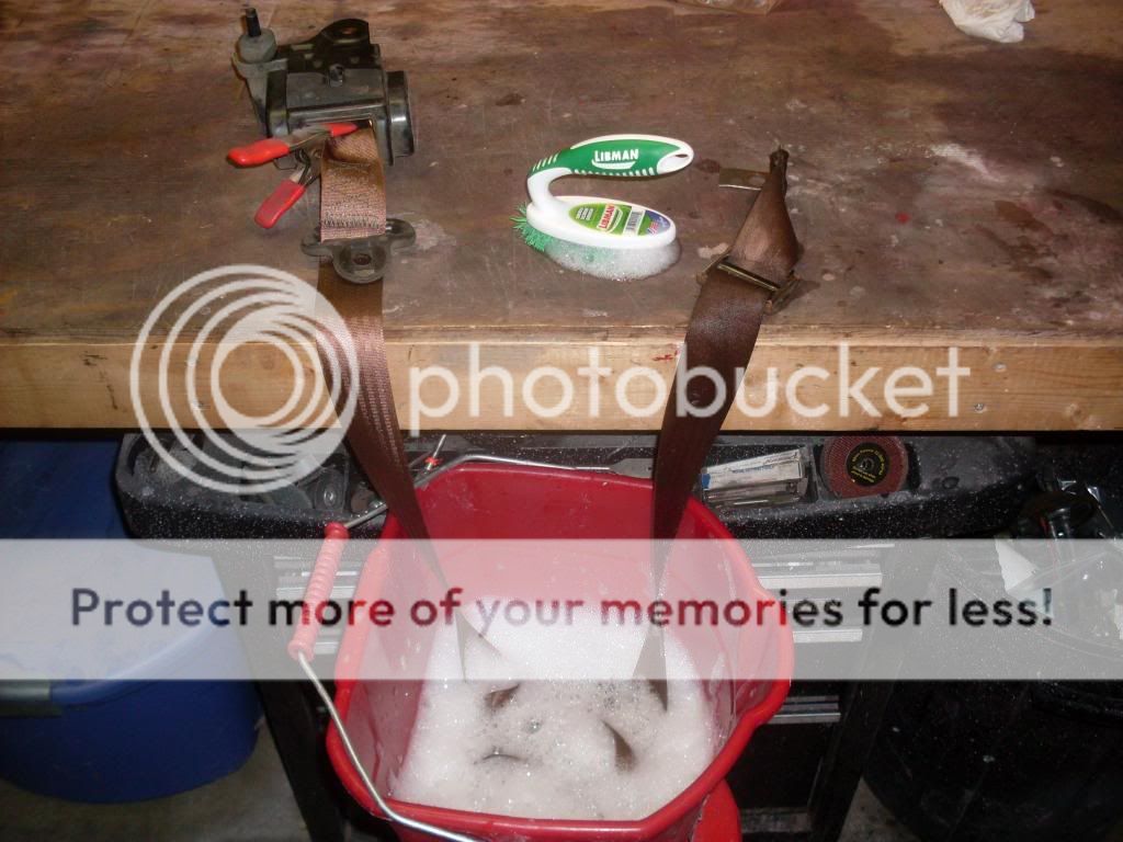

I read somewhere that cleaning the seatbelts helps them recoil so thought I'd give it a try using water and laundry detergent. I don't know if a previous owner had a thing against shirts but MAN those seat belts were dirty. The water turned so brown and murky with the first belt I had to completly change the water before starting the second. The belts are reinstalled now and seem to recoil slightly better but overall not much change from the experiment.

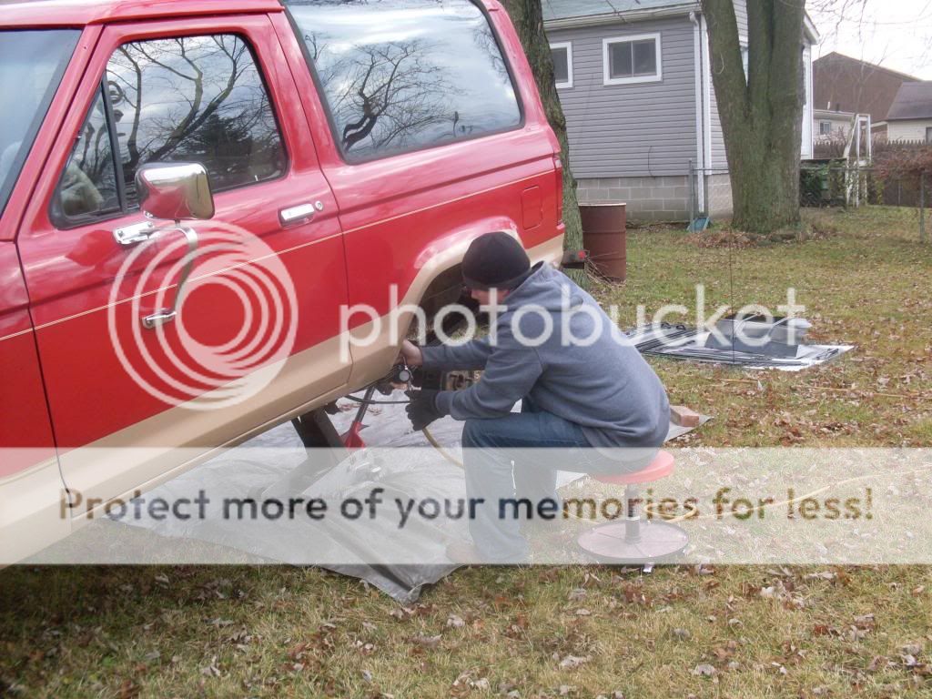

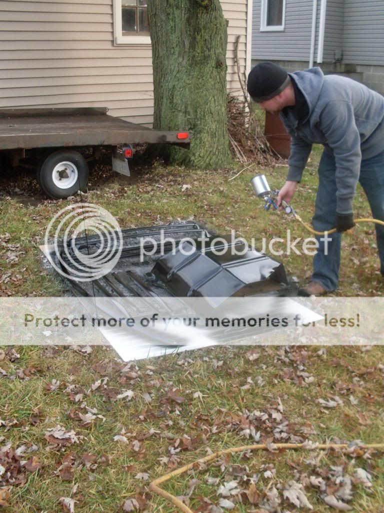

Well I'd been intending to wait till Spring to do this stuff but with the warm weather I just couldn't resist.

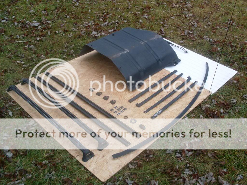

All the black trim and accessories were cleaned and sanded for refinishing:

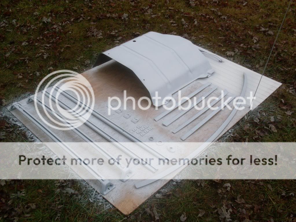

Epoxy primer:
Single Stage:
While the sprayer was all set up I lifted up the B2's rear end for some final spraying in the wheelwells:

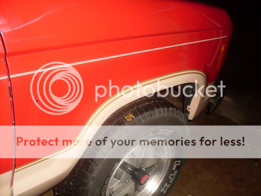

I was also able to get about 75% of the pinstriping on.
