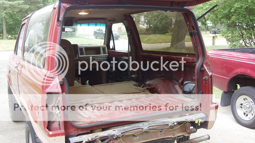

Decided to change gears a bit over the weekend and focused on disassembly. Most of the interior has been removed which will allow me to tape off just inside the door jambs so the paint line isn't seen when finished and also allows me to sandblast and spray the wheelwells from the inside. It's a LOT of work going this far but it prevents seeing the overspray in the door jambs and tape lines in the final work. Not shown here is that I actually had to remove most of the dash panels just to get the antenna wire out! It was one of those cases of take one part off to get to another and so on. Also found a PO spliced in the radio instead of buying the wiring adapter so that's something else to fix. Did find he had replaced all the stock speakers with nice Kenwood 3-ways so not all bad I guess.

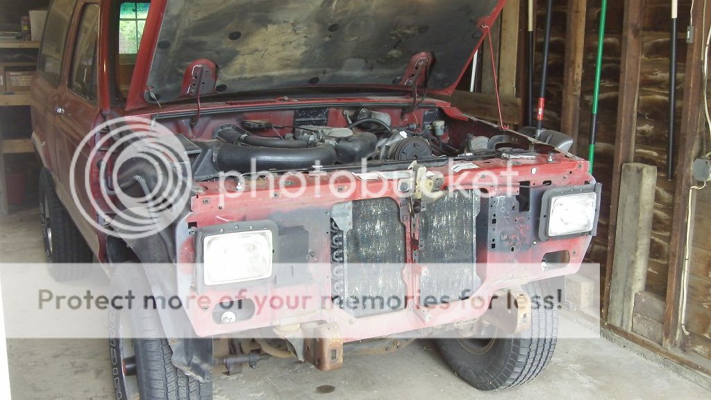

This next image shows most of the front end removed. I have new fenders so those will be painted off the frame along with the hatch (still to be removed) and the front rail (just above bumper). I did find a hide-a-key inside one of the fenders and from the look of it the original owner had put it there. That makes 5 sets of keys now! Before painting I'll tape plastic over the entire front clip to keep everything in the engine compartment nice and clean.
