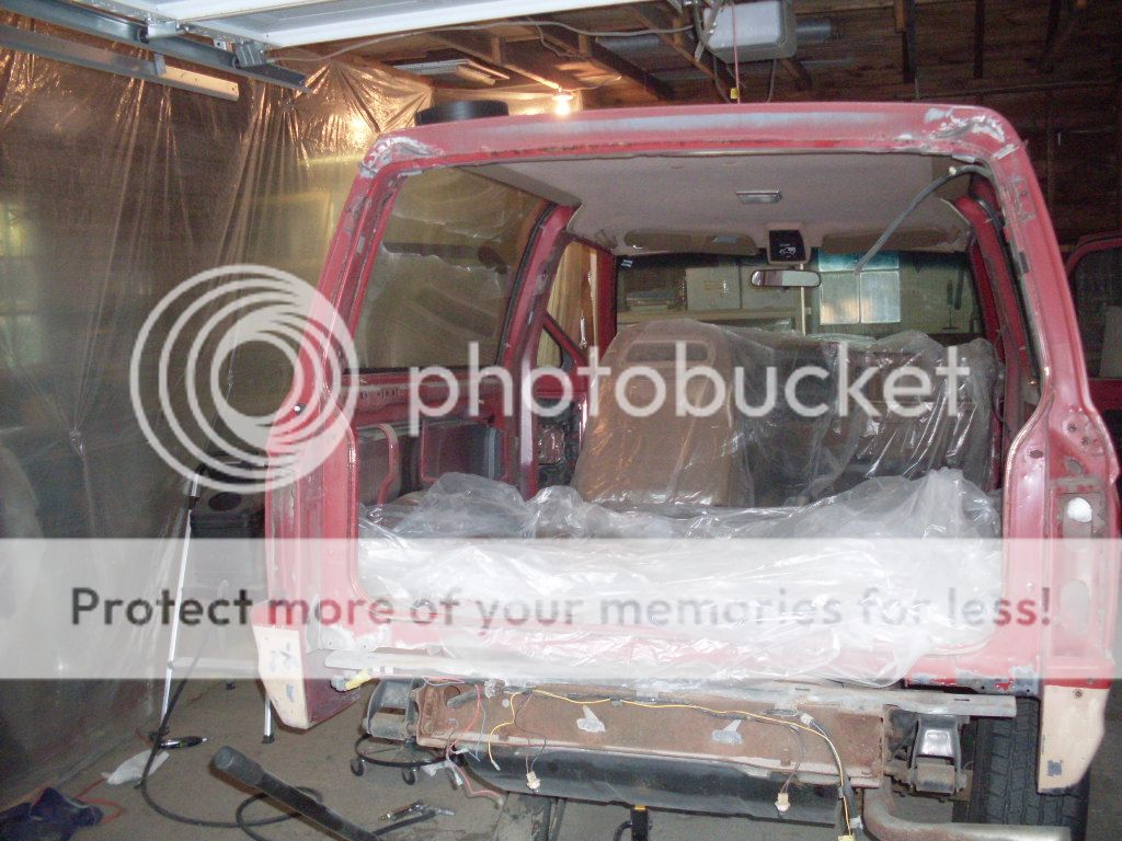

Took off the liftgate last night by ratchet strapping it to the garage rafters, unbolting, and lowering the straps one by one. I do the same thing when taking the box off my Ranger and it really makes easy work of an otherwise impossible job. Will need another day or so to remove the remaining door latches, weatherstripping, etc. and then finally can get back to the rust.

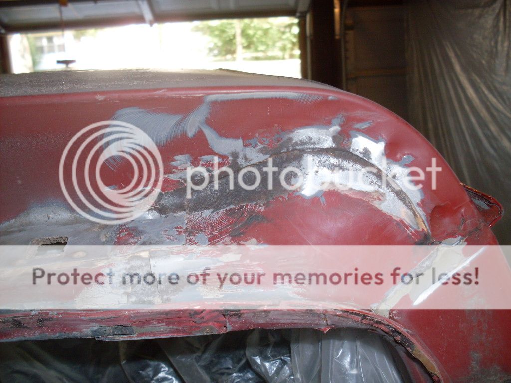

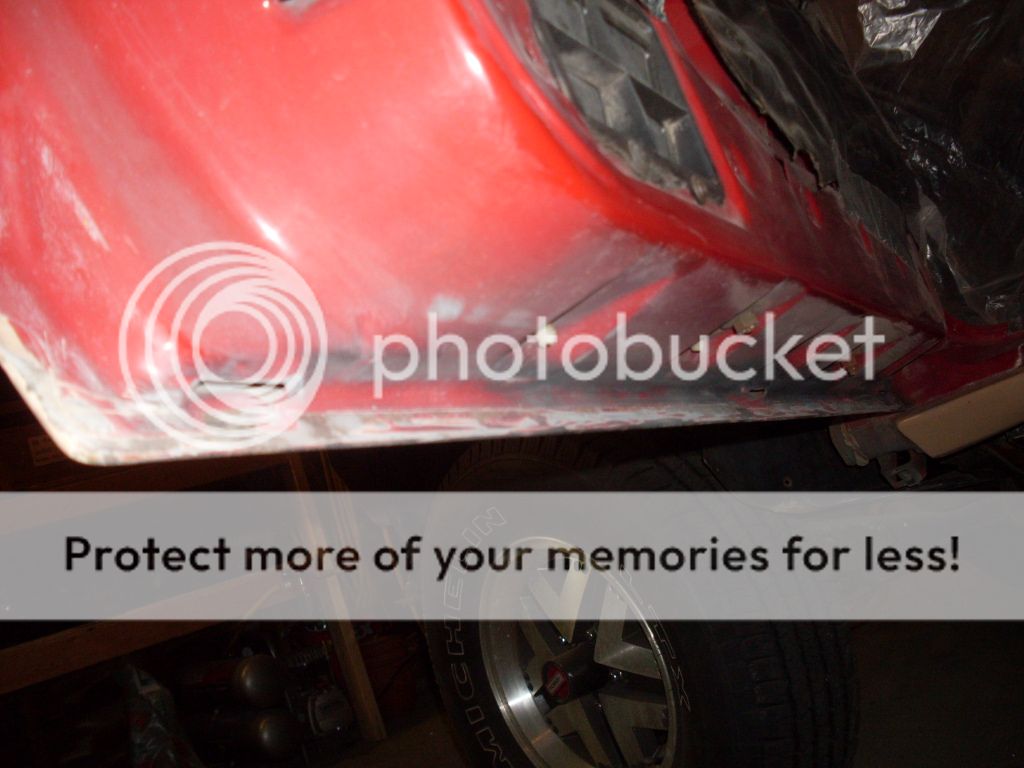

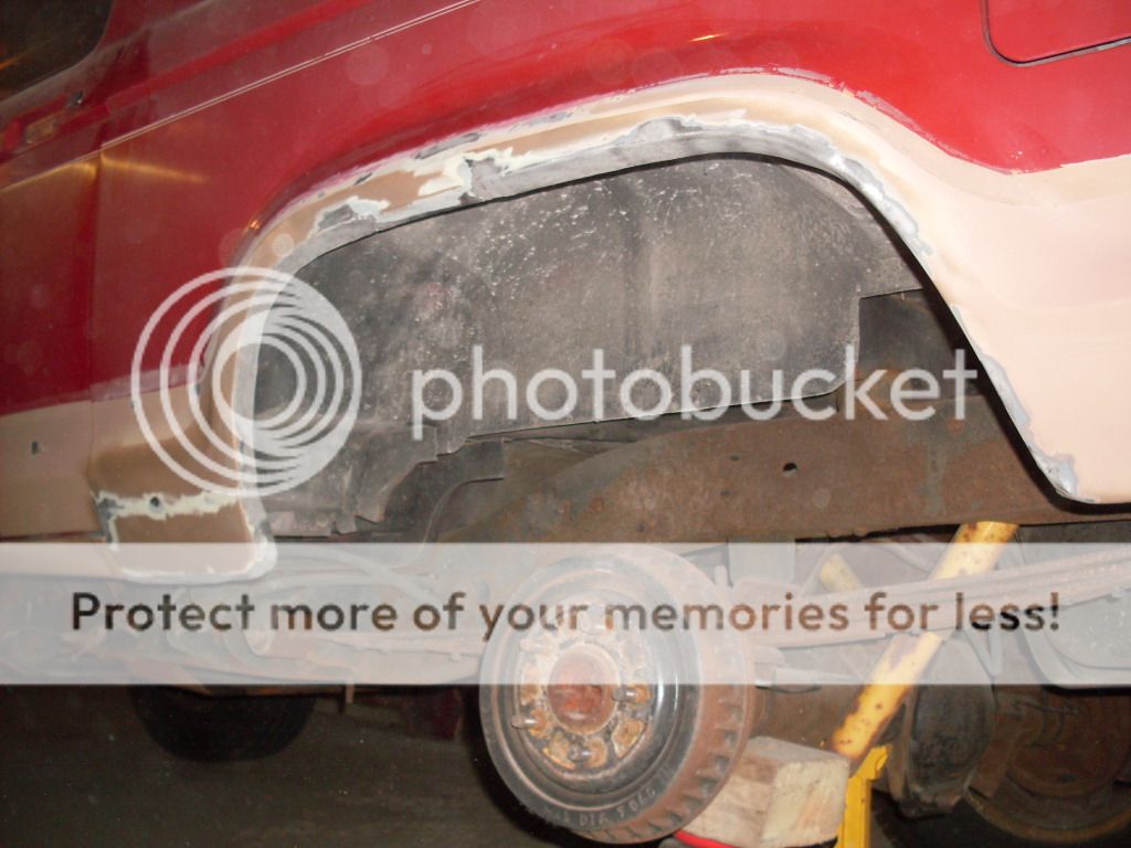

Well after spending most of the weekend in the garage I was able to finish grinding/sand blasting off all the rust. That picture I posted before of the passenger wheelwell seemed to be the worst of it.
If you remember from before I'd been nervous about the driver wheelwell since there was evidence of previous body work there but was pleasantly surprised to see it had been done right, so it stays. In the picture you can see the outline of a patch panel just behind the door and another centered over the wheelwell.

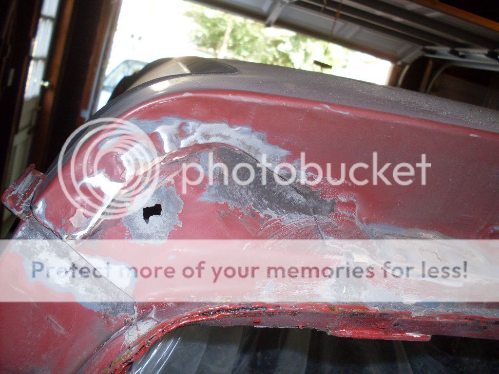

Above the hatch door, really glad I took the liftgate off and found this.

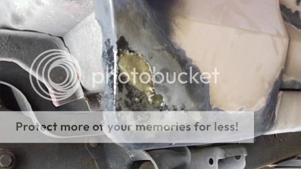

Found a small hole starting behind the driver side tail light. It'll get tapped in with a hammer and covered with fiber reinforced filler.

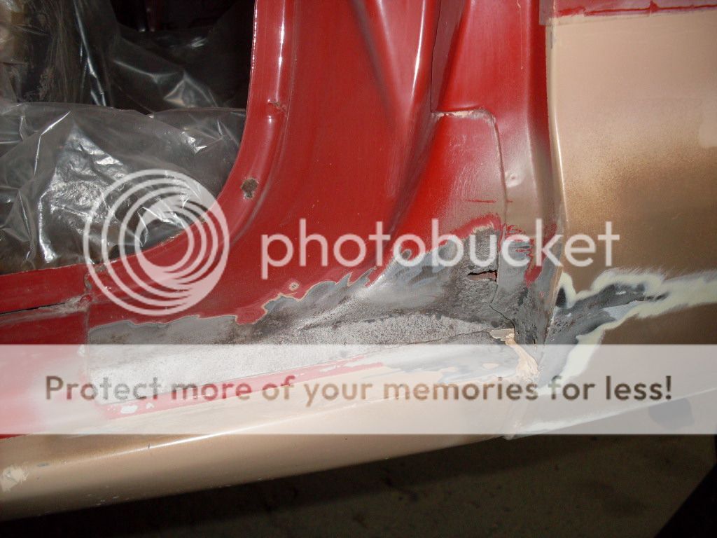

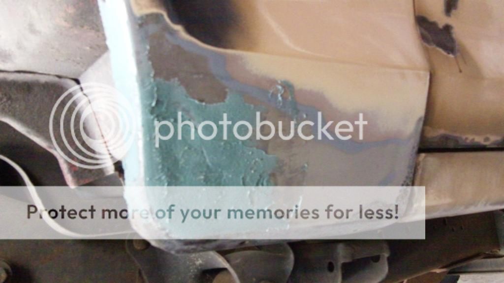

Same with the driver door corner. At least 4 body panels come together at this point and it just seemed to catch all the rust.

Yes that is a good patch. You are in good shape.
Glad to hear that coming from an Auto body instructor I know it's good. I had fully expected to find bondo over a big rusty hole there (plan for the worst I guess) but was relieved to find the professional patch job. There's also what appears to be closed cell insulating foam sprayed on the repair from the inside that I would guess helps keep air off the patch. Is that common? It surprised me quite a bit when I took the interior trim off and saw it.
If anybody could offer some direction on replacing some of the panel joint epoxy (along drip edge, etc.) and tips on applying fiberglass it would really help.
ex instructor :) I would say not that is not common. If I can in any way get to the rear of the panel, I definitely paint it. I use a rust paint to seal the weld. It's a very good idea to seal up the backside if at all possible.

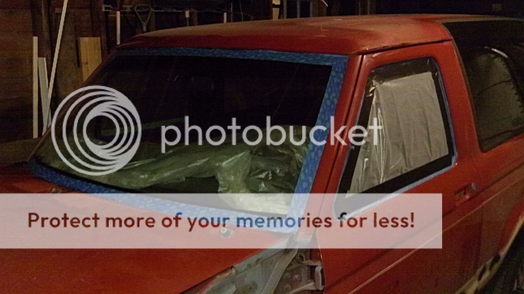

Started taping off. It's probably a bit early for that but with the heat lately I haven't been able to do much else. We've been in the 90's here all week and today got to 100. Hoping it'll cool off a bit this weekend so I can make some progress.

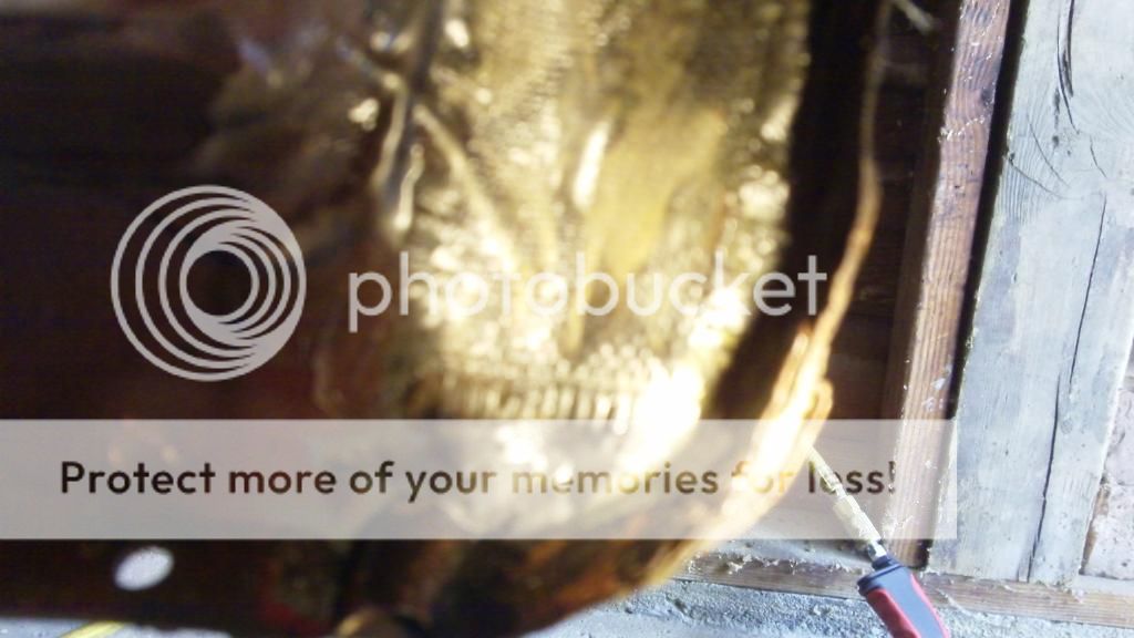

Fiberglass: The outer panel got 3 layers of fiberglass/resin via an access hole under the jack compartment and the inner panel got 2 layers inside the wheelwell.

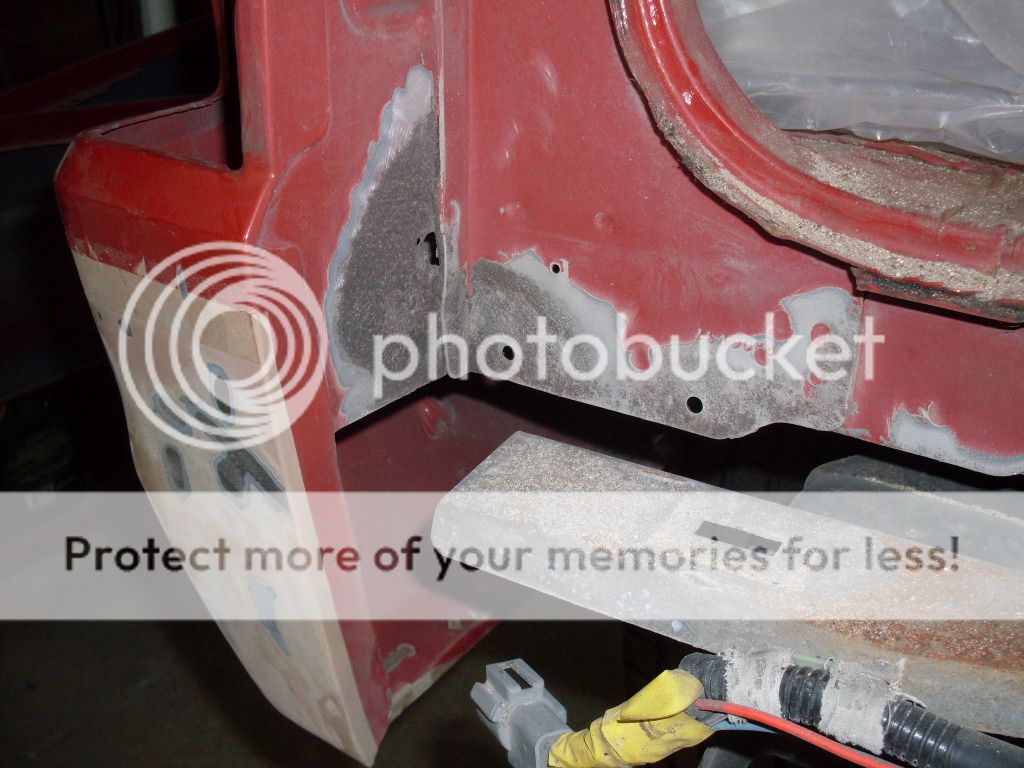

Here's inside the wheelwell. Sorry for the bad picture it was a little cramped in there.
And the fiber reinforced duraglass filler: I also applied it thinly over the fiberglass inside the wheelwell for better weather protection.

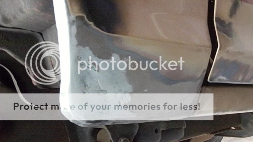

Sanded smooth:

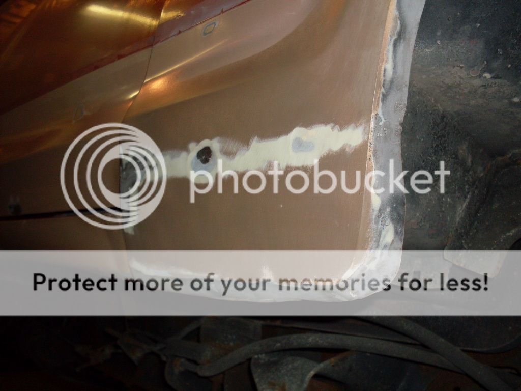

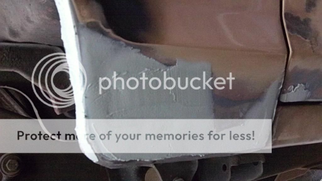

First coat of regular filler: 1 or 2 more coats will be needed to get everything nice and smooth. It's covering paint a little right now but after sanding there should be a nice smooth transition from paint to metal to filler.
