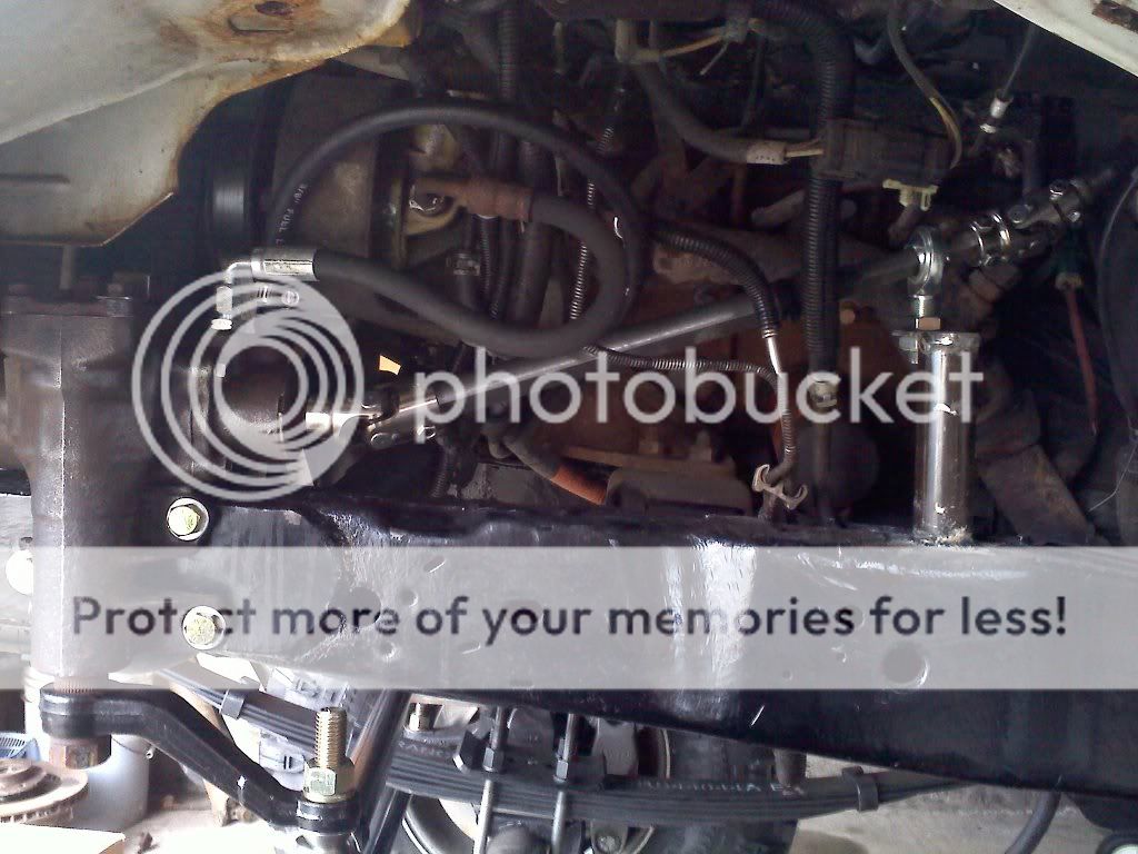

You and me both :icon_thumby: I did manage to get more parts at the jy this weekend though. I got a complete FEAD with new altenator, ps pump, ac compressor with tensioner and rollers from a 97 5.0 ex so i can mockup the supercharger (which the 90 may not be going on the st, working on selling/swapping/upgrading the 90 for a 112)using a spare motor I have. I also got another ps hose so I can get my hydroboost finally done on SVT...
