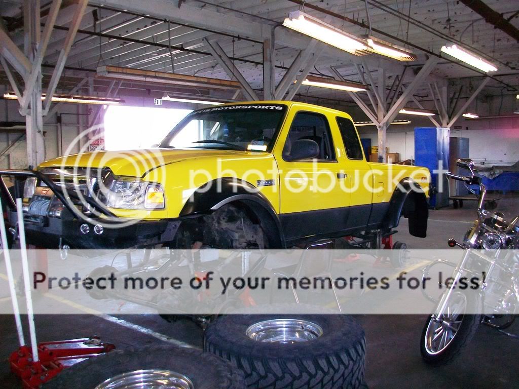

Truck is disassembled. Shocks are sent off. Rear shackle is on the way (thanks Kyle!), heads will be shipped Monday (thanks Bray!), pulling the rear leafs out tomorrow.

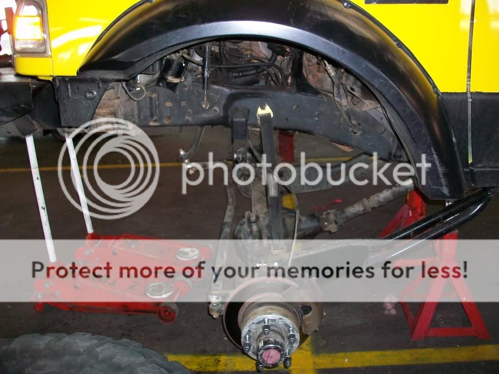

What it looks like without shocks

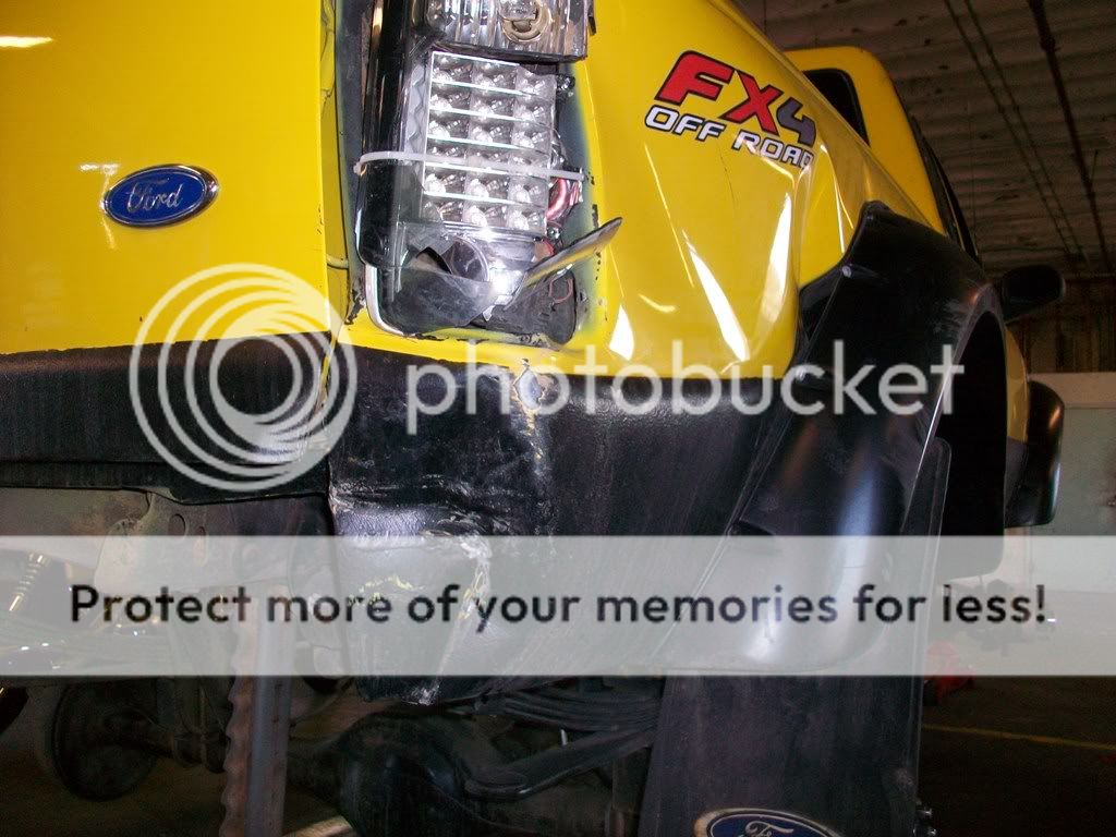

The damage. Still can't open the tailgate. Have to beat out the corner of the bed first.

Planning on using a ball peen once get the crease out of the way of the tailgate. For that, something tells me its going to need a little more motivation. ill try the little fella first, if that fails, pulling out the big guns.
