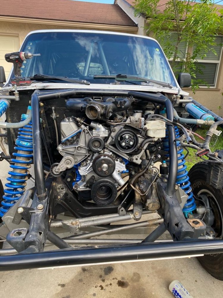

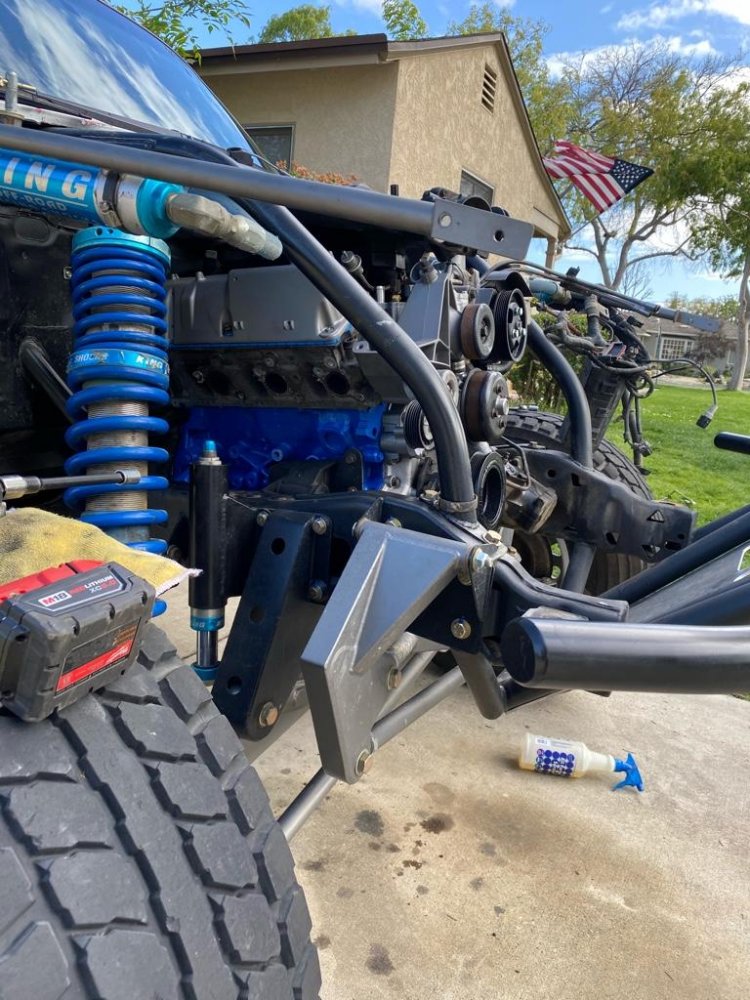

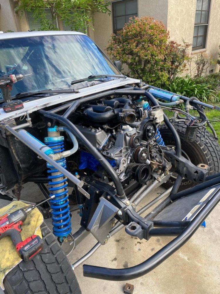

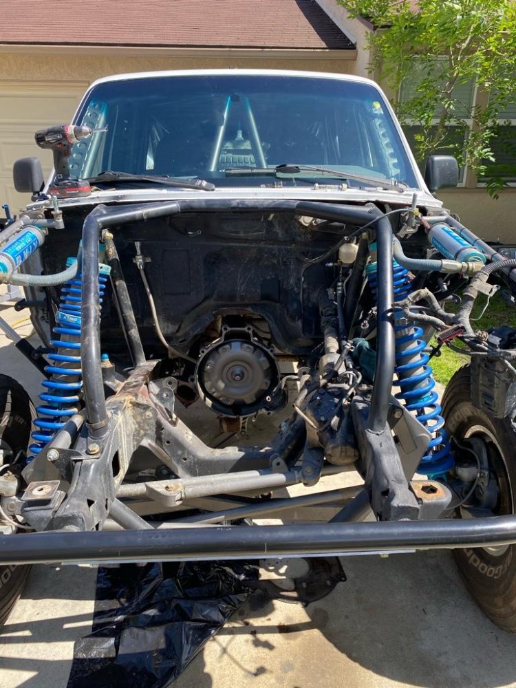

So yesterday I got the sohc in. Everything went relatively smoothly and I realized that I didn’t need to rush as much as I did during the whole process cuz I finished at like 3pm lol. But I did take some time to clean up my frame and paint some areas that were left exposed because of the old engine being in the way when i built everything
Here’s what I gathered so far
The autofab ohv engine mounts bolt directly to the sohc block
Oil pan clears the lower engine cross member with no issues *with these engine mounts*
My upper engine crossmember from my engine cage BARELY cleared the upper manifold but it does fit and I am able to put it on and take it off. So that’s sweet.
I put the ranger back in the garage for now. Waiting for the rain to clear up and I’ll start working on the wiring and stuff
....if the world doesn’t end today Hahahaha

Do the Autofab mounts sit the engine higher than the stock mounts?
back when i had my ohv and these mounts it did lift it a tiny bit. less than an inch.

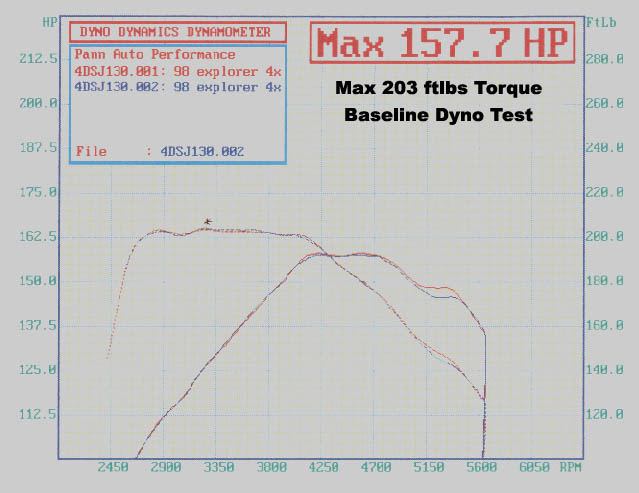

if anyones curious, i put the ranger on the dyno today
nothing has changed besides a sohc swap.
stock internal sohc with gibson headers.
35" tires, c4 trans, and 5.13 gears.
with the ohv it put down 100 hp and 143tq
as i rolled into the dyno on the old OHV tune the truck made 168hp/180tq *note that the programming for the ohv was completely safe to run. it wasnt lean anywhere in the rpm range. so a tune wasnt absolutely necessary
after some adjustments to the computer the final numbers were 179 hp/185tq
*note that the programming for the ohv was completely safe to run the sohc on. it wasnt lean anywhere in the rpm range. so for anyone considering this EEC-IV SOHC swap. a custom tune wasnt absolutely necessary.
to add.
heres a pic of a dyno sheet for a 5.0 explorer completely stock with stock sized tires.:ROFLMAO:
