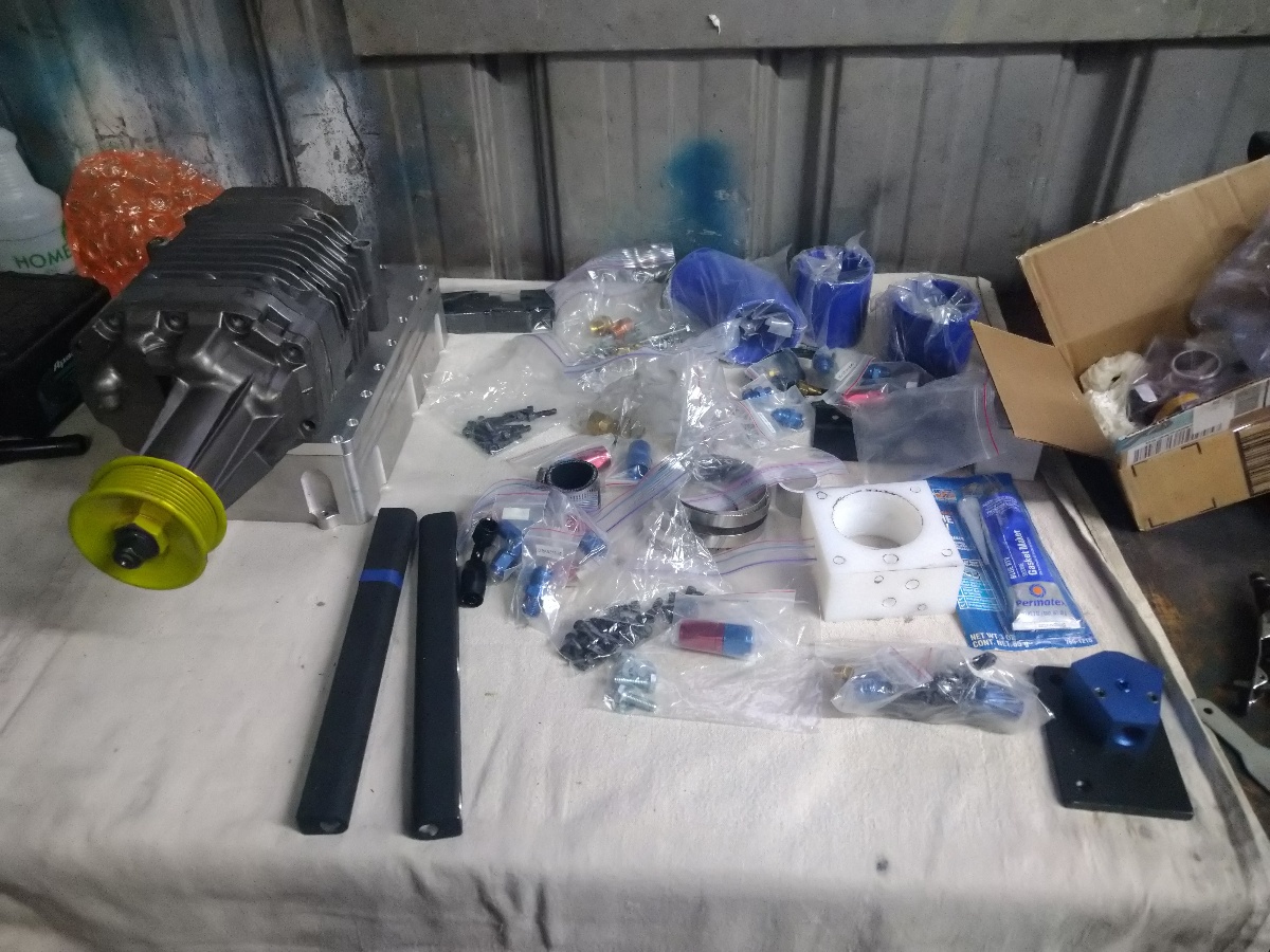

Imagine what it would look like with one of those ModBox super charger kits...
thats exactly what my buddy told me. it will probably never get any boost to be honest. probably.....
$800 all in....
Just sayin...

Your numbers are pretty much inline with what ModdBox shows on their webpage for a stock SOHC (165 HP / 185 lbft), I doubt they were testing with 5.13 gears though. 3.5psi of boost is supposed to get you another 50hp and 52 lbft of Tq to the wheels.
We shall soon see...

BTW. I noticed there is some interest in Eaton Superchargers here. I'm still sittin' on my stock 2000 Lightning Eaton if there is??
