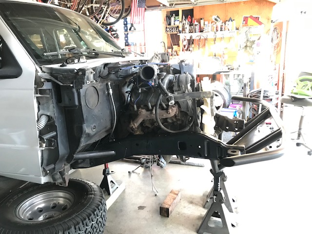

started off with cutting EVERYTHING off the front of the frame. old engine cage and all. decided to switch over to manual brakes so i can lean my shock back as far as possible and get good motion on it.

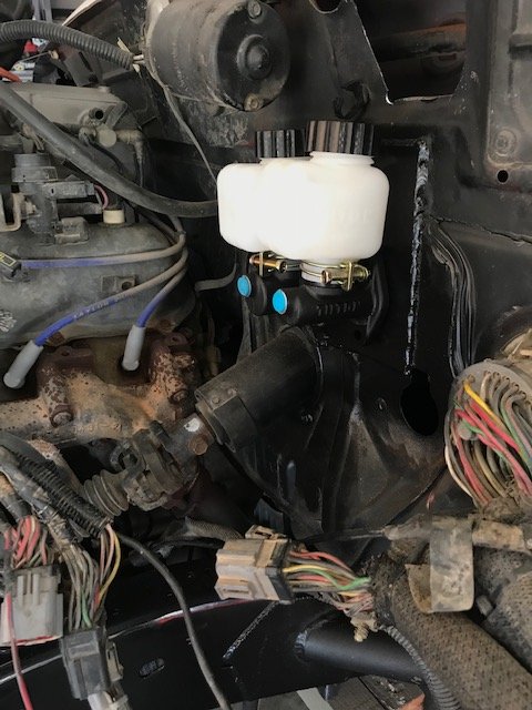

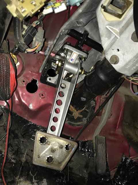

i managed to mount a big pedal in the "factory" location while still utilizing the big aluminum steering colum mount SCORE! and will be using dual tilton master cylinders to contol braking (hopefully)

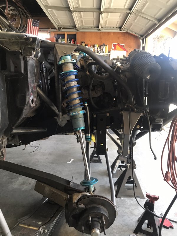

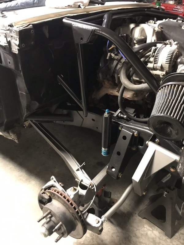

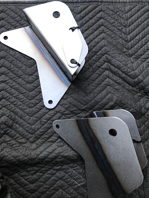

next up is mounting new suspension components. first will be attaching the new pivot brackets for the radius arms and the beams! heres the radius arm mounts
29908

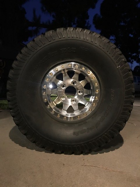

also, per gf request, i sold my harley so naturally i treated myself to new beadlock wheels =]

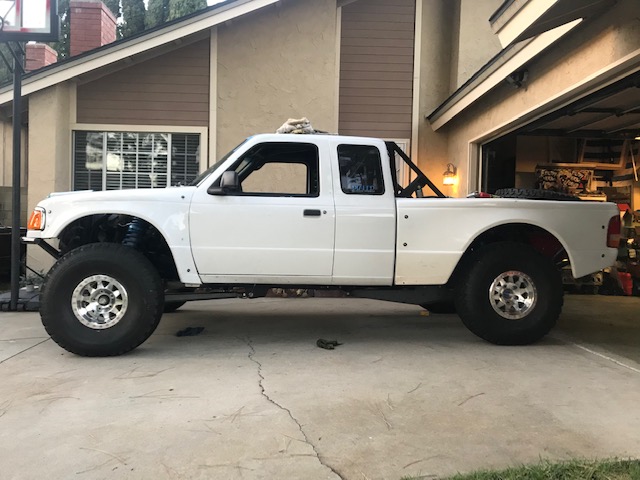

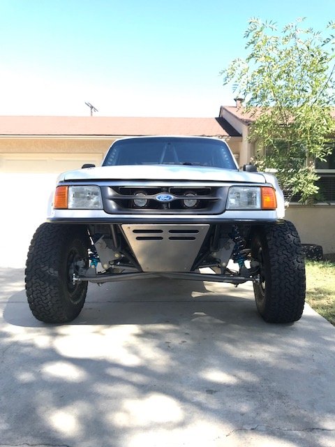

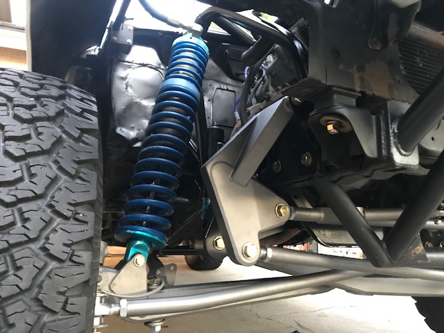

finished the truck!
heres some pics
