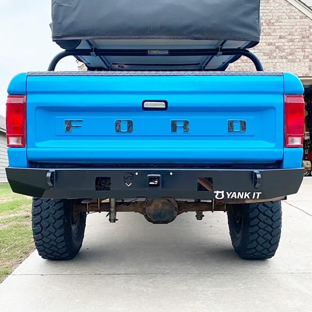

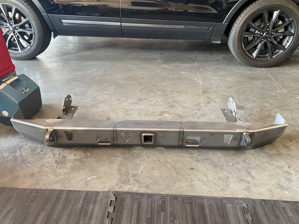

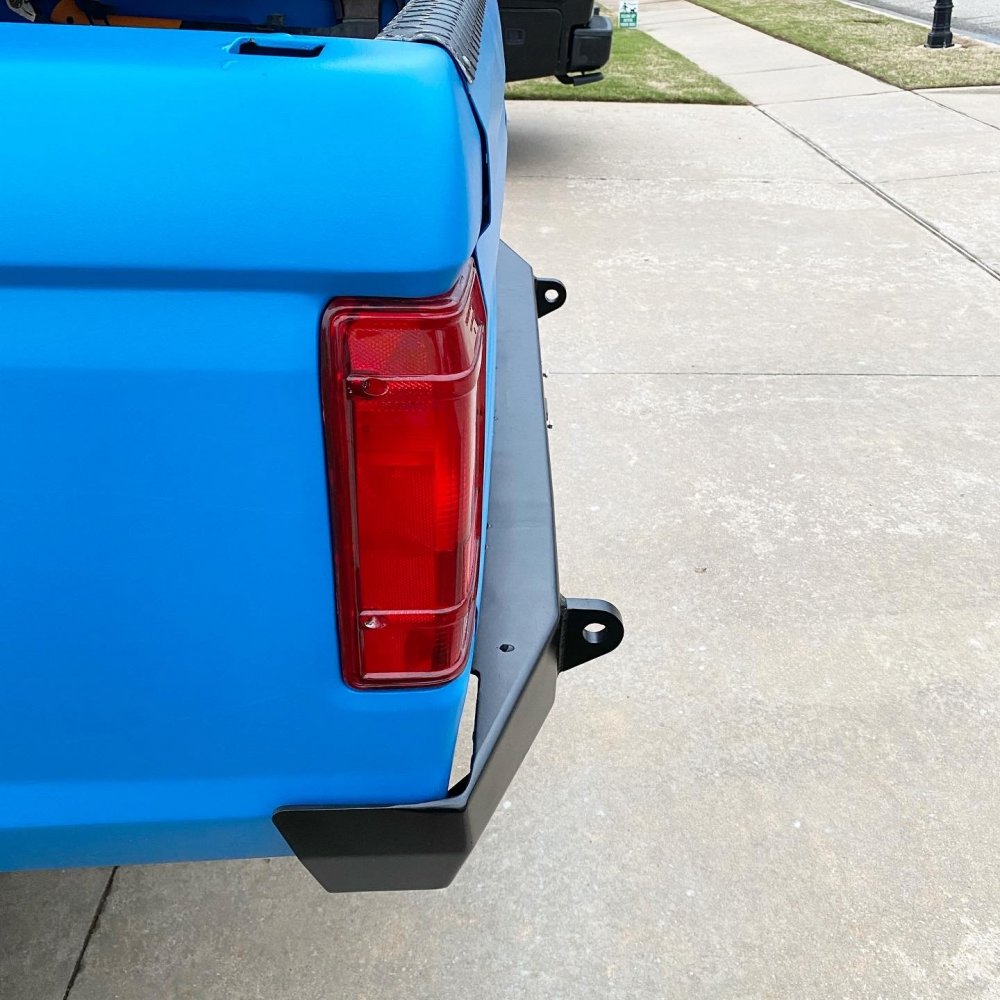

I took on the challenge to modify a Jeep Comanche bumper from JCR Off-road to fit the 1st gen Ranger.

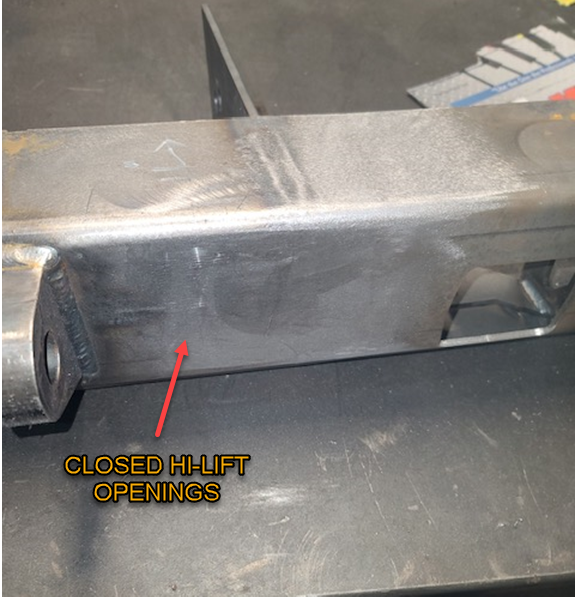

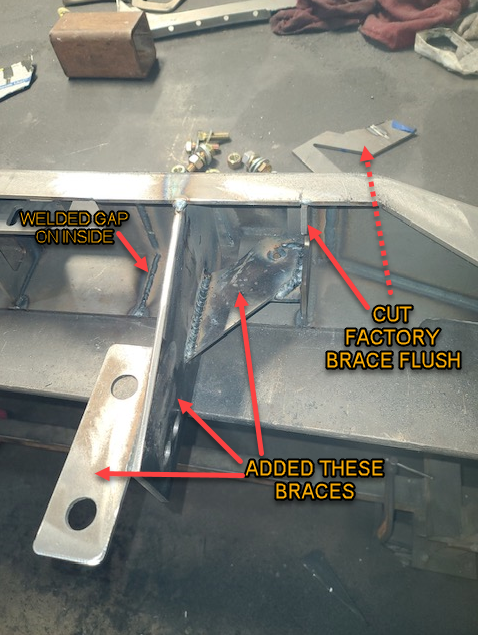

This required cutting 2-3/4" out of the Comanche bumper to fit the width of the Ranger. Next I removed the bracket and adding new brackets to attach to the Ranger frame. The new brackets hit in the middle of the JCR Hi-Lift triangulated cut outs. This required them to be deleted which did not bother me.
Now I need to add pod lights and and a flip up license place so that I can utilize the receiver hitch on the fly.

Badass. Looks awesome...
Now you need a 2019 rear diff upgrade and a skid plate....
My actual winch plate is off of a cherocar
Whoa!
Nice work! Let's see the rest of the Ranger!
Nice, is there a custom drop hitch? It would look extra badass...
That looks awesome! Need to clean up that rearend and that booty shot would be awesome!
yes I didn't notice how bad the rear axle looked until I started taking these photos! lol :LOL:
Nice looking truck...
