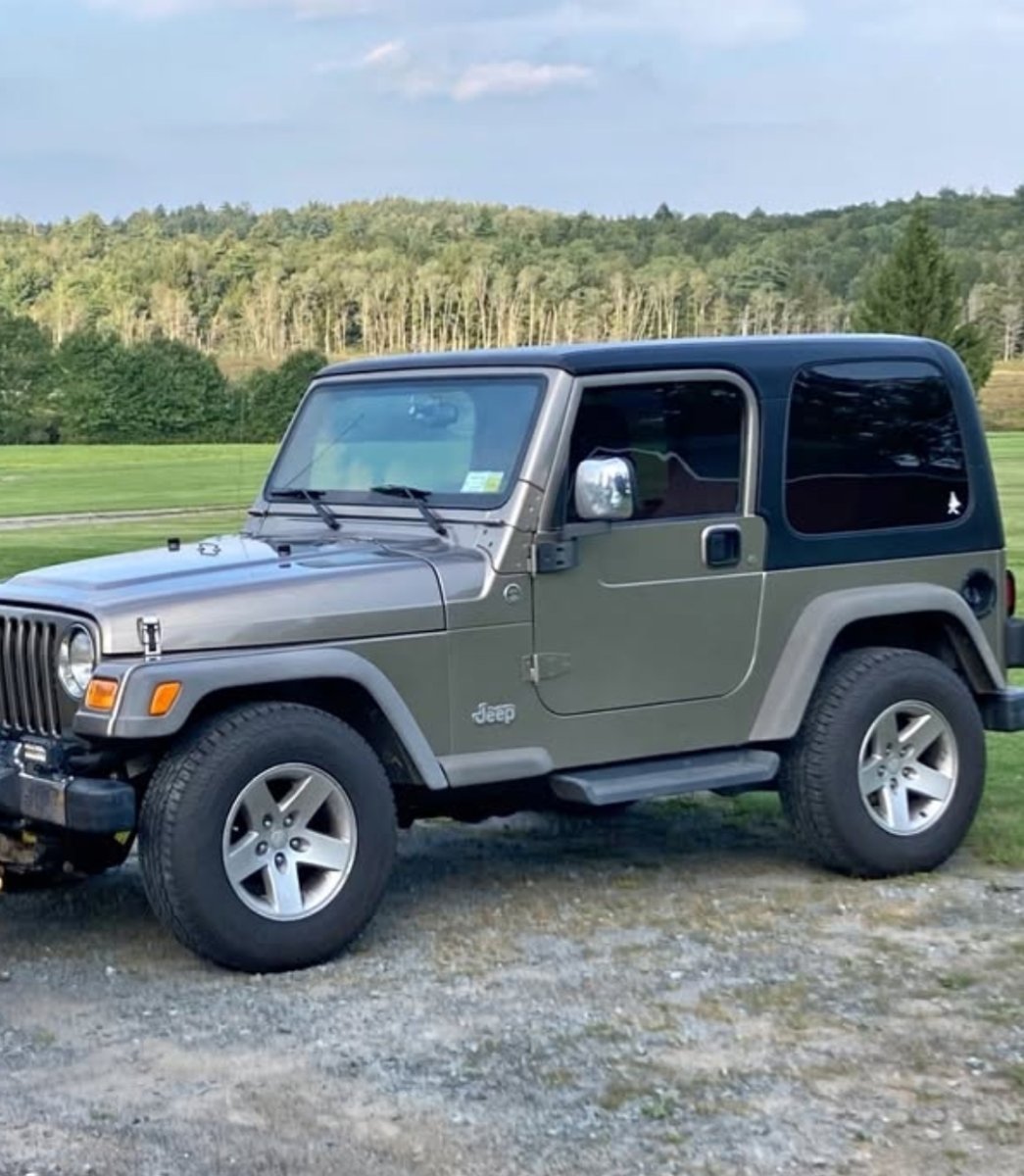

I know it's not a Ford, but I'm picking up a 2005 Jeep Sport Saturday. It has 16" Rims. Does anyone know the largest size tires I can put on it without any steering or clearance issues. Thanks
"how big" also needs the rim width regarding matching tires to wheel rims.
during the course of normal driving wheels need about 4" of room to bounce up.
the pictured Jeep is close to that limit.
that's a valid reason to justify buying lift parts, lots of parts .:icon_thumby:
Based on the picture, it's pretty much maxed out without lifting.
