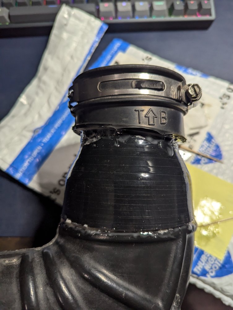

Finally worked up the effort to attempt a more permanent fix on the throttle body end of my intake tube.
Before:

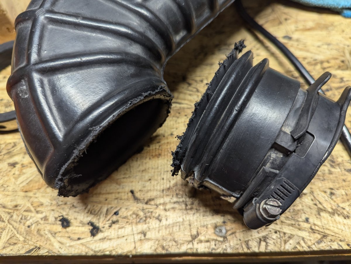

I cut the TB end off of a 2000 4.0 intake tube. However, I didn't measure very well bc it didn't slip over the old intake how I was hoping.

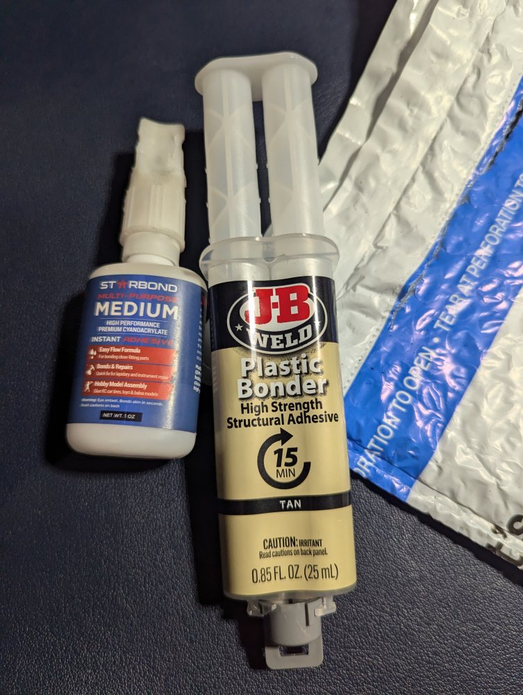

So I got a 3.25" to 2.5" turbo coupler off Amazon for $10. Used some slow set super glue to glue them into place, then followed up with the JB plastic weld
Will cover the plastic weld with some flex spray for some extra protection tomorrow. It doesn't look as bad as the aluminum tape at least!
I think if I had cut a little further up on the donor tube it would have been able to slip on like I wanted it to in the first place.

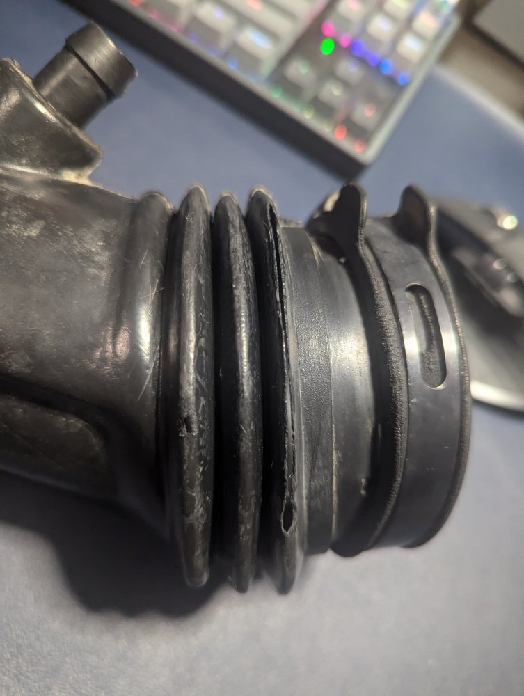

First time working with flexseal. I wish i had worn gloves. the stuff gets everywhere! glad i went overkill on the trashbag spray area and it's just all over my hands lol.
i shoved a shop towel into the inside of the broken part of the air box side. it only has one bad crack and with the shop towel on the inside of the crack I hope that the flexseal will form just on the outside... guess we'll see!

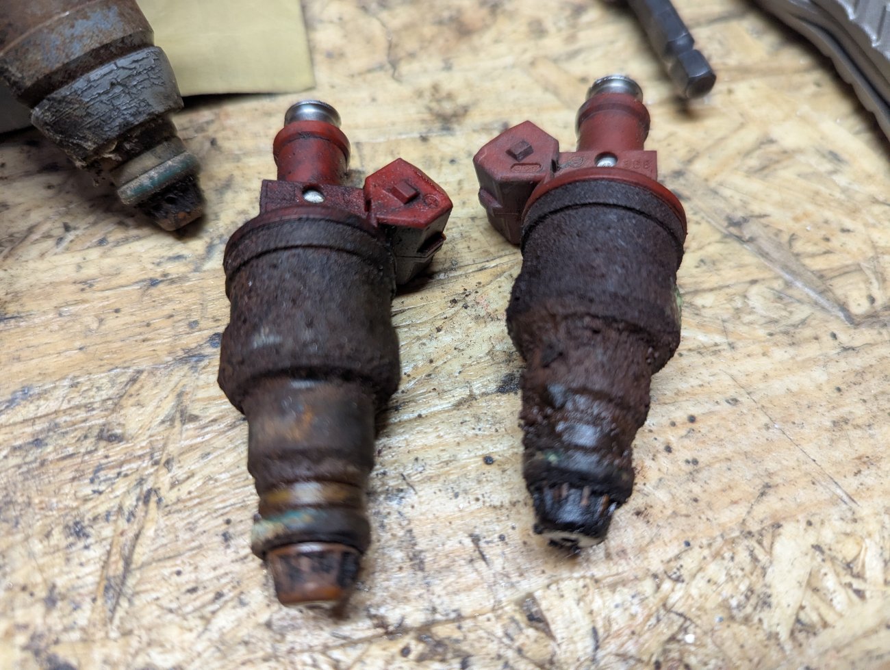

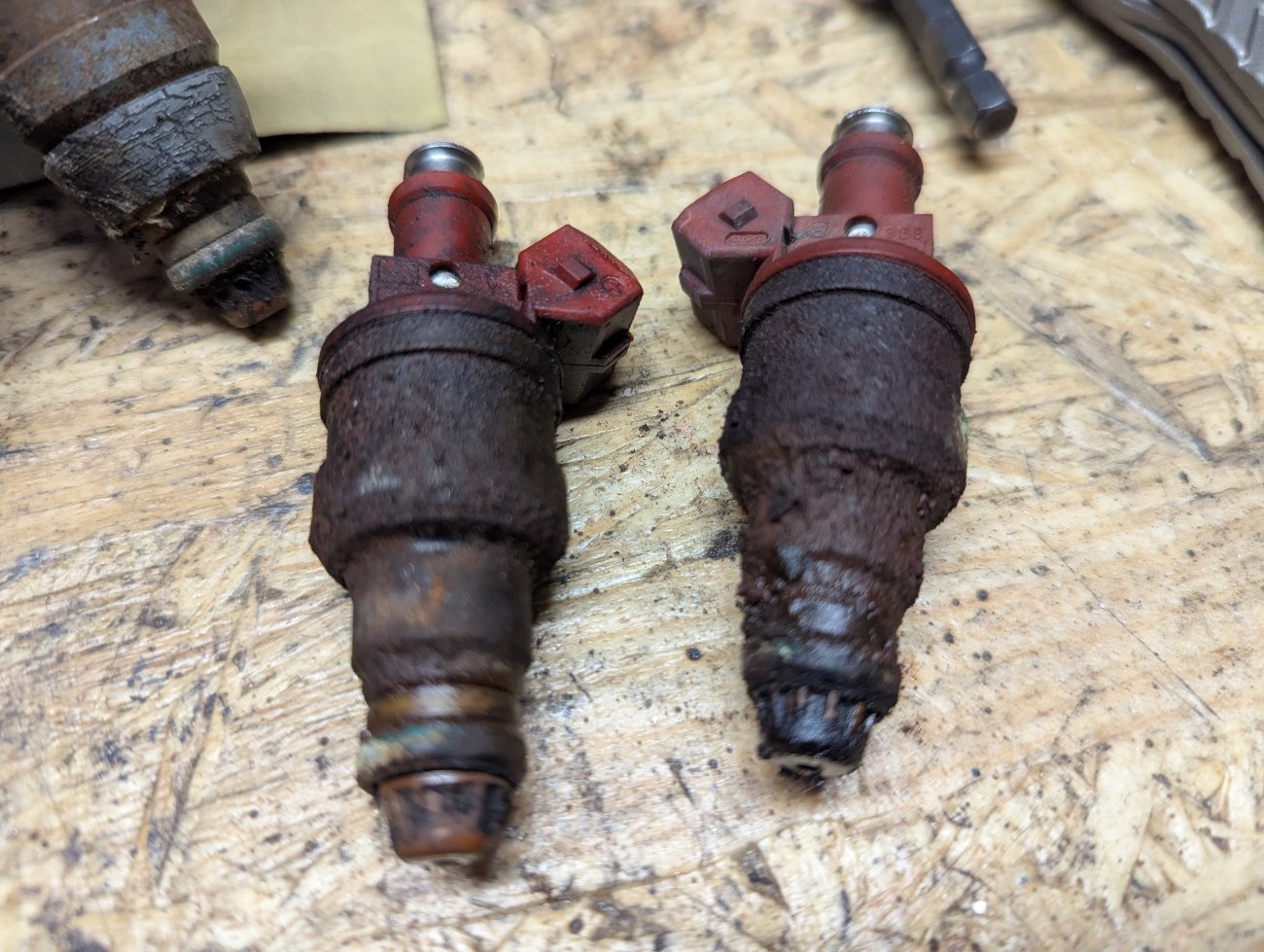

Temperature warmed up so it's nice enough to work in the garage. Figured now was the right time to replace the fuel injectors.
Broke about half the clips on the injector plugs and then removing the fuel rail and injectors was tougher than I thought it would be. The two on the front passenger side remained in the engine once the fuel rail finally pulled free.

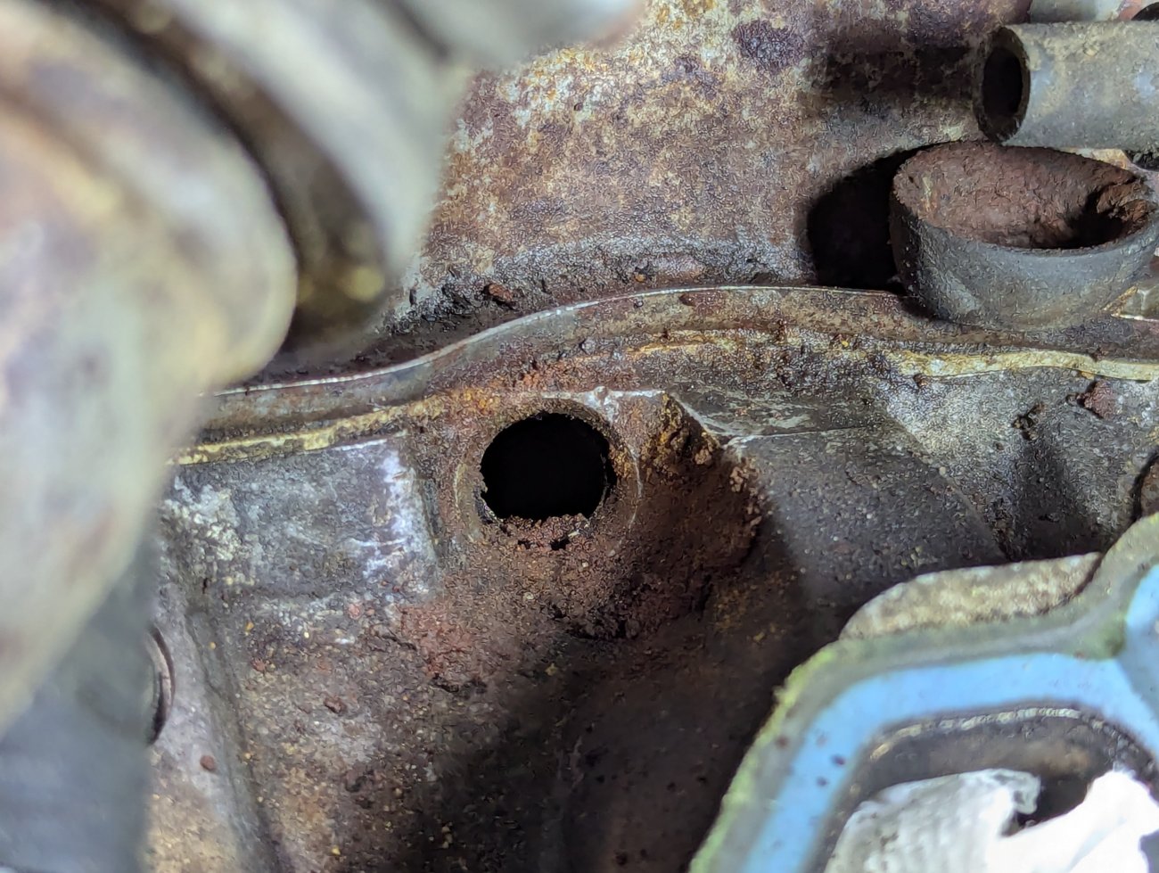

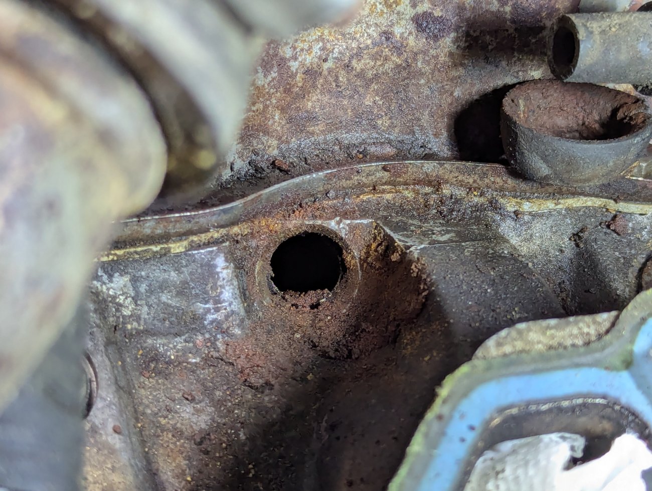

Twisted them out with pliers, they're pretty chewy. Bunch of nastiness right where they go into the engine that I had to vacuum up.

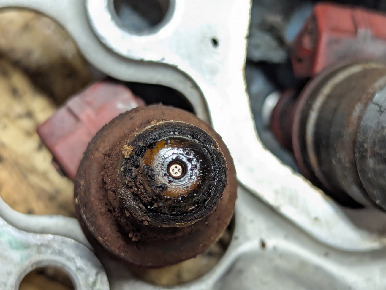

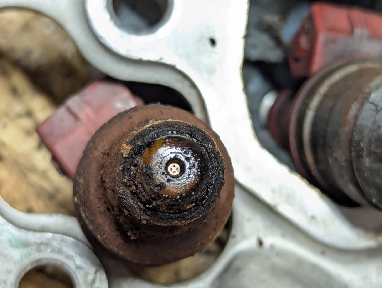

They all looked pretty rough but the injector end was pretty clean except for one which looked at least partially clogged
Twisted them out with pliers, they're pretty chewy. Bunch of nastiness right where they go into the engine that I had to vacuum up.View attachment 123024
