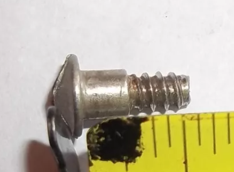

No hub cap screws, but I may have a throttle body cable.
I’ll look when I get home from work this afternoon.

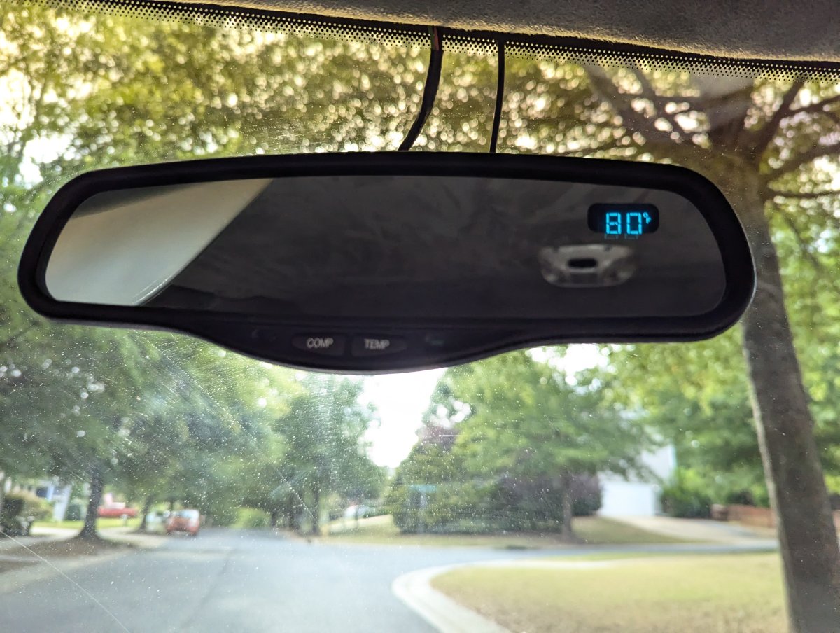

Snagged a auto-dimming mirror with compass and temp from a 99 Tahoe today. Looks pretty good. Larger than the OEM rearview as well, nice for these old eyes :icon_rofl:
Teaching my oldest son to drive so I'm in the passenger seat.

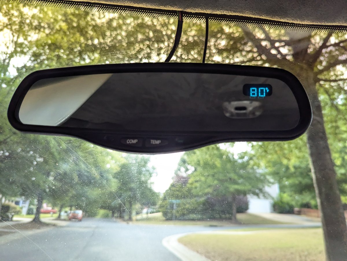

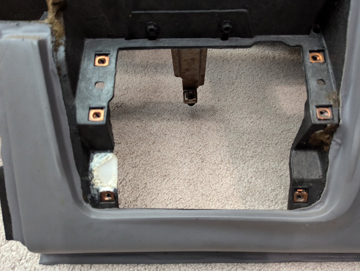

Picked up a dash from a 94 at the yard that's in much better overall shape than mine. Gives me the chance to refurbish it with less urgency
Jballard81's 1994 super cab 4.0 4x4 Restore
I'm going to try and be good about grabbing pics during the different disassembly steps and refurb steps. Will try and do a write up once done.
Some plastic was broken off in the ashtray area, so printed a 2mm thick rectangle and melted it into the approximate shape.
Took out the vents and soaked them in degreaser. They cleaned up pretty well. Really more to get the experience removing them so I don't break them when I remove them from my original dash. I'm eventually going to bed line the dash and then respray it as close as possible to the original grey. Will probably need some practice to get the vents right with all the nooks and crannies.
