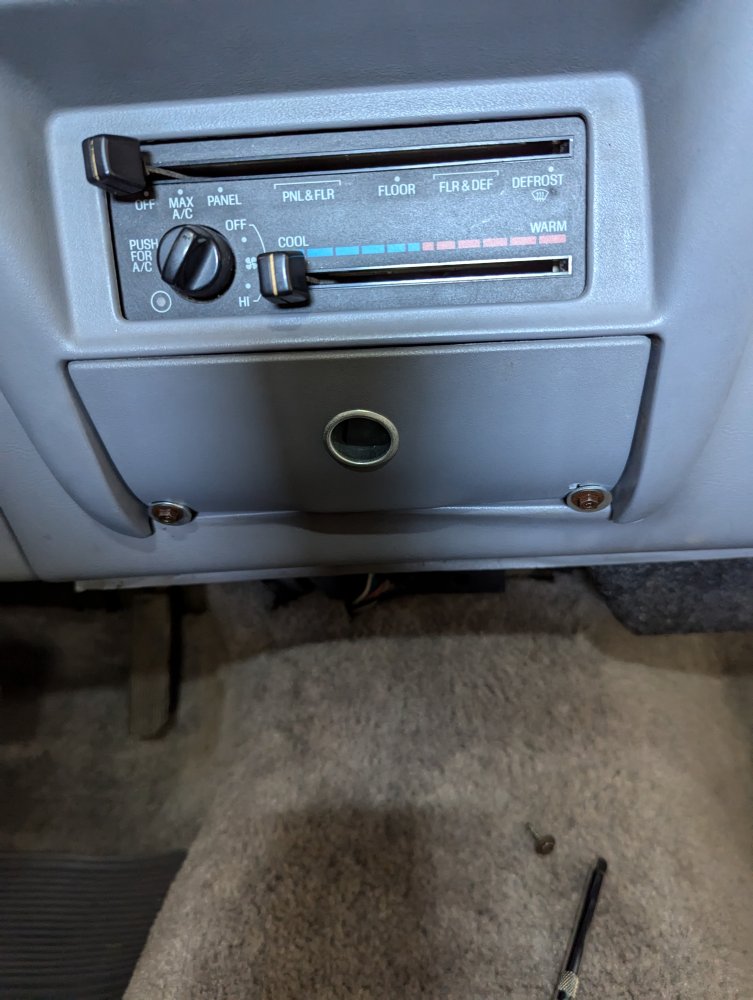

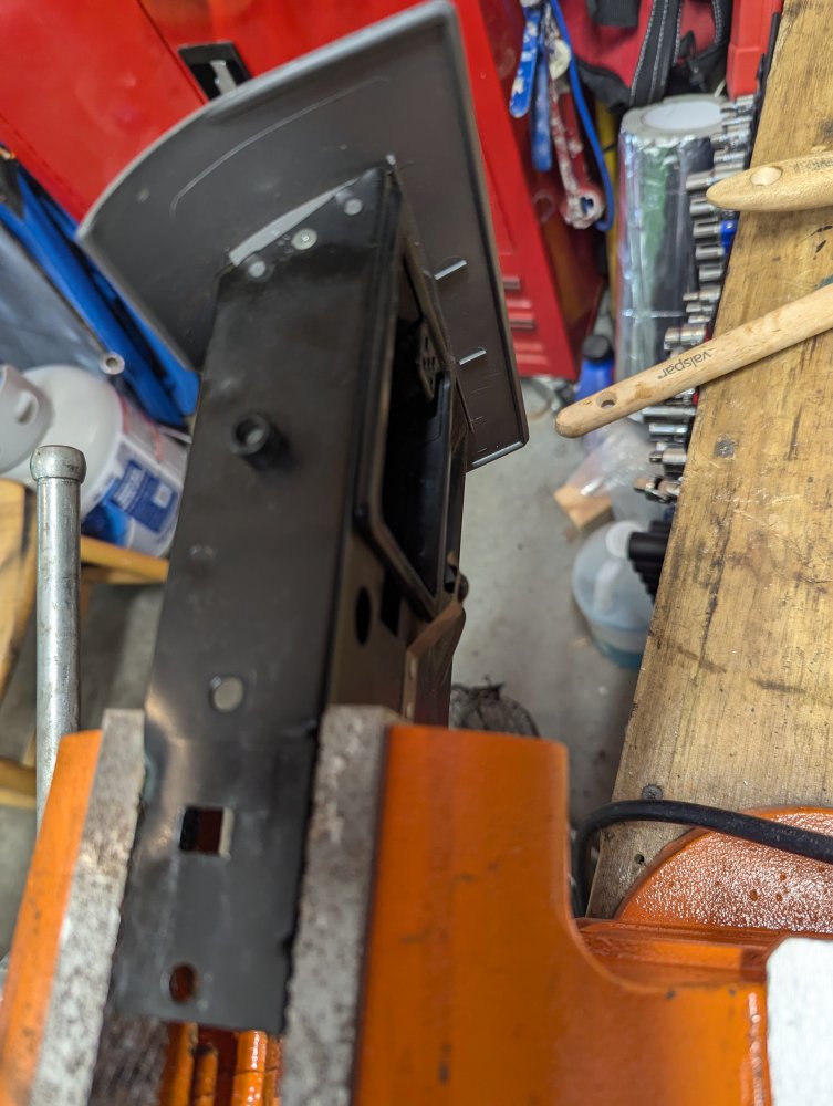

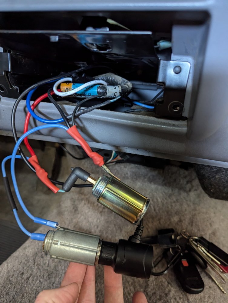

Small electrical project today. Took apart the old ashtray and 12v socket and modified it so that the cover plate can go back into place, but with a 12v socket installed I to it.
My wiring looks kind of like a rats nest, but I wanted to have a second 12v socket behind the plate so that I could keep my dash cam plug original (otherwise I would have cut the dash cam socket off and spliced it in)
I should have spent some time figuring out how to reattach the plate without drilling holes in it, but it's good enough.

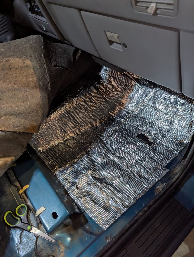

Started adding some duct insulation to the floor pans to help with the heat from the exhaust. Passenger side first. probably do the driver's side tomorrow

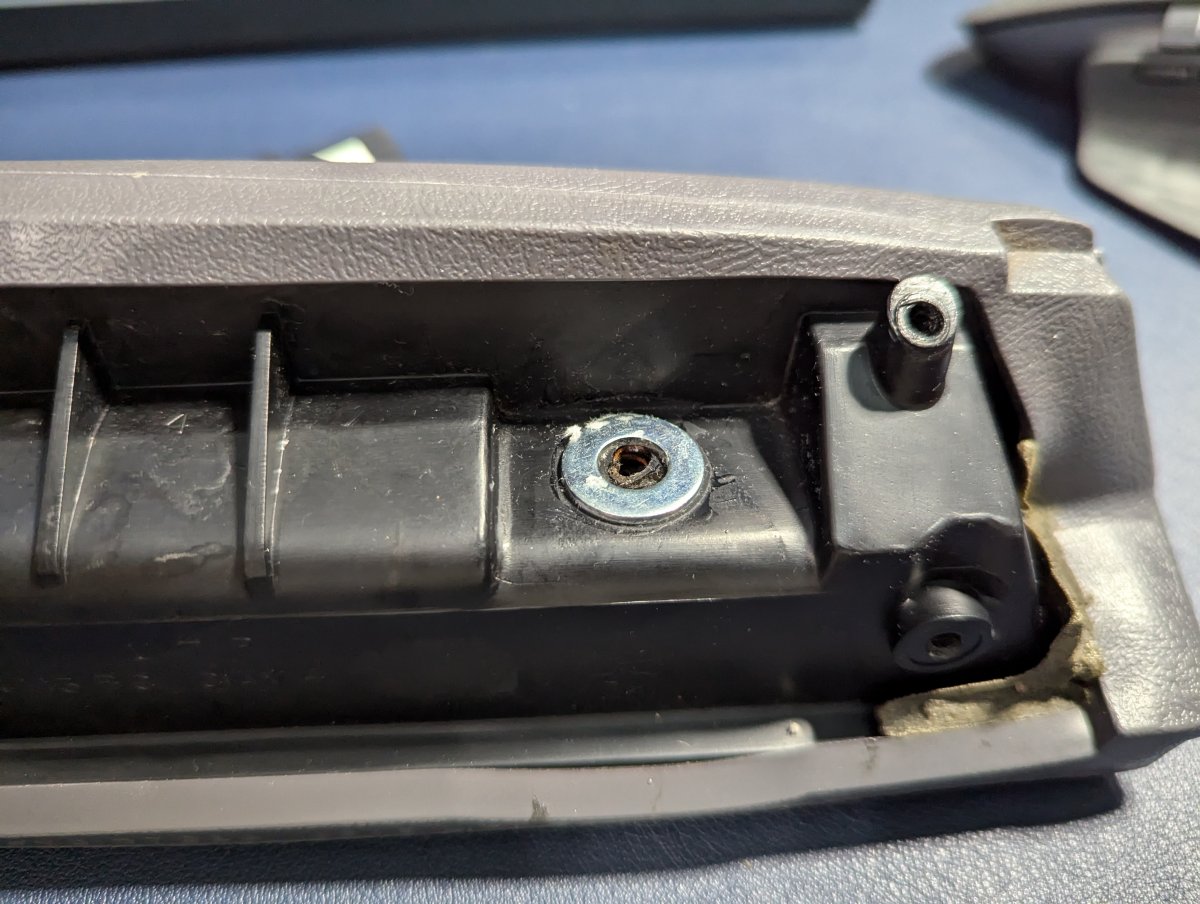

Boneyard had two 94 rangers today. Both had very good shape driver's side arm rests!
In an attempt to help it last longer, I super glued a washer to the plastic to reinforce the area that the screw goes through in the handle
This is the 'best' of the two I got. The other one already has some cracks in the plastic there. I will add a washer to that one as well as a backup.
