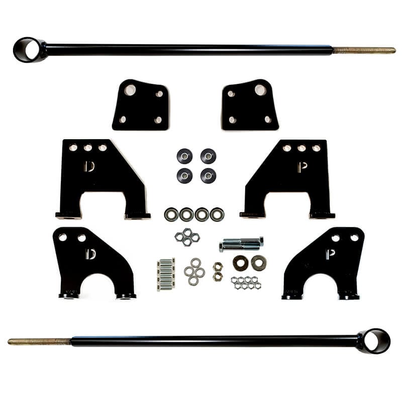

It might be good to add a note that Duff does now build a kit specifically for 98+ trucks, product code 5306
Article is good to show the differences between the two kits though.
I may inquire at some point if they will kitbash and sell a "kit" with the older front brackets and the rear brackets for a 31 spline 8.8 (which is included in the 98+ kit)

I have them on my 2011.
Worth the money.
The 98+ kit fits the 2011 with the Bronco brackets (included). 2009-2011 ranger uses a 31 spline 8.8 tube with 28 spline axles.

My situation is a bit different than @85_Ranger4x4 - 1750 lb springs, late model low profile blocks, lift shackle, 4° axle wedge, B2 2wd sway bar. But, they help a great deal.

The earlier kit has a different front bracket and only comes with the smaller axle bracket.
