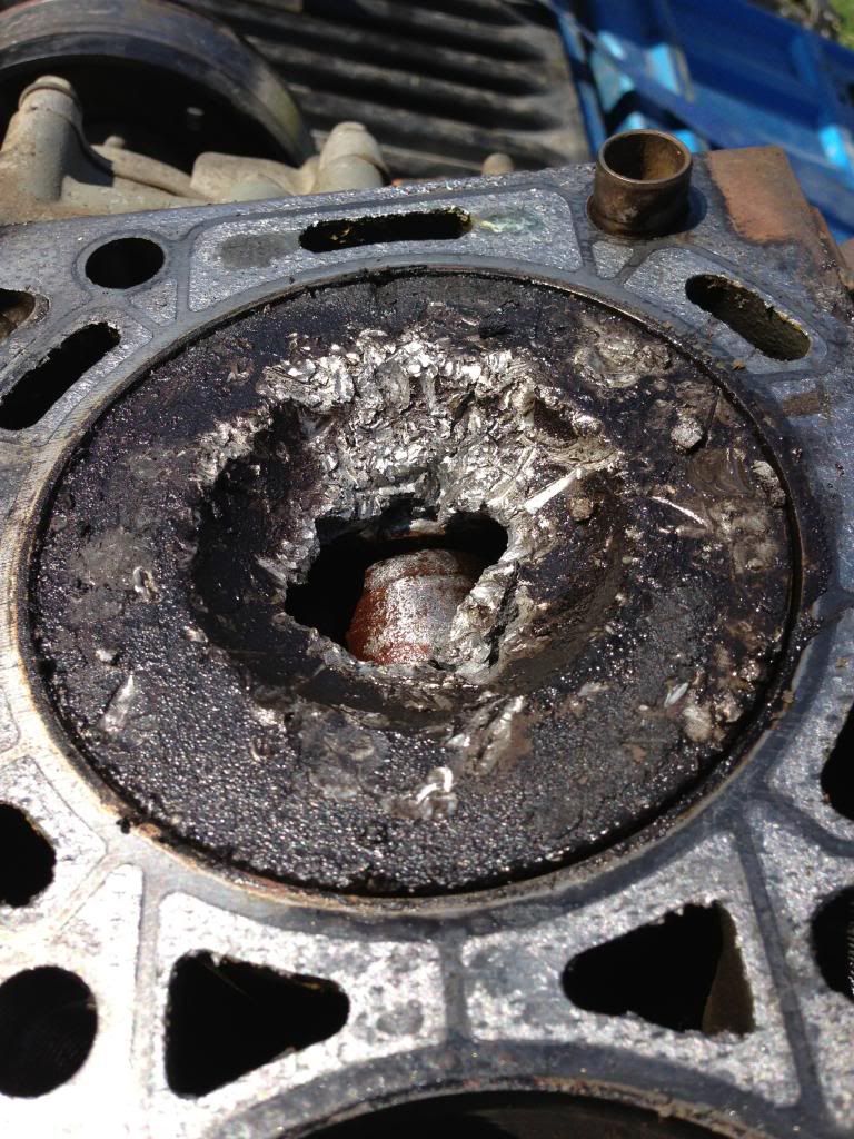

since then I hydrolocked my first engine(totally didn't remember where the stock air intake was in the heat of the moment lol). Lesson learned. So alas I obtained a engine from a friend. installed it in my truck with the help of my brother and drove for about 3000km's and then that engine randomly dropped a valve.

As noted about the second engine I went through :icon_twisted:

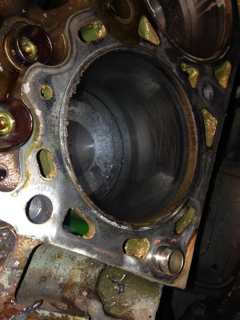

So this evening I preceded to tear down the engine to the short block and see what how it looked.
Much to my surprise the heads looked to be in AMAZING shape and the pistons aside from some carbon build up looked good, there was actually still crosshatching on the cylinders.Its business time.
:yahoo:
This make me happy cause it tells me that there was perhaps less km's on this engine then the donor trucks odometer showed? not sure what to think.

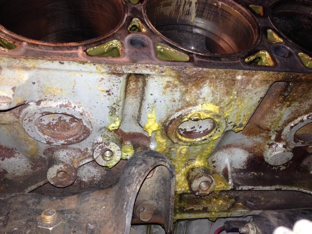

Here is a pic of the messy coolant leak.

So now that I am down this far I need to find out some things before I throw it together again as I want to throw one of the Comp Cams cams into it and do some gasket matching to open things up a bit. definitely throwing a 3 inch BL on it. finish the exhaust and who knows what else. I have also replaced the transmission with a M5oD-HD recently as my stock tranny had a bad second gear from the day I bought it.
