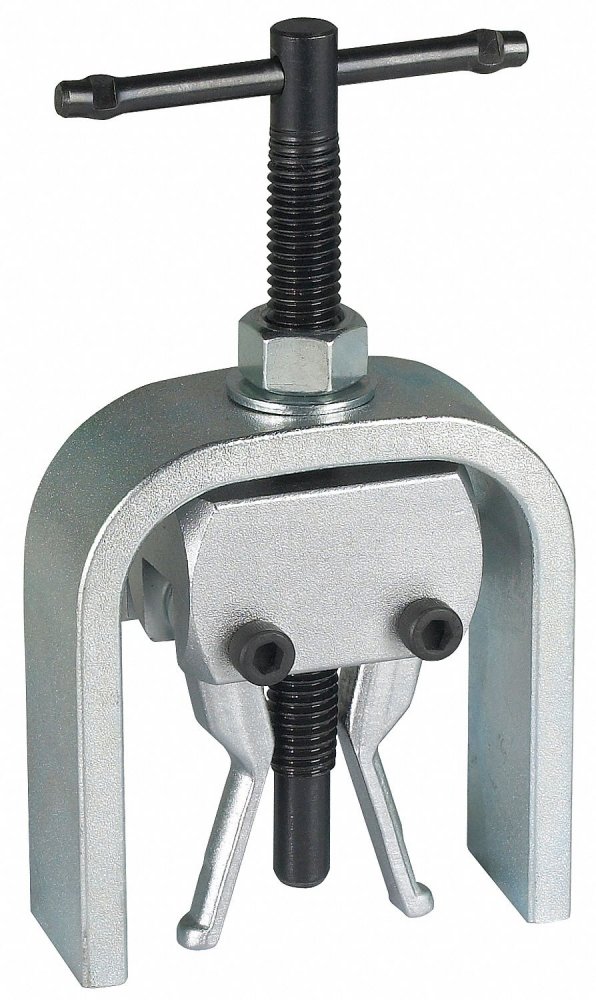

I use an actual pilot bearing puller. They run from $20-$100 bucks and come in different styles and sizes. This is the one I use most often.
