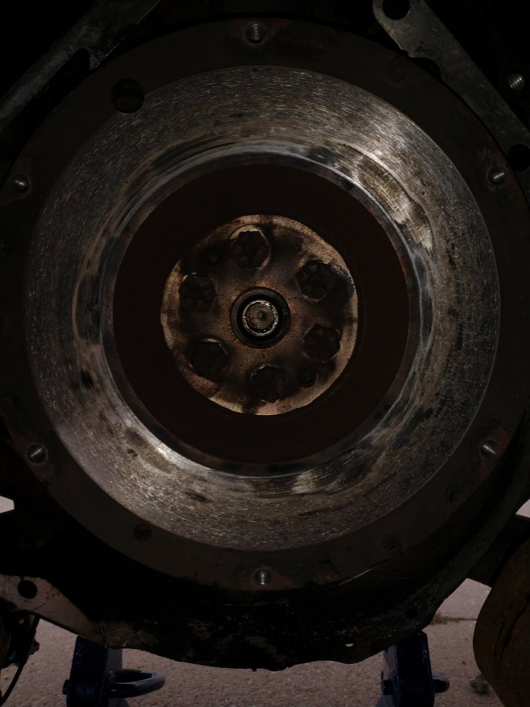

All those spots on the clutch face are "hot spots"... the disc itself also appears to be glazed over in one of the photos. Means clutch was or had been slipping.

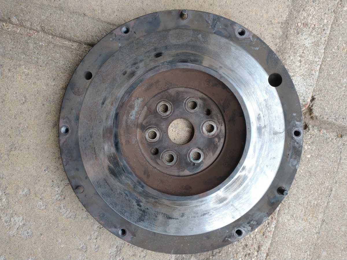

post a couple good pictures of the flywheel too.
Are you replacing the flywheel or plan to have it resurfaced?

RonD said it should be smooth like rotor. It is!!! He said some discoloration is normal and there is a lil but not much I see. I believe it is all good.here are pics. Some with flash some no flash. Thoughts?

Defiantly been slipping... you need to have it resurfaced or replace it.

yeah, the surface of that flywheel is shot, if there is a step from the shiny part to the dirty part that isn't helping the clutch engagement, I had a flywheel wear out once before, it was a cheap chinese replacement...
