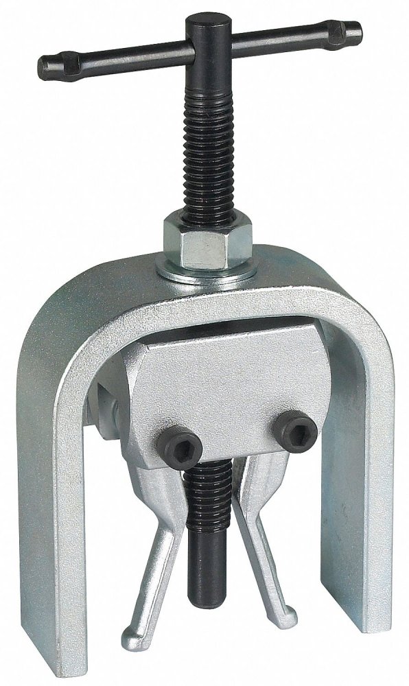

I've done the bread trick a few times but your local auto parts store should have a pilot bearing puller for rent.
A note on that HF slide hammer. The thread size is weird, it only works with that set of pullers and vise Versa. I didn’t find any other slide hammer or pullers that matched that size.
So if you buy that, and want a new type of puller later, you will also need a new slide hammer.

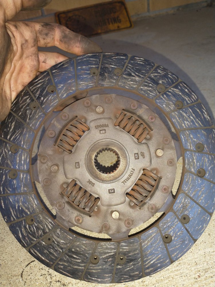

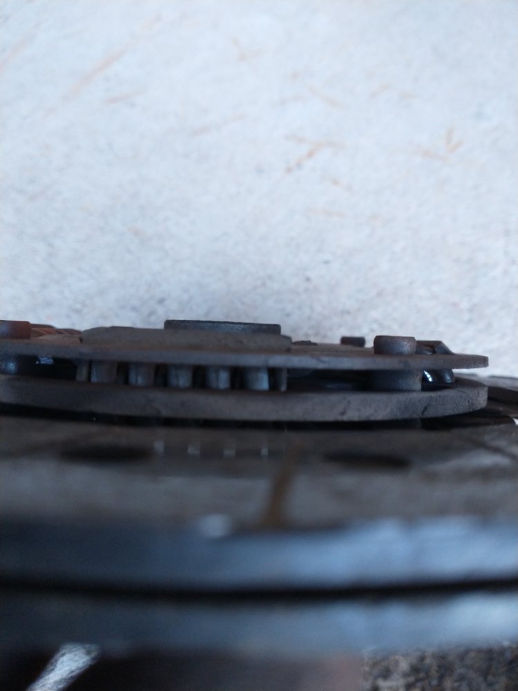

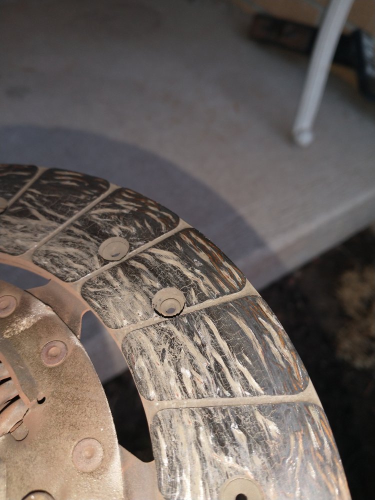

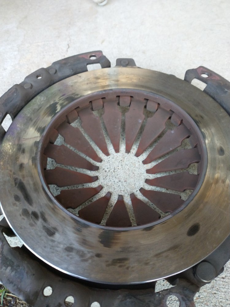

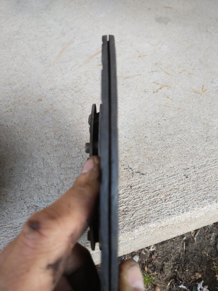

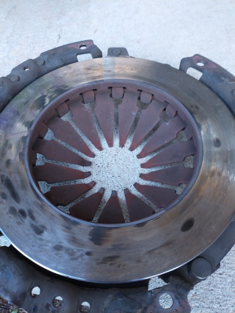

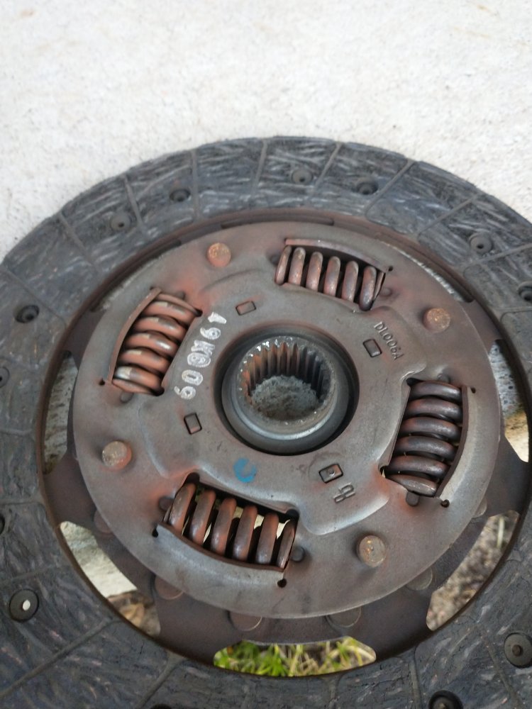

Don't laugh I'm sure I took unnecessary pics but I don't know what to look for. Just want you guys to look. Look ok? I don't see a reason why it wasn't working,but again.....I know NOTHING!! LOL
