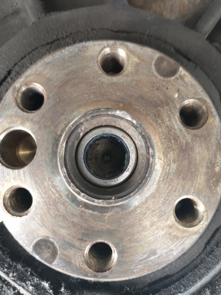

Is this normal?
yeah, the surface of that flywheel is shot, if there is a step from the shiny part to the dirty part that isn't helping the clutch engagement, I had a flywheel wear out once before, it was a cheap chinese replacement...
There is no step up. Thank God!!! I took it in to be resurface.
Isn't that lovely. He said it wasn't bad didn't even take off ten thousands.
That's good news... and you at least have a nice fresh surface to put your new clutch up against.

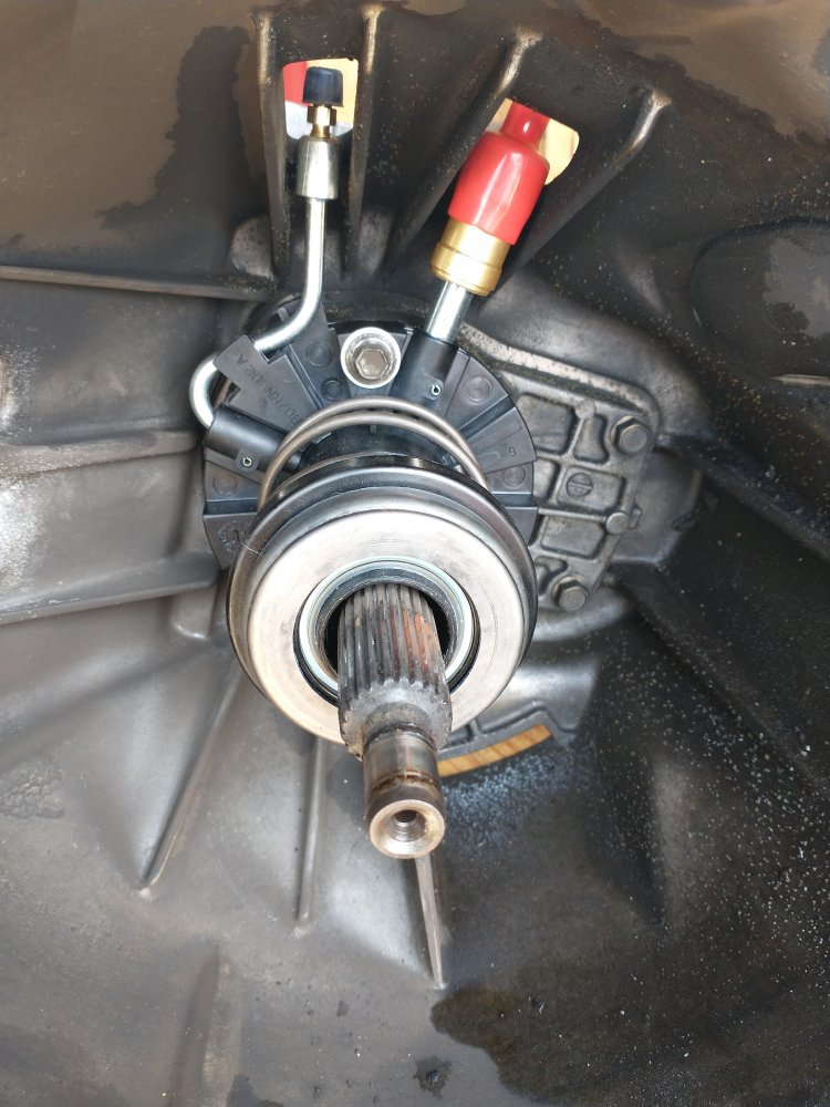

No grease on throw out?

Pilot in hopefully correctly
