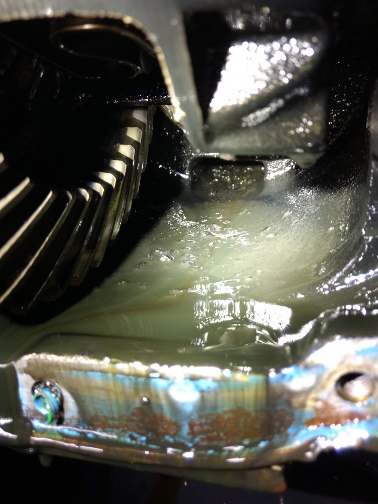

Fast forward to this weekend when I opened it up. I approximated that maybe 1/2 a cup of diff fluid came out. There was some silvery specks in the oil so obviously something let loose, and I found small chunks in the bottom of the case. I'm guessing at minimum I smoked the bearings, but I also need to inspect the ring gear and clutch pack more closely. Someone has been in the diff previously because the huge amounts of blue RTV that held it on made it interesting to get the cover off, plus the bolts came out with RTV on the ends.
