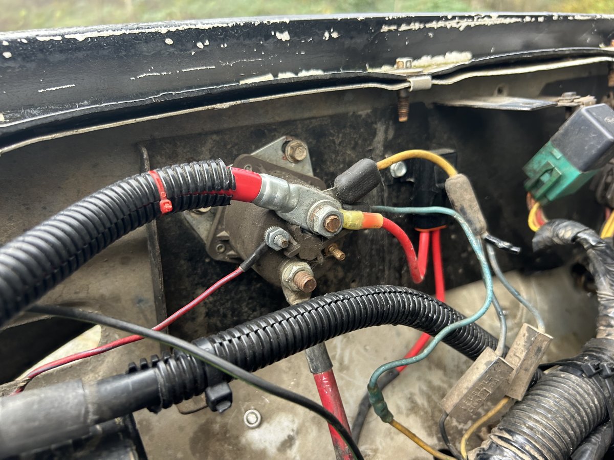

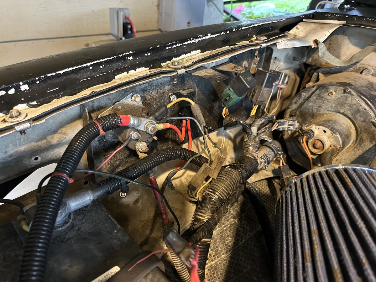

I’m having a tough time seeing the ground wire here. I’ve tested the power to the top post which comes from the positive on the battery terminal, getting 12.6 volts there. The left small post I tested with the key in the run position, I was getting 12v there. The bottom post where it goes to the starter itself I was getting 7volts. Does the solenoid not ground out to the fender? I’ll attach a photo of what I am looking at. Last night it wouldn’t start, this morning I didn’t touch any wires just tested them, and it fired right up. Moved it around the property a few times, tried turning it off and would fire up no problem.

I know the wiring looks pretty messy, it’s been a long work in process. Previous owner did some weird things under there.
I'd say your thought on grounding to the fender is accurate. As close as that is to the battery, I'd pull a wire directly from battery ground to one of the screws holding it on. See if it helps.
Okay I will try that out later as I need to head to work soon. what gauge wire do you figure would be best to run there? I do believe I got some 14 and 16 gauge wire kicking around.
The solenoid does ground to the fender through its mounting screws. You want to make sure that these are tight, and clean up any corrosion.

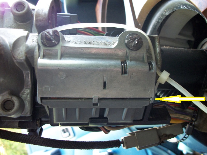

I agree with rusty that you have classic symptoms of a bad terminal/cable . The next likely culprit would be an ignition switch that's coming apart; there are several posts here on this that can be searched out, which shows how the switch separates, so that you know what to look for.
If it were me, I'd remove, inspect, clean, and reinstall all of the cable connections at the battery and solenoid (relay, actually), and check the ignition switch for separation or signs of overheating.

What should I be looking for exactly on the switch when it comes to over heating issues?
Overheating; evidence of melting, on the plastic connecter parts and/or the wire's vinyl insulation; brown coloration of either.
Ignition switches, especially first-generation trucks, tend to loosen up with age and come apart at the seam where the two parts are crimped together (see arrow in picture):
