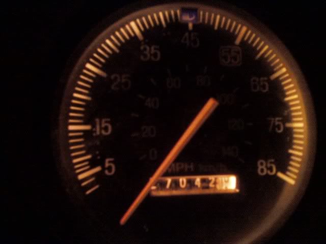

How many led's would i need and what would i have to do to make all the lights( including heater controls) a nice intense red an my 85 Ranger? Also if any one has pics with the red lights i'd love to see how it looks :shok:.

I bought just the regular LED bulbs and they worked out fine in my dash (1987)
How hard was it to take the guages out and switch it over?? Can you give me a play by play?? I'd like to do this to my 87 and get rid of that crappy green hazy crap that came stock!!
