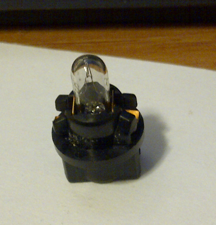

Ok so dash apart, there is a "Toshiba V2" plastic twist housing. From what i read online, it is a housing and the bulb should pull out.
Here is what it looks like:
I can only make out this info on the bulb itself:
14v and possibly 1.25w not sure its rubbed off.
ANyone give me any sort of info on this?
Pulled out some other bulbs, I managed to get TSD 6
if you looked at the bulb from top down, reading left to right, the markings are as follows
TSD 6
14v1.25w . 5
I have NOT been able to find out anything about these bulbs. ANy help would be appreciated.
