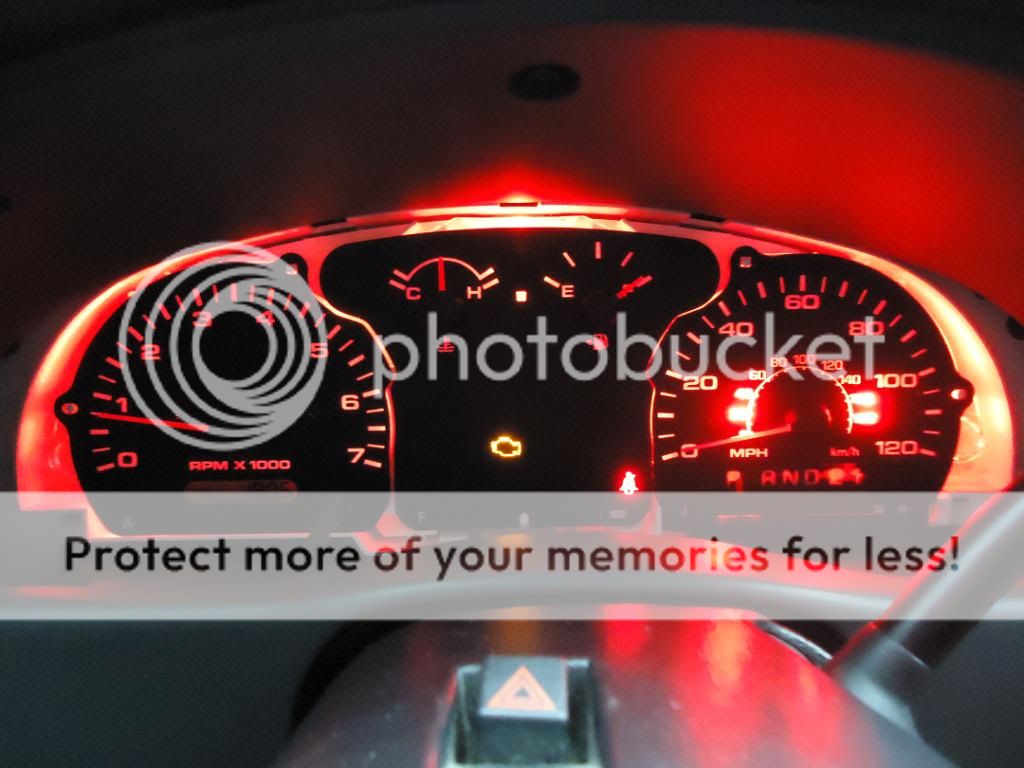

@DangerRanger love the red! finally some good pictures of the red leds. just ordered mine a half hour ago

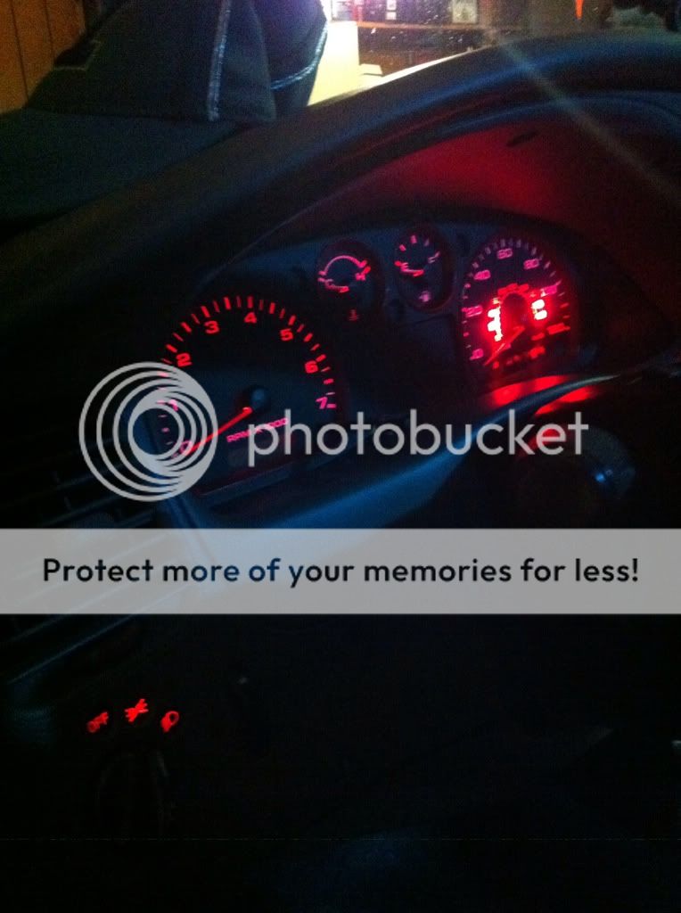

@LoneWolf are you aware you were turning 7k rpm? or did your needles not line up right?
