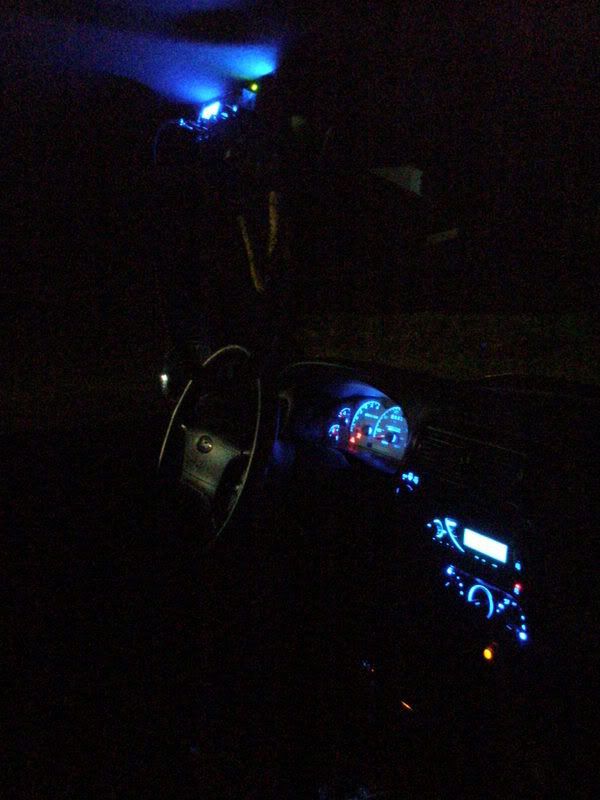

i bought the WLEDx4 which is the one that shines brighter in your pictures everything is blue on my cluster including the needles but the lights are so bright i have a couple hot spots (which i dont mind i think they look cool kind of like camo)

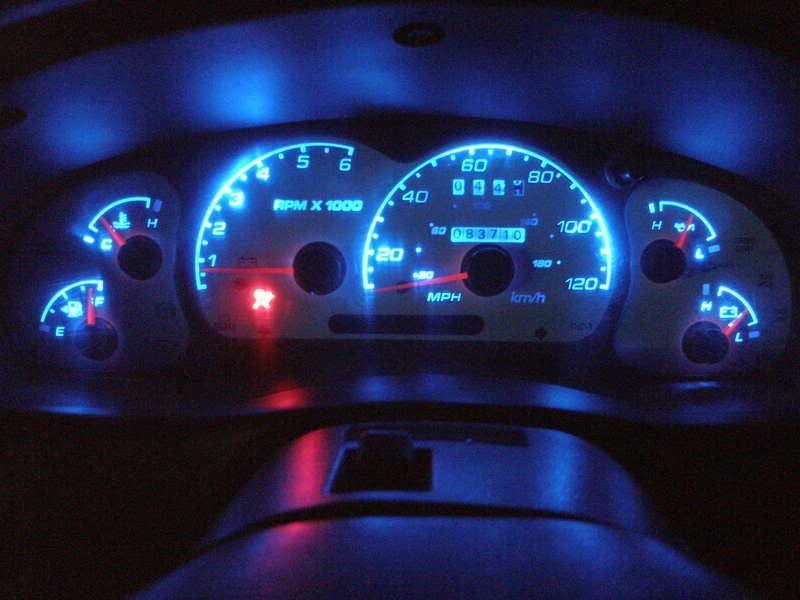

SCREW IT! here's mine....
Cluster has 36 5mm 13000mcd LEDs. HVAC has 9 5mm 13000mcd LEDs. Fog, headlamp, and 4x4 switches each have 1 5mm 13000mcd LEDs. Cruise pods each have 2 5mm 13000mcd LED's.
Hot spots are not that bad in real life, pics make it worse than it really is. I have NO PROBLEMS seeing my needles in my Expo cluster.

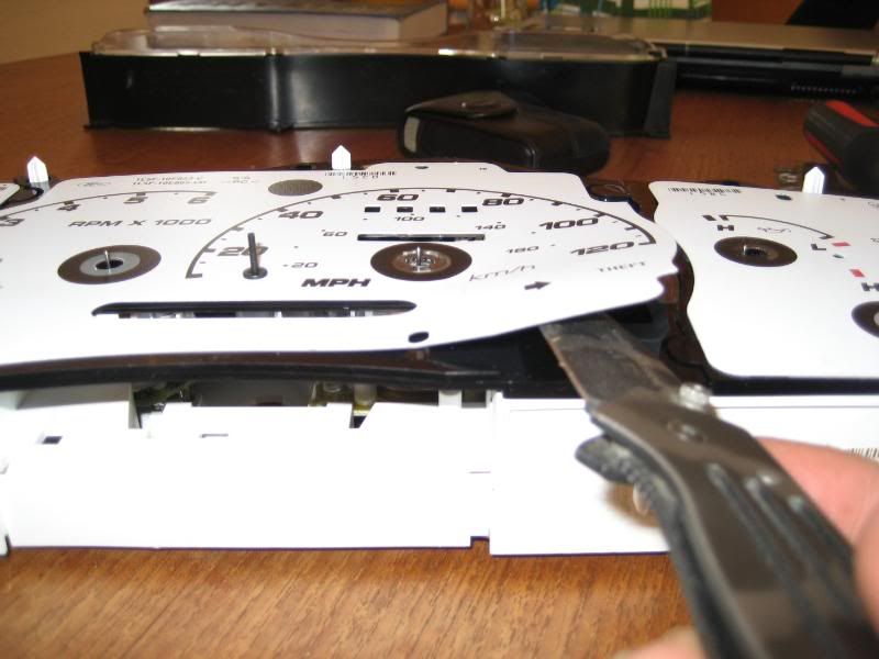

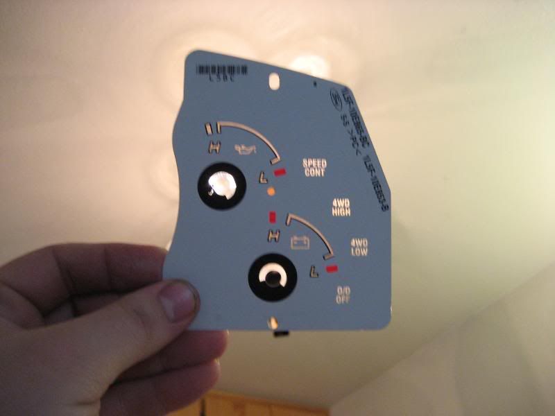

You need to take apart your cluster, pull the needles, pull the 'overlays' off, wetsand the green away, then put it back together, or paint on some glass paint to manipulate the colors through.

you should consider getting a film from a craft store to put on the back of your new clear openings.... then you just need to super glue around the edges and you're good... and if you ever want to change the color it's real easy.
