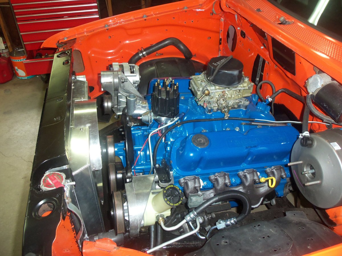

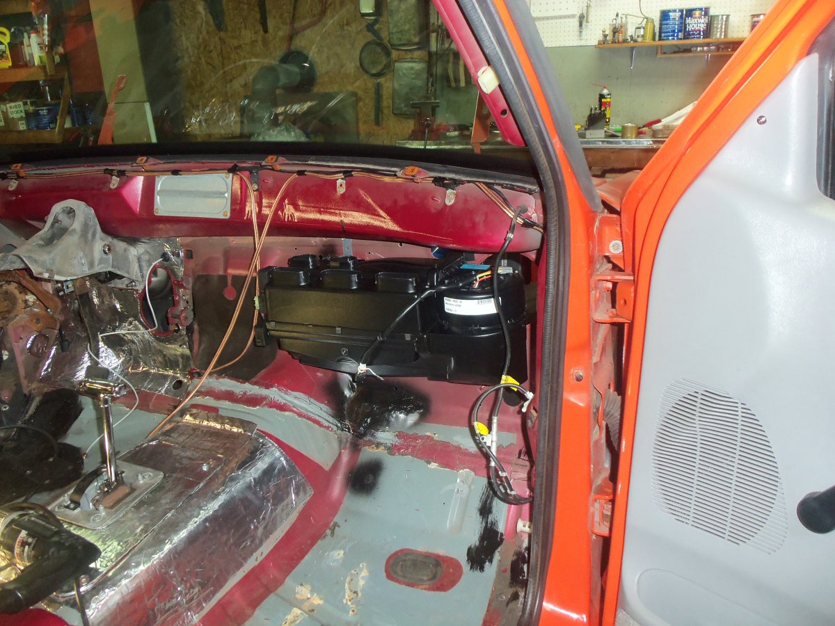

I used a Vintage Air heat, a/c, defrost system on my 93 because it had no heater box at all. It cools and heats OK but the defroster isn't great because it uses only recirculated air. If you have a factory heater box, I'd get one of their kits with the evaporator that hangs under the dash like a 60's Mustang. That way you'll still have an effective defroster and the installation will be easier. I used fox Mustang front drive brackets and pulleys with the Ford Performance 351 front bracket but I found out afterwards that Vintage has a decent looking compressor bracket, too.

I used a Vintage Air heat, a/c, defrost system on my 93 because it had no heater box at all. It cools and heats OK but the defroster isn't great because it uses only recirculated air. If you have a factory heater box, I'd get one of their kits with the evaporator that hangs under the dash like a 60's Mustang. That way you'll still have an effective defroster and the installation will be easier. I used fox Mustang front drive brackets and pulleys with the Ford Performance 351 front bracket but I found out afterwards that Vintage has a decent looking compressor bracket, too.View attachment 78229View attachment 78230
What did u use for a fan and radiator?And did u make that shroud for it?
I used a belt driven 15" Derale flex fan, a Griffin universal radiator that I mounted inside the core support after I cut it for clearance. I built the shroud from a Summit Racing kit. Idling in traffic with the a/c on at 90 degrees, the temp gauge will go up about to the middle.
