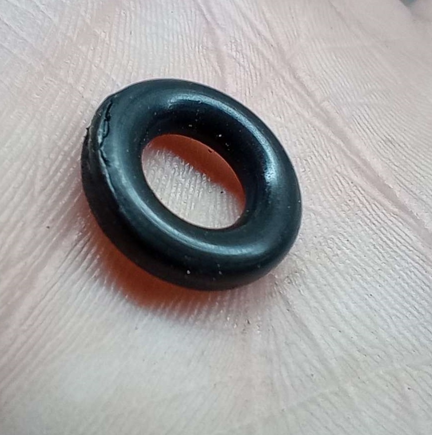

I'm coming to the TRS in a time of desperation. I have tried probably five times now to seal my fuel pressure regulator to the fuel rail with no luck.
This is a 1994 motor. I didn't replace the regulator during the rebuild and it naturally had a rust failure 5,000 miles later. With the motor now in the car and the magic let out, I cannot insert the new regulator without cutting the o-ring. I have tried excessive amounts of grease (no molly compounds in it for clogging reasons) and even cleared any corrosion on the taper with some Scotchbrite. I'm running out of spare o-rings! 🙃
My question to you all is; how do you do it? I'm getting so sick of smelling raw fuel all the time. I really don't want to take the engine out or undo the intake...

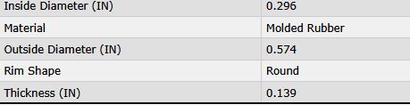

You might be right,
Here are the injector O-ring measurements
I can't find anything on the size you need
Seems to me like there has to be some sort of edge somewhere that you’re catching with the O-ring. I’d really go at trying to make sure the taper and seat area for the O-ring is as smooth as possible. Smooth is important, an O-ring by nature will seal against minor imperfections as long as it doesn’t get snagged and torn.
Unless the O-rings for the FPR are different than injector rings and they’re just way wrong in size… but that still looks like you might be snagging a burr somewhere…
