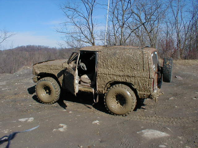

I don't like mud. But #1 is tires. My B2 has a 3" (probably 2.5") lift and the fenders are massively chopped, and both axles are locked. With 35" Ground Hawgs I could not get it stuck-and I was driving around the line of trucks through stuff...I shiver to think of it. This was during the 2006 Snowball at Wellsville.
