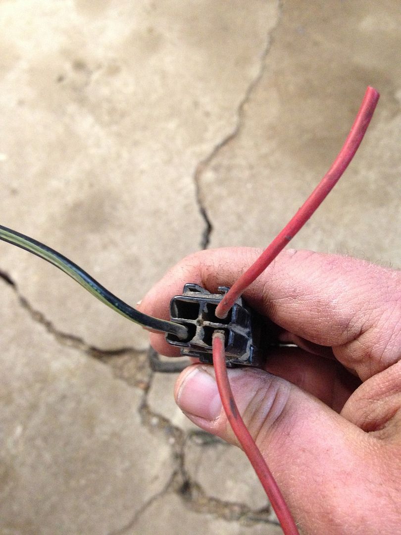

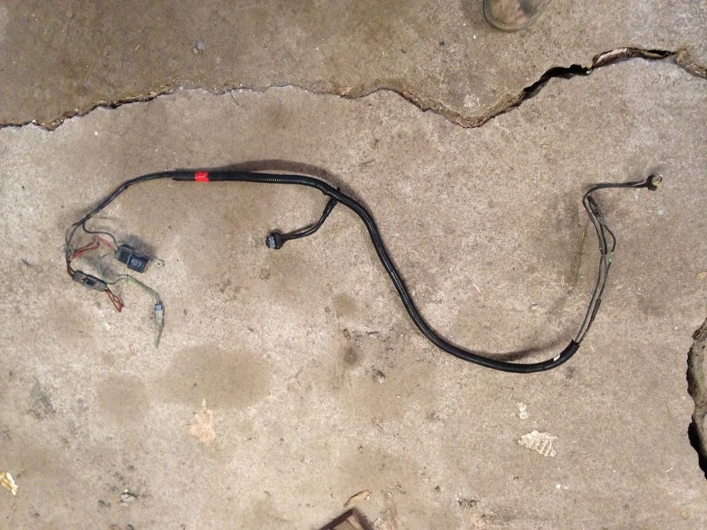

Anyone have the wiring diagram of the A/C harness for a first gen?
I find the wire from the ECU to the WOT relay but nothing that details what the other wires are or even which one is the one that goes to the ECU. I suspect the green one goes to the switch on the dash but beyond that I don't have anything to go by.
I know where the compressor and low pressure switch plug in though. Mainly with the two connectors at the left (with the cut pigtails)

I am looking at the diagrams for mine, and I see what is indicated as a purple wire (circuit #462) that goes from one side of the WOT relay coil to the ECU (pin #54) for controlling the relay. The other side of the relay coil goes to the switched power feed from the EEC power relay (red, #361).
The contact side of the WOT relay cuts into the power feed to the A/C clutch coil: Power comes from the dash on/off switch (lgt green/purple wire #348) to the LP cycling switch, after the cycling switch the wire is tan/yellow (#198) and goes to the contact of the WOT relay, then from the other WOT relay contact the wire is black/yellow (#347) and goes to the clutch coil (other side of clutch coil goes to ground, black #57).
The tan/yellow circuit (#198) also is connected to ECU (pin #10) to indicate to it the A/C has been switched on.
This is for both my '90 & '94, so I can't say whether that matches up with what you're working on... (looks like ECU pins #10 & 54 have different color wires on the diagram you posted than what I mentioned)
Hope that helps a little...
It is out of a 86-88 BII.
