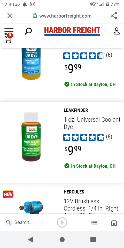

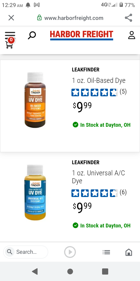

I wonder if they sell UV dye at Home Depot.?
Harbor freight's website says they sell three different kinds of UV dye for $9.99 each.

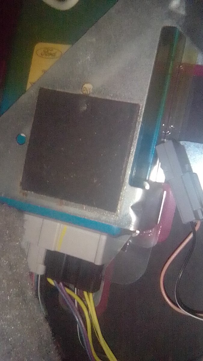

When told him I was looking for the ignition control module he then pointed out a blue electronic box that's mounted to inside of the cab on the front passenger side behind the paneling underneath the dash on the sidewall of cab.
And he asked me if that was what I was talking about. I told him I don't know what that box is but I would try to find out before I talked to him again.
I don't know what this box is I asked him if I could take some pictures and he said he didn't have a lot of time today that I could take pictures another day.
After he pointed out the little electronic box inside the cab I asked him if I could just take one picture of that little box and he said okay but I'm out of time I got to go.
So here's the one picture I was able to take today. I had to take the picture leaning inside the past your side door jamb. The truck was parked in a real narrow driveway in the passenger side was only like a foot and a half away from the house.
I found out when I opened the driver's side door to try to take the picture from that side there was a wasp nest in the door jamb so then I had to fight wasps.
Needless to say I shut the driver side door pretty quick.
I know it's not a very good picture but I figured a picture is better than no picture.
You can see where the wire connector plugs in on the left side of the picture is the truck's floor carpet.
As Andy and I was leaving the house the guy told me that he thinks the other truck (94) also has 1 of those little electronic boxes.
So can anyone please, please, tell me what that little electronic box in the picture is?
