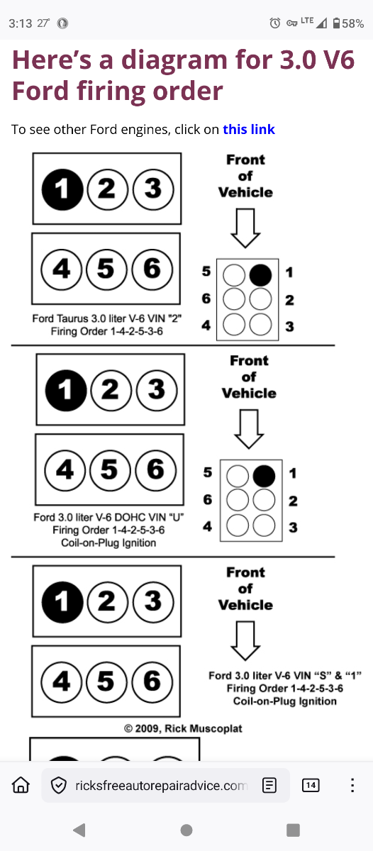

Remind me, what engine and where on the engine is it? Like 2nd cylinder back from front passenger side?
Okay @alwaysFlOoReD .
It's the 4.0 passenger side which I think is cylinders 1,2 &3 as well.
So it appears to be coming out of the exhaust manifold bolt hole on top for cylinder 2. The middle top exhaust manifold bolt hole on a passenger side.
