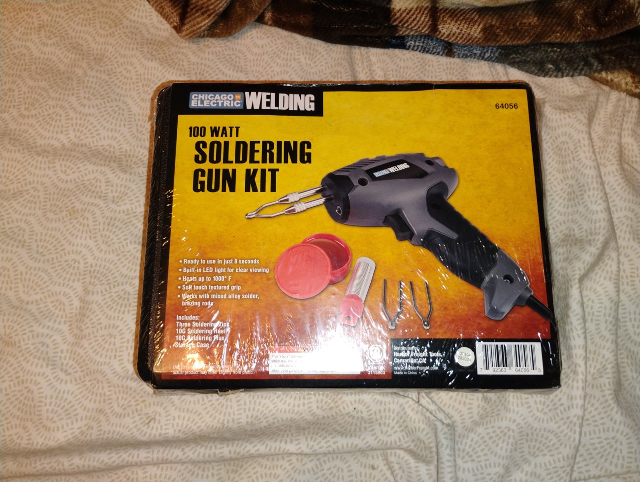

If that's 30watt soldering iron has trouble heating the metal for you, you might need to get a soldering gun like the one below. It gets to roughly the same temperature. But it has more energy (higher wattage) to transfer heat to the workplaces.
It's like trying to boil a pot of water with a cigarette lighter compared to boiling a pot of water with a butane camp stove. Both flames are the same temperature. But the stove is burning more fuel, so it gets the water boiling a lot faster. The cigarette lighter might not be able to deliver enough energybto get a big pot of water boiling. A soldering iron that is too weak will take longer to heat the workpieces, if it ever does. You bought it. So go ahead and see if it works.
I see nothing below your post Curious.
100 watts.
Looks nice. I like the price as well.
I didn't see that one at my Harbor Freight.
I just looked on their website. I see it there.
I didn't see it in the store. I think I might go back tomorrow and ask someone that works there.

I followed my TRS brother " Curious's " advice.
Took the soldering iron I bought yesterday back.
And bought this one
Thanks for the advice Curious.
Thanks to everyone else for all the help I've gotten.
