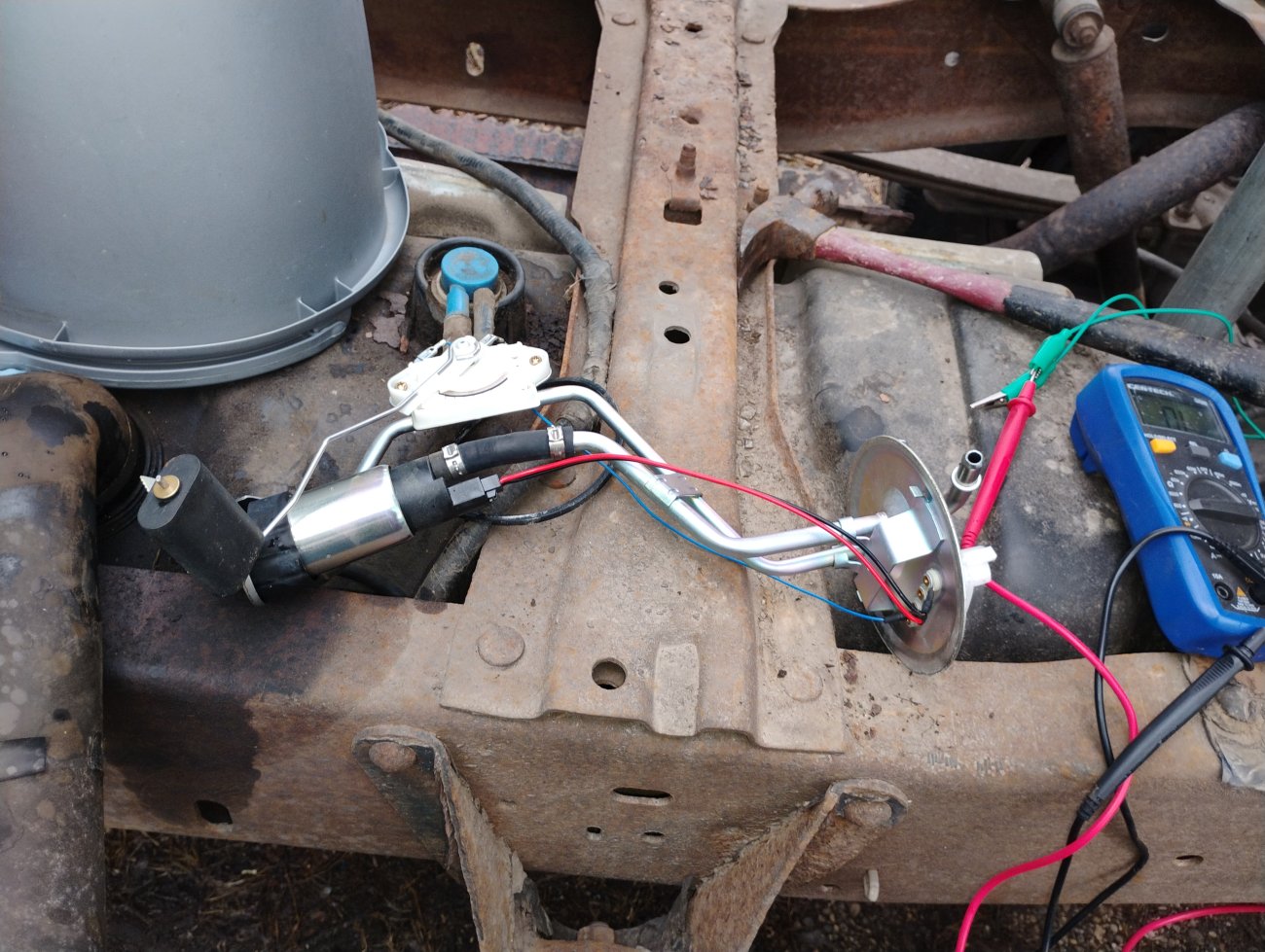

Okay folks I went ahead and took my truck's fuel pump assembly out to at least take a look at it.
Like most of you guys recommended.
Picture 1 fuel pump assembly laying on first side.
In this picture, picture 1 you can see the float arm and sender are up.
Picture 2 fuel pump assembly laying on its other side.
In this picture, picture 2 you can see the fuel pump better along with everything else.

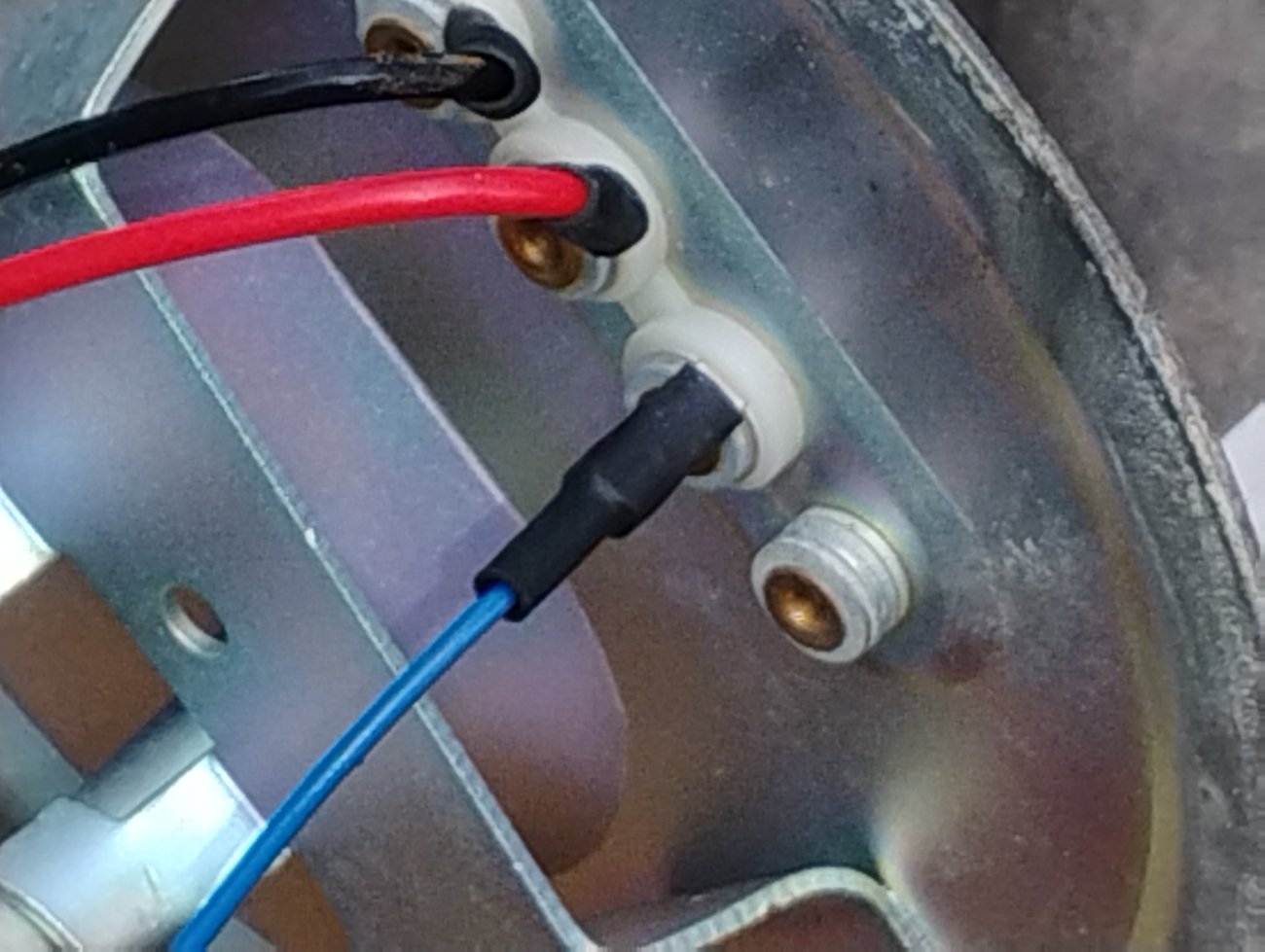

Picture 4
In this picture, picture 4 you can see the underside i.e. the side that's in the tank of plug pens/pegs/posts for the plug.
The black one is the ground for the fuel pump.
The red one is the power for the fuel pump.
The blue one is the sender, send out wire. I.E. the wire that on the other side of the plug becomes wire 29.
As you can see there is no wire on the last spot.
What I'm thinking is the factory believed that when they soldered the ground wire for the sender to the plate that it's attached to the ground would run from the plate to the pipe or tube that goes up to the top of the fuel pump assembly and then on to or into the cap ring or whatever it's called at the top of the fuel pump assembly and therefore run to the plug pen, peg, post.
I hooked my multimeter to the actual contact points of the fuel sender and it does work I gots readings big time.
I believe all I need to do is solder a wire from the underside of the ground pen, peg, post whatever it called to the ground plug on the sender itself.

Very sure that's not a factory/OEM sender, it's been replaced with aftermarket before you got it.
If it was factory, the rubber hose would have the Ford oval on it, and Ford didn't use that style external clip.... they did go similar from 98 on but not that style.
That said, you can fix the aftermarket and get more mileage out of it.
All three of those through hole/bulkhead connections look to be running through a white nylon insulator - so the ground is insulated... I can't see how that ever worked day 1.
The blue wire doesn't run to the rheostat, it runs to the casing... I would guess that someone mis-assembled it at the spectre factory. And that blue wire should go to the wiper side of the rheostat, the black should span the other 2 leftover plugs (providing ground to the other end of the wiper/windings).
If you can figure out what brand it is we could google up a picture and see if the wiring is visible enough to corroborate. Or run to whatever brick and mortar store carries one, ask to look at it for a minute and take note of how it is wired.
